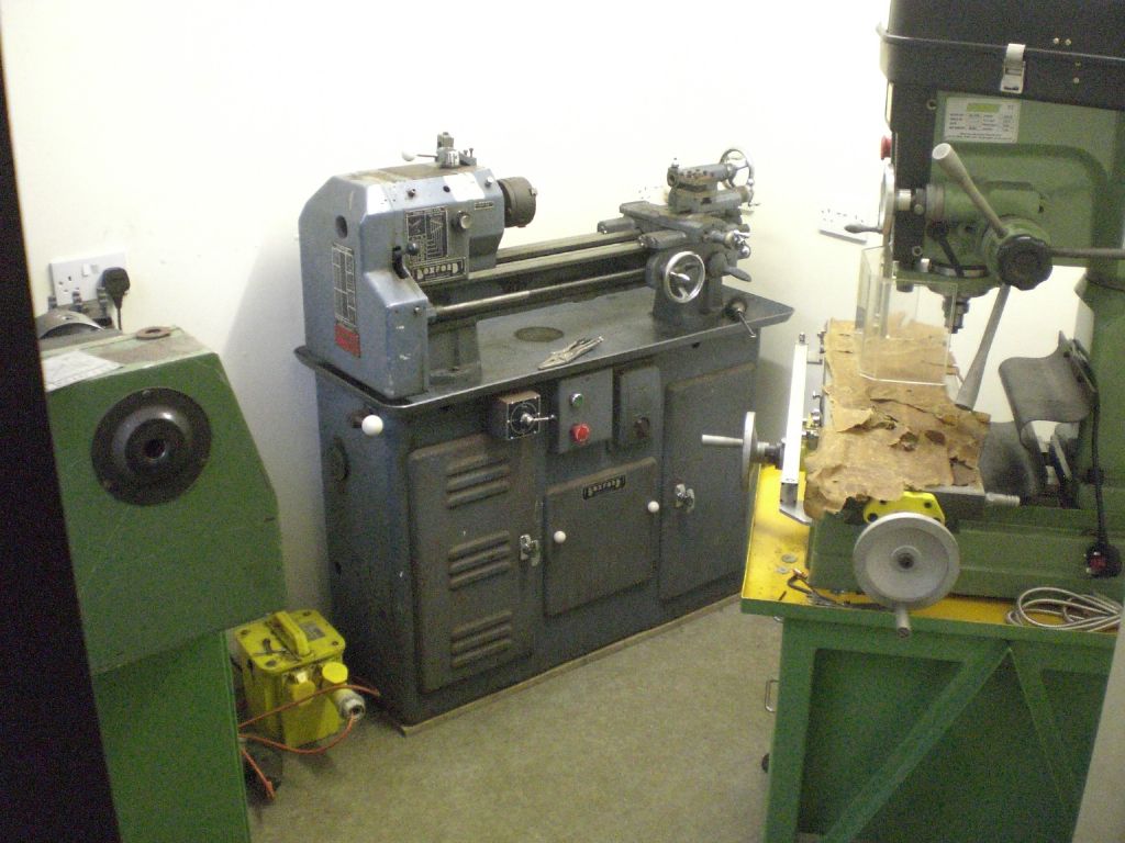

                                    Andy, A picture of my shop below just to give some idea. I have a 15 inch deep bench to the right where the mill sits, a 24 inch bench to the left plus a 24 inch bench at the far end with the lathe. If you went with something similar having a 15 inch and 20 inch deep bench you would have a working space between of 27 inches, cosy but quite workable. Or you could go with 2 x 17-18 inch benches, if you go with a mini lathe a 12 inch bench will house it as I had mine on that size of bench when I started. Depends on what machines and bench size you need lots of options.

                                                Hi Andy, that's not to bad of a small space to make a start, with carful planning it's surprising what you can fit in, it is storage space that may be the problem. Below is a photo off part of my garage and is about 2 X 2 and contains my Warco 220, my Boxford and my Warco Major milling machine and it has enough room to work on any machine without being cramped, but there is only storage for tools for each machine.
                                                Regards Nick.
