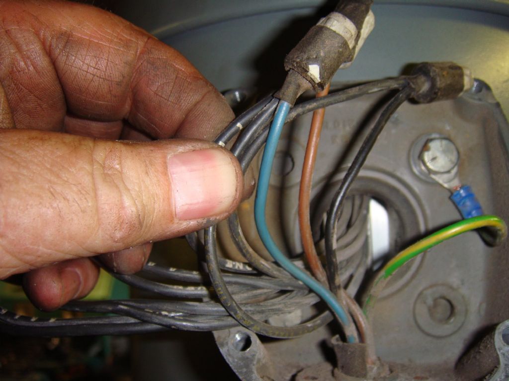

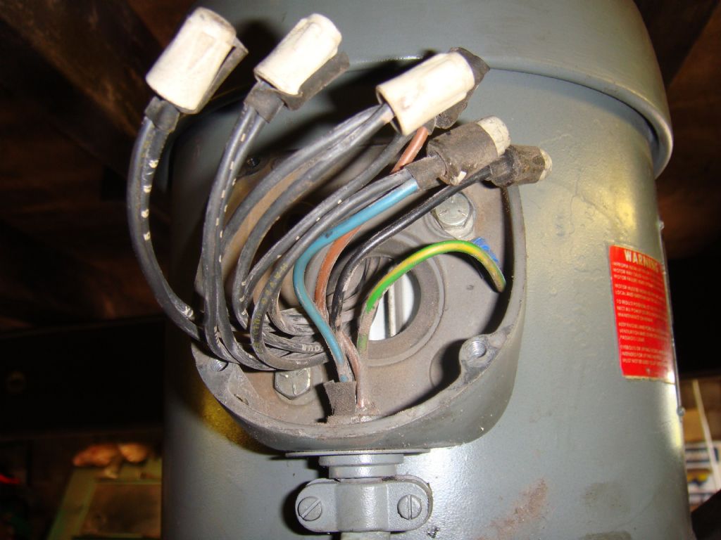

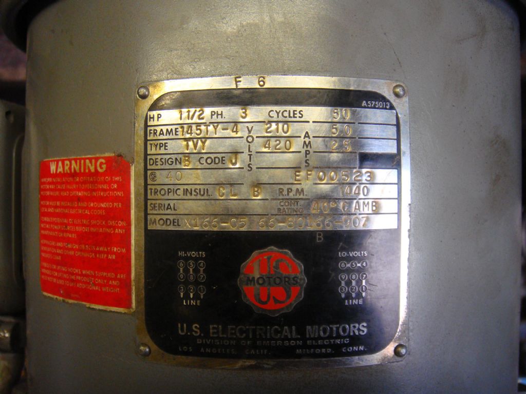

                First off you mention a two speed motor but is it ?
                They did do a two speed motor as well as the single speed. Where the confusion arises is the single speed motor has a three position switch marked l – 0 – ll and everyone assumes the l and ll are two speed when in fact it is forward and reverse.
                The Bridgy needs reverse on the switch because when the backgear is engaged the drive is revered.
                A true two speed motor has a 5 position switch marked l – ll -0 – ll – 1 or For L – H – 0 Rev L – H
                or other variations of the same layout depending on where they bought the knobs that week.
                The two speed needs a phase converter to run correctly or one of those bodged up inverters that take 240v in and put 440v out.
                The single speed motor which is a stupid Yankee 9 wire motor can be rewired in the terminal box to mimic one of the normal 6 wire dual voltage ones that can run off a 240v single phase in and 240v three phase out.
                The table motor can be run off single phase with a capacitor across the dead leg, it will be down on power a bit but these hardly take any power anyway.

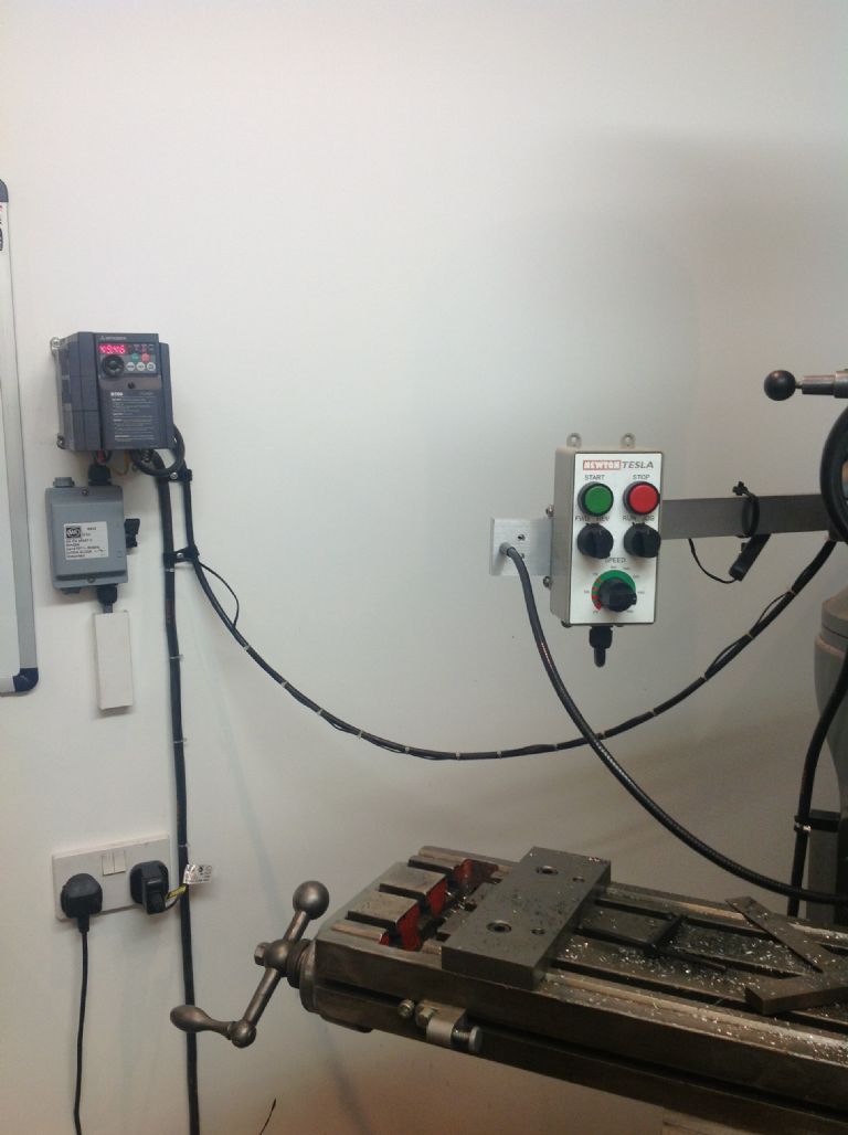

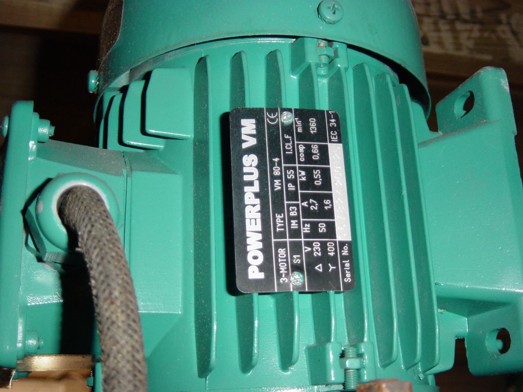

                      I have converted my Bridgeport to single phase, mine didn't have either a suds pump or an original table drive motor to worry about and my route to single phase was guided at the time with help and advice from John Stevenson over on Usenet at the time.
                      Step one for me was to rip everything relating to the original 3 phase setup off the mill (apart from the motor of course) I couldn't see any need to keep it..I have kept it all chucked in a dark corner of the workshop but I don't see that I'll ever need it again.

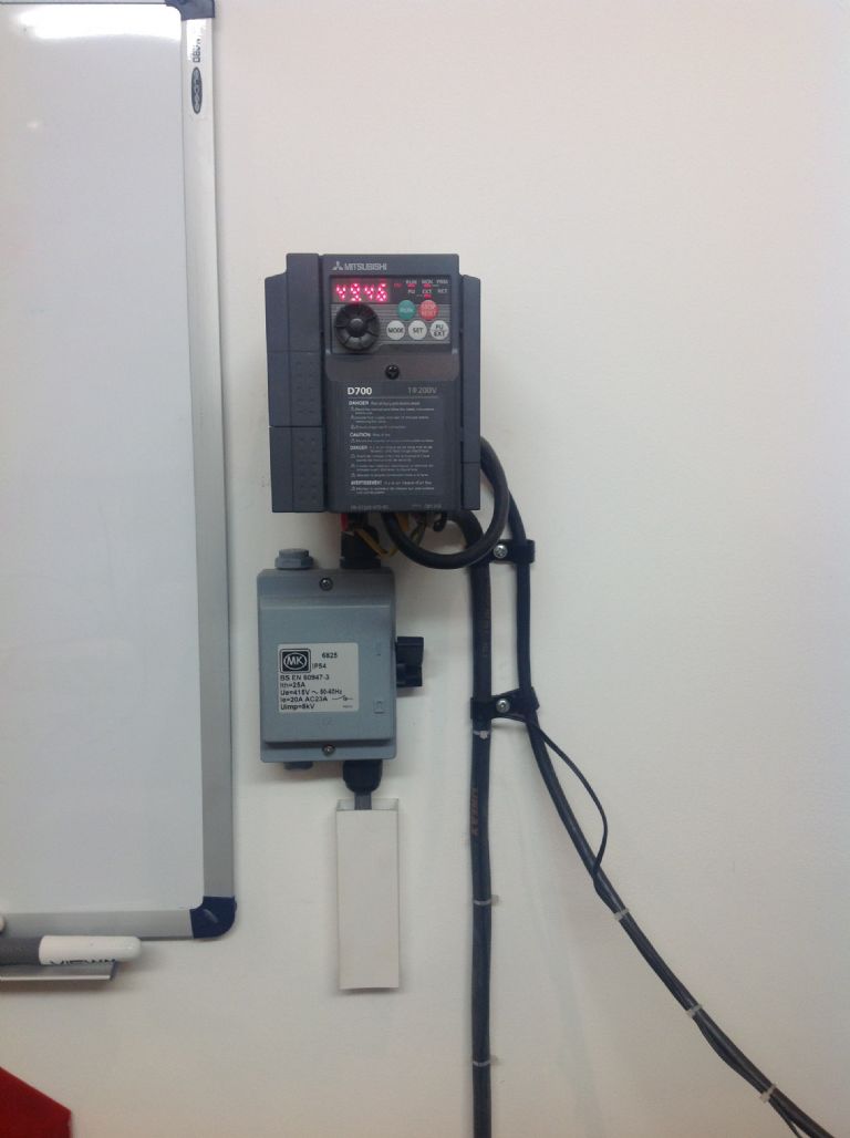

                      I bought my inverter/control station from Newton Tesla who I had used before when I converted my lathe (which was single phase but I wanted the speed control etc so went down the 3 phase motor avenue) anyway the inverter came from them pre-programed with the control station pre-wired, all I had to do was follow the diagram supplied to connect it to the inverter, simple enough after studying it for a day or so…..
                      I found NT very helpfull both times I have used them, I think I could have probably bought the inverter a bit cheaper, but I like their control station and it was really a turn-key package, with added back-up if needed, that has a value to me!
                      All I had to do was change the motor wiring to Lo-Volts as shown on the motor plate, all the wires are numbered so it was simple enough to follow through.
                      After that all I had was the supply from the inverter to bring in, again simple enough and ain't a sparkie!
                      It all worked first time and I havent had to touch the wiring etc from day one.
                      It gives great control, on the jog setting I can tap under power without having to go move into back-gear, the inverter gives 5hz (I think) in jog mode and with the mills speed wound down to the minimum 450rpm it's easily done and I haven't bust a tap so far!
                      I haven't had the need to mess with the programming of the inverter, the settings from Tesla seem fine and after 3 years use I haven't felt the need to alter anything.
                      I have the 110 volt "accessory" type drives on X-Y-Z axis they are powered from a single transformer bought from Screwfix, that's the only part of the setup that I have had problems with, when I switch on on it trips the breaker sometimes, seems that my RCD's in the workshop are not ideal for the "inrush" of the transformer, no big deal just a little irritating.
                      Hope this helps.
                      Richie

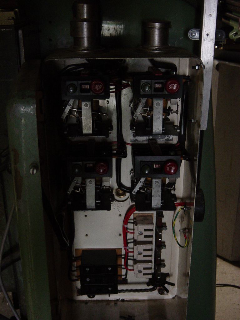

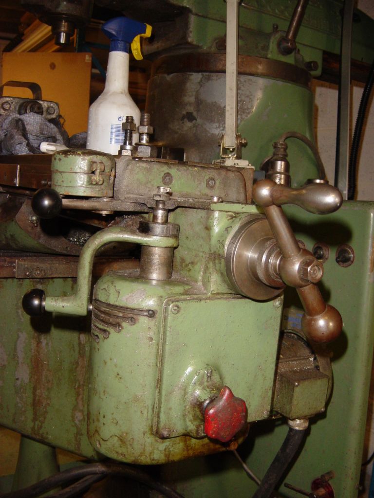

                          Hi,
                          I have now got the Bridgeport in my workshop after a 7 hour marathon getting it from the gravel drive into the workshop. The motor is only a 0.75HP as can be seen here and can be wired in star as well as delta.
                          Unfortunately in anticipation I purchased a 2HP inverter running at 415V after some misinformation from another source (not here).
                          What I want to do now is buy two smaller inverters at 230V and run the head with one and the cross feed with the other. At current prices I should be able to do this for less than the cost of the inverter I have already bought. I just need to trade the other one in.sad
                          Here is a pic of the cross feed (which I have seen working). A bit of the casting has been broken off but that is now JB welded back in place.
                          Inside the control panel are all the old contactors
                          The plan is to rip all this out and fit the inverters in there. What I do know is that the inverters need to be wired directly to the motors i.e. no switches or anything in between. I was therefore planning to run the On/Off/Reverse switch into the input of the inverter because there is an input for this. The one bit I am not so sure about is an emergency switch on the front which I guess is there to kill the supply power to the machine as a whole. I opened the front of it and it appears to be just microswitches wired back to a contactor in the control box. I am assuming I need to break the 230V supply power and will need to buy another contactor for that rated at 230V.
                          Would appreciate if you guys think my thinking is the right approach.
                          Thanks.
