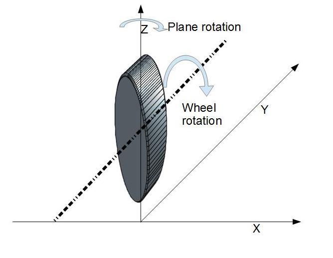

      This is what I mean.
      The plane is XY (which could be the earth's surface near to the pole). The vertical axis is Z, and the plane rotates around Z. The wheel axis in this case is horizontal and parallel to the Y axis. The wheel rotates around this. The vertical axis through the wheel's CG is actually the Z axis, but the wheel is not rotating around it.
