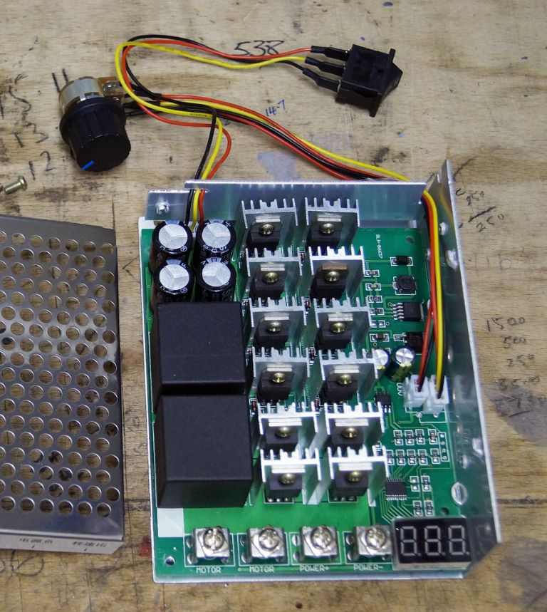

                    From the photo this appears to be a basic PWM controller probably a sawtooth oscillator, variable voltage (from pot)and comparator. While two could be modified to run from one pot I don't think a simple parallel connection is advised.
                    There are two reversing relays and depending how they are wired they probably provide dynamic braking (also using the MOSFET source drain diode and battery) when the control switch is off. A separate double pole "off" switch or a pair of microswitches operated by a cam on the throttle control would be easier than trying to find a dual gang, 100K linear pot with a double pole switch. I found a 50K, which might be OK but it's a single pole switch so needs investigation or a relay and it looks pretty poor quality.

                                        I have found a 100 amp (60 continuous) controller and at £25 sent off for one, its one of the Chinese ones, a larger version of the one I use on the 0-4-0 and so far that has proved to be very reliable and excellent value for money. How this larger version will perform remains to be seen but fingers crossed it will be similar to the smaller version. It is obviously simpler to run one controller but good to know I can run twin controllers should I need to.
                                        A picture below of the controller internals but as I mentioned previously electronics is lost on me.
                                        Edited By Ron Laden on 29/08/2019 10:28:38
                                        #426510
                                          That looks jolly good value, Ron yes
                                          I would just recommend adding some grommets and strain relief to those wires though.
