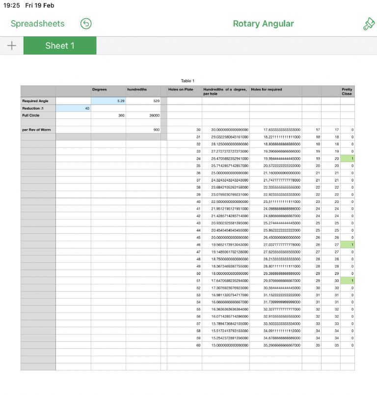

                  Posted by SillyOldDuffer on 16/02/2021 13:59:06:
                  Not everyone is good at maths, which I think can be demonstrated by this relevant question: Assuming a Rotary Table has a 40:1 worm and an indexing plate with hole circles from 30 to 60, each circle in steps of one, thus:
                  Q1. Using this plate, what indexing ratio is needed to rotate the rotary table by 5.29°? (There are two candidates.)
                  Q2. What's the error, in degrees, of both indexing ratios?
                  Show working! If you happen to have a lookup table for a 40:1 ratio, please don't cheat by using it. The test is doing the maths.
                  Please, Sir … will this do ?
                  [ sorry, I didn’t bother completing Q2 ]

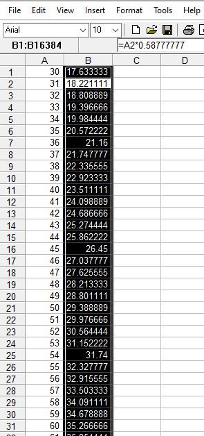

                  The gist of the working is to first multiply by 100, so that we’re working with an integer target.
                  Then find how many hundredths of a degree each hole represents on each circle.
                  Then find how many holes are required for 529 hundredths.
                  Quick & Dirty spreadsheet looks like this:
                  Row 10 looks pretty good to me …
                  and I’ve sanity-checked the formulae by substituting some easier angles in B2
                  Edited to correct a typo, and to mention that if anyone needs more detail, just ask.
                  Edited By Michael Gilligan on 17/02/2021 22:24:35

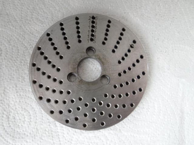

                      Is it just me (as in Me) – why when you look at this picture the line a 12 o'clock is straight up and down but when you turn the picture through 45 degrees the new 12 o'clock line is not…..
                      Have I discovered a floor in the dividing disc design or is it just an Illusion……. Spooky….
                      And also – why the line at the 6 o'clock position has half the amount of holes when you look at the picture as posted – Anyone have Pythagoras's phone number I think hes missed a trick with this.
                      #528222
                      Me.
                        @me1
                        PS – I do know why but when someone that doesn't know what the picture is of, then it does confuse very quickly.

                          Illusion, or at least the brain detecting patterns other than the one intended. Here's a real Index-plate showing similar effects:
                          It's because the number of holes in each circle increases by one, so they stagger around the plate, aligning in various ways. This plate gives index holes stepping at:

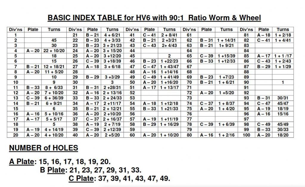

                          Index plates are used with a plunger and clock-hand indicator and are set up from a table like this:
                          PDF Version Here.
                          Indexers provide a relatively easy way of keeping count when a dividing head or rotary table is turned repeatedly through an angle. The HV6's Basic Indexing Table covers the common case, which is when a circle is divided into an equal number of angles, say to drill holes on a PCD, putting flats on a work piece, or making gears.
                          For example, to drill 7 holes in a PCD, angle approx 51.43°, fit Index Plate 'B', select hole ring 21, do 12 full turns of the handle, ie 48°, then move 18 holes along the 21 hole ring to add 3.43°, total 51.43°. The clock-hands are set to indicate 18 hole movements so the operator doesn't have to keep count of them, and can be moved indicate the next target. The operator has to count 12, and woe if he miscounts 11 or 13, or selects the wrong index hole. A microcontroller is much easier to drive.
                          Another point, the 'Basic Index Table for HV6' is just that, basic! It doesn't help when the angle needed isn't one of the listed divisions, as is the case with my 5.29° question. The table's shortcoming may not be a problem if you can do the maths and identify a reasonable approximation.

                                      Dave, Jason has been too busy painting his Heinrici engine and drawing up a Stuart Victoria to give in his homework but Michael seems to have half answered.
                                      The 34 hole ring looks the best bet with 20 holes giving 5.2941168deg so the error is 0.0041168deg
                                      next best would be 58 ring using 34 holes to give 5.2758612deg so error is 0.0141387
                                      Having said that Dave's original question said using a Rotary table with 40:1 worm. Now this may have been a typo as it's usually Dividing heads that have 40:1 so I'd opt for sticking his plate onto my 90:1 rotary table and using the 41 31 hole plate with 1 full turn and 10 holes get 5.2903deg which is good enough for me. cheeky
                                      Edited By JasonB on 18/02/2021 19:49:32
                                      #528370
                                        Just to add that my logic was a bit different to Michael's.
                                        First work out how many degrees 1 full turn gives, in Dave's case 360/40 = 9deg per turn.
                                        Divide 9 by desired angle of 5.29 = 0.58777777
                                        Then quick spread sheet to multiply each number of holes in the ring by 0.587777 and pick the nearest to a whole number
                                        #528419

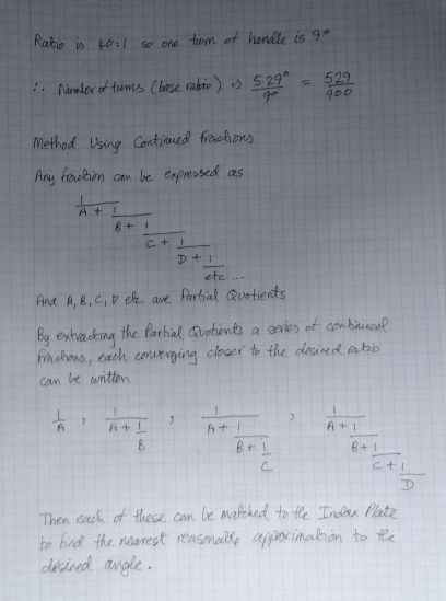

                                            Time for the answer!
                                            Only two entries from the entire forum, and both disqualified for using technology not available when Dividing Heads, Rotary Tables, and Index Plates were first invented.
                                            Honourable discharges though because I approve of their method because it's practical and less hard work than doing it manually. However, before computers brute force techniques like this were too much work. Michael calculates sixty floating point numbers each with 18 digit precision, no joke with paper and pencil. Even today, with the answers neatly printed, the requirement to search a longish list for the closest match to an integer is irksome, but hey ho, not a showstopper and it could be fixed. I like it.

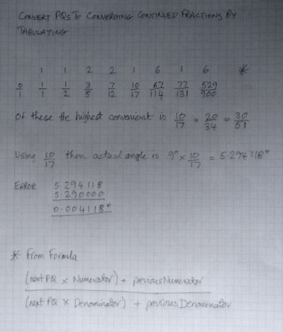

                                            Here's a traditional method, in which brains are substituted for brawn. The method involves defining a fraction in such a way that an ever more accurate approximation of the target is found at each step. It's the technique used to identify 22/7, 355/113 and other ratios as approximations of pi.
                                            Extracting the partial quotients: sorry, rotating the photo chopped off the first step which is:
                                            900/529 = 1 remainder 371
                                            Then, with 1,1,2,2,1,6,1,6
                                            We find the closest approximation is 10/17, which is 20 on the 34 hole ring or 30 on the 51 hole ring, for an error of about 0.004 degrees.
                                            Might be possible to do better. The method can be extended using Combined Fractions to generate additional approximations between those calculated as shown above. More accurate than the lower bound, but not as close as the upper.
                                            Apologies for the poor photos and fingers crossed I've got the sums right. (Maths isn't my strong point.)
                                            #528535

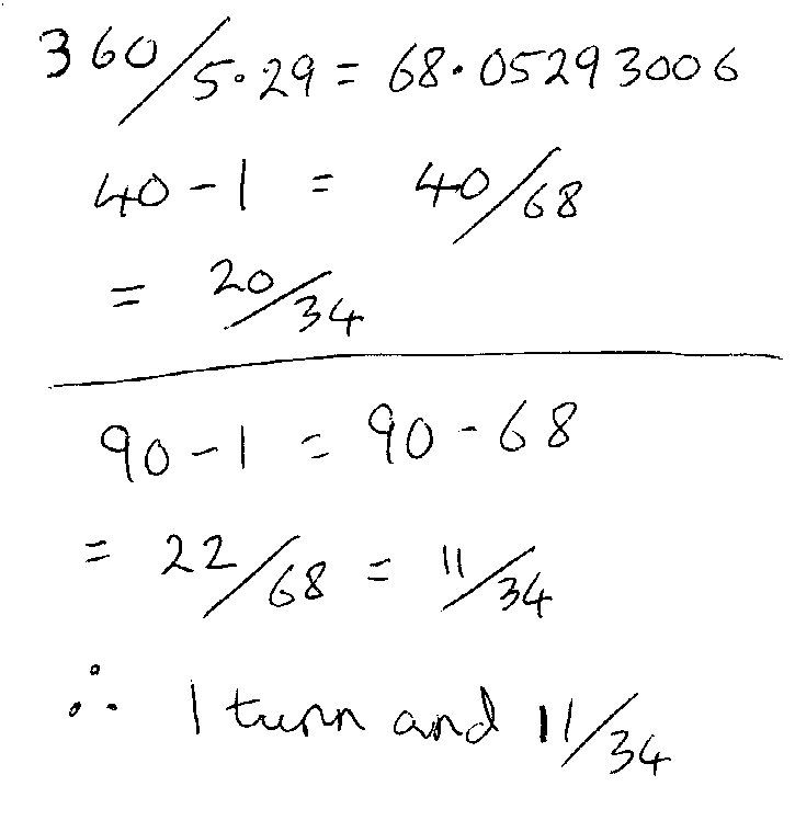

                                                  Hi, well I worked it out a different way, but was not sure if it was correct, the first thing I did was to divide 360 by 5.29 and I ignored everything after the point as I wasn't interested in knowing the error, but the figures suggested it was small. I calculated both 40-1 and 90-1 R/T's. My calculations were very short, but I did use a electronic calculator, well two actually.
                                                  Regards Nick.

                                                    Following Dave’s critique, I have improved my spreadsheet a little:
                                                    The reduction ratio can now be input, and the close approximations are identified
                                                    … the method used for this is a little clunky, but it works.
                                                    It’s still set-up for up to two decimal places on the required angle,
                                                    still displays the calculations to an unnecessary 16 decimal places,
                                                    and uses Dave’s series of holes …but obviously this could be revised to match an existing set of plates.
