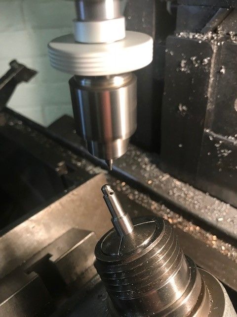

                                            However, as Mike says, there are some things for which one definitely needs a dividing head:
                                            My dividing head has a reversible index plate behind the chuck, so I also use it for simple indexing work such as squares and hexagons.

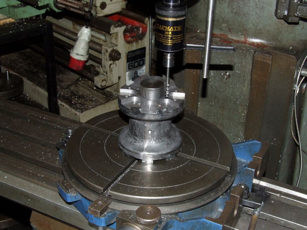

                                            Conversely a rotary table is best when radial cuts are needed:
                                            Or for large parts that will not easily fit on a dividing head:
                                            The centre hole on my rotary table is 1" diameter and parallel. In my view that's more useful that a Morse taper as it makes it dead easy to make mandrels or alignment pegs. After buying my rotary table I also bought a cheap 3-jaw chuck, but have never fitted it and never will. I simply don't need it, especially as I use the dividing head for indexing. In the past I've used the rotary table for rounding the ends of rods, but it's a right royal PITA. It takes care to set up the part on the axis of the rotary table. If an arc is needed rather than a full circle it is only too easy to go a gnats whatsit past the desired point. It might only leave a shallow witness mark, but it is surprisingly difficult to remove it. Lots of filing and an end that no longer looks semi-circular. I prefer filing buttons for rounding the ends of rods and clevises.
                                            In summary the OP needs to decide what he wants to make and can then decide which is better, rotary table or dividing head.
