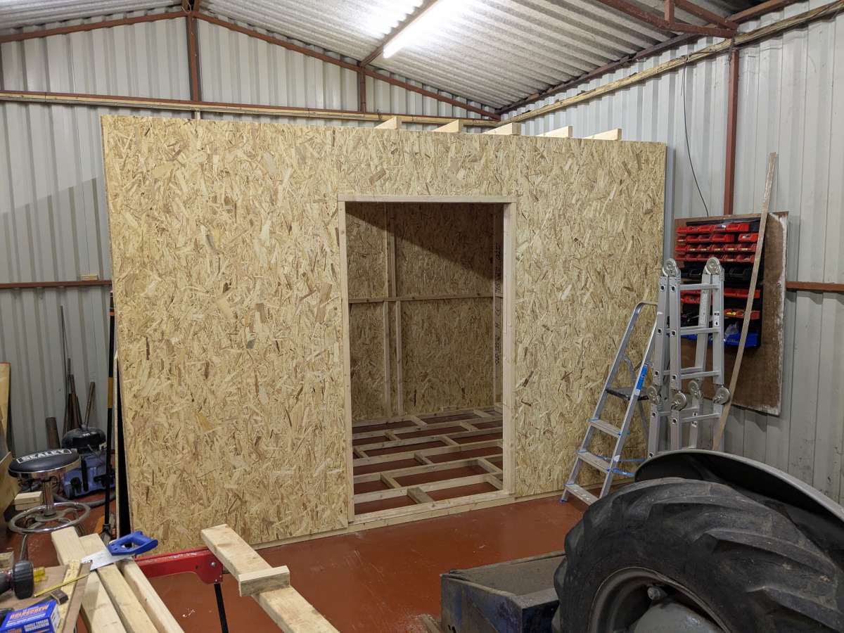

      Slow but steady progress is being made!
      PXL_20250102_211226898PXL_20250102_213958798

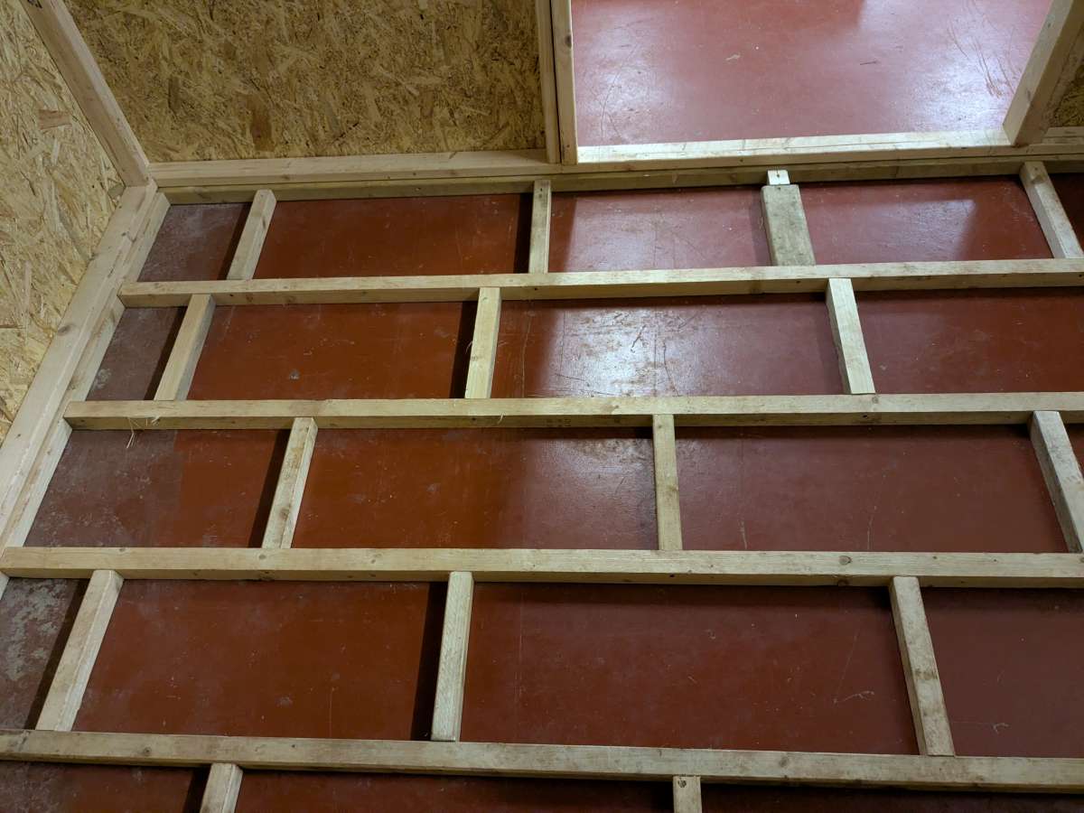

        Needs more noggins in floor, especially inline with door.

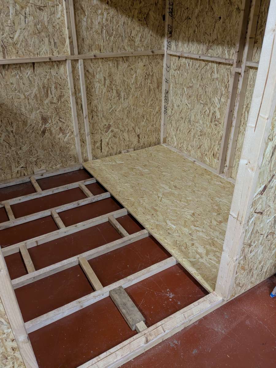

          That’s maybe a bad photo for showing the ones in line with the door frame. What spacing would you recommend?
          PXL_20250102_210649363
          #774130
          Dave Halford
            @davehalford22513
            The ones close to the wall are wasted and the edges of the joining floor boards need full support or you will feel the sag as you step on the joint
            #774190
            Bazyle
              @bazyle
              As Dave suggests plan your floorboards first for the joints. Also plan benches and machines so they are supported, even if just a small extra block in the middle of a gap. Otherwise just walk in like you would when finished and note where each footstep lands – put a noggin there. If you are using solid insulation though it will provide some support if you can line it up level with the frames.
