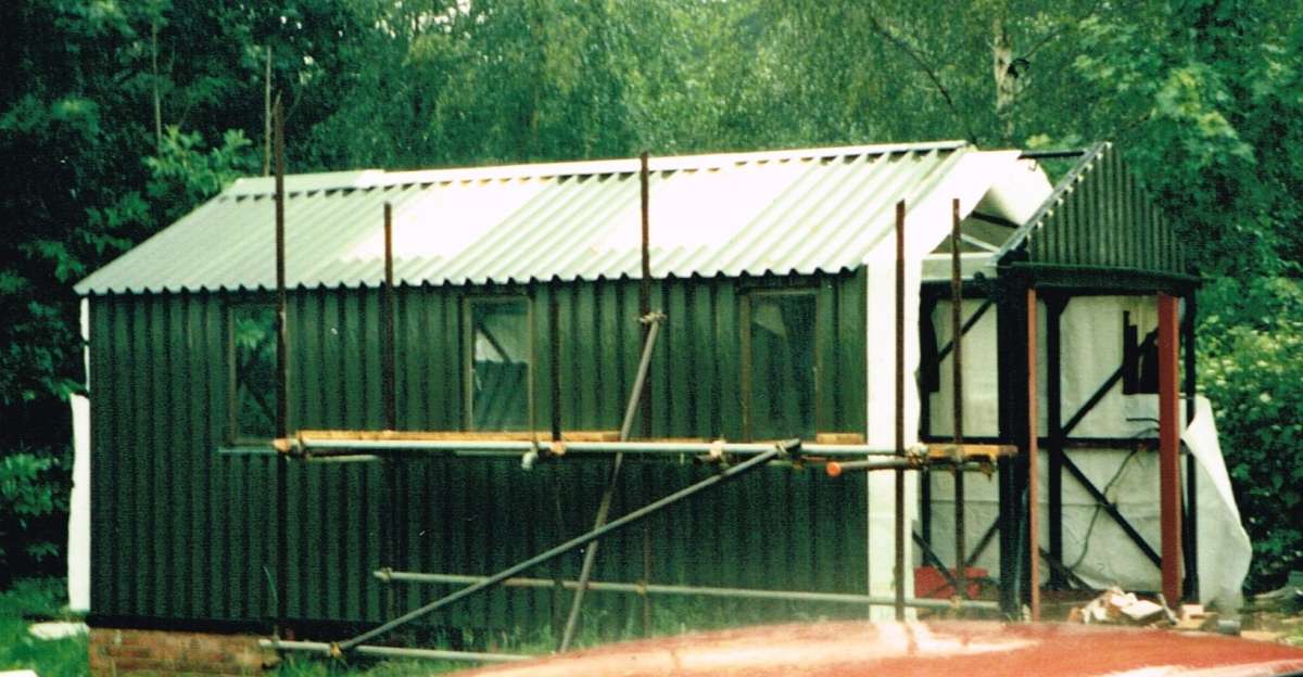

                    My shop has 50 mm square timber for framing.
                    The outer walls are 19 mm overlapped boards.
                    All walls are exposed to the weather, but the rear wall is protected by being very close to a 2 metre high boarded fence.
                    Thy inner walls are 12 mm ply. Between the inner and outer, is filled with glass fibre.
                    The roof is 12mm ply on each side of 50 mm framing, with a rubber outer membrane.
                    Being fairly small it is cosy, and the 2 Kw fan heater usually runs for less than 15 minutes before the thermostat shuts it down. After that, the heat from the machines, and my body, mean that it only runs for short periods, and 30 – 45 minute intervals.
                    If frost seems likely, a 60 – 80 watt tubular heater is switched on. Within 24 hours, the steel benches are warm to the touch.
                    Insulation prevents rapid temperature changes, nearly all of the time the temperature is kept above the dew point. Only when I failed to switch on the tubular heater did i suffer condensation. The heater soon removed that!
                    The 6″ intake fan is rarely used (The intake is covered by a sloping metal hood, with the lower end below the intake point, so weather (but not spider) proof.
                    Any moist air exits via the two small floor level vents, and I am unaware of any draughts.
                    Your inner insulated shop should be warmer and much less less prone to condensation than the uninsulated metal skin garage.
                    A friend whose shop is a concrete sectional garage, we insulated with a mixture of glass fibre and polystyrene sheet, he has had no problems with condemsation.

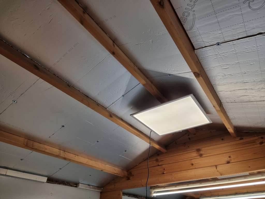

                              I’m just doing my new 40m2 workshop which is timber-built (essentially two large log-cabin style garages end to end with the gap filled in between). I’ve put 50mm enertherm sheets cut close between the rafters and lined the walls with 50mm knauf acoustic insulation between CLS batts with 18mm pre-painted OSB timber on the inside. This has allowed me to get rid of all the surface-mount plastic sockets the previous owner fitted and install flush-fitted metal sockets on the walls.
                              I’m not yet finished and the difference is already noticeable. My last workshop was built entirely from insulated metalclad panels and I expect this one will be as good if not better.

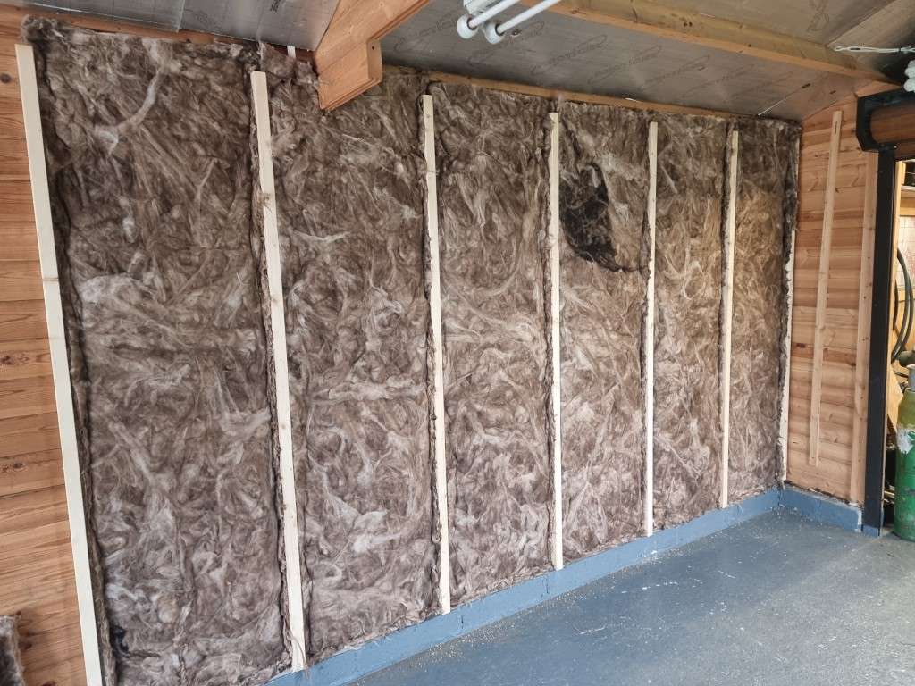

                                My stone- built workshop has a concrete floor with DPM and the main areas overlaid with hardboard. This has proven to be durable and more comfortable to stand on. The building is draughty and cold, but despite the stone walls there’s only significant condensation on a few days when the temperature suddenly rises after a cold damp spell.
                                My main heating is from a wood burning stove, though I have to plan for a rather long session to make it worthwhile to light as the roof is 15′ high. Usually I work for as long as I can in the cold doing model engineering, then retreat indoors for a few hours of firmware development for my other interest in electronic music.
                                I was intending to line and insulate the walls, but 4 years ago my neighbour, who has a similar workshop, battened out the walls and screwed on thick marine ply with insulation in the cavity. He’s a wood worker and made a superb job of accurately fitting the sheets and ensuring everything was plumb. After an unrelated visit by building control he received a notice to remove all of the plywood and replace it with plasterboard, which he had to comply with as they considered it a fire risk.
                                His workshop is detached, but about 10 feet from the main house.

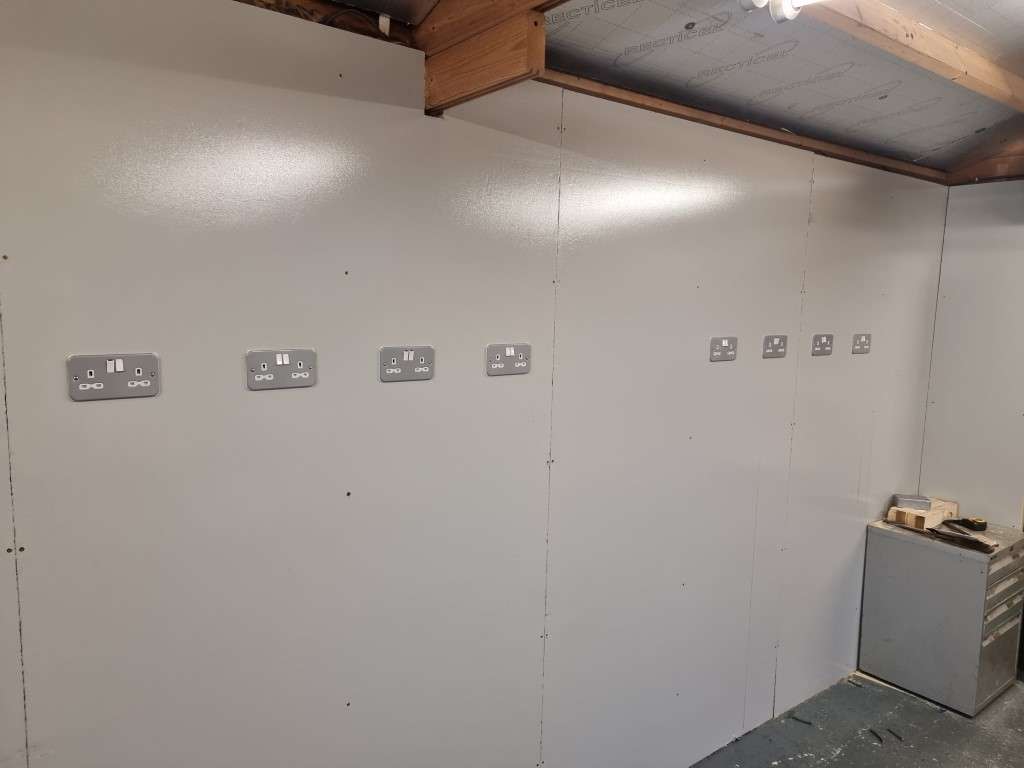

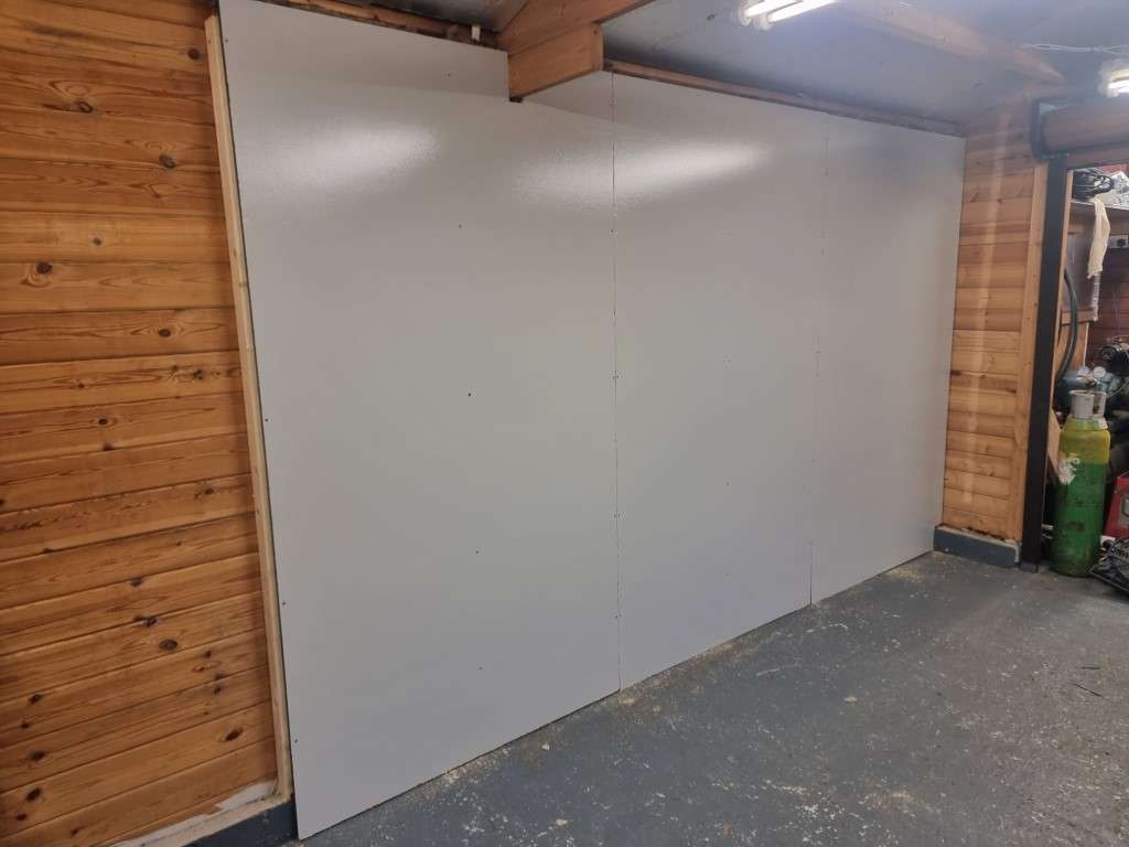

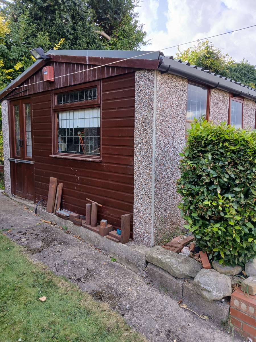

                                  My workshop was originally less than 2.4m wide at the end of a 3.6m wide sectional concrete garage.  The concrete panels were substantially filled with cavity wall insulation batts.  I then covered that with 150mm of rock-wool and erected a frame from old (scrapped) up-and-over garage doors.  These have since been insulated further with another 25mm of celotex, or similar.  The ceiling currently has about 250mm of insultion
                                  A couple of extensions to the workshop have been made with 100mm insulation sheets, and lined with ply sheets.  No windows, and ventilation is via the steel door (also with at least 100mm insulation).  Easily warmed in winter and cool in summer (unless the door is left open!).
                                  Dehumidified (and warmed) by small Meaco desiccant machine.  Currently running at about 750W for two hours each night, costing about 14p/day.  Not a bit of condensation, or rusting, so worth every penny of the running costs.

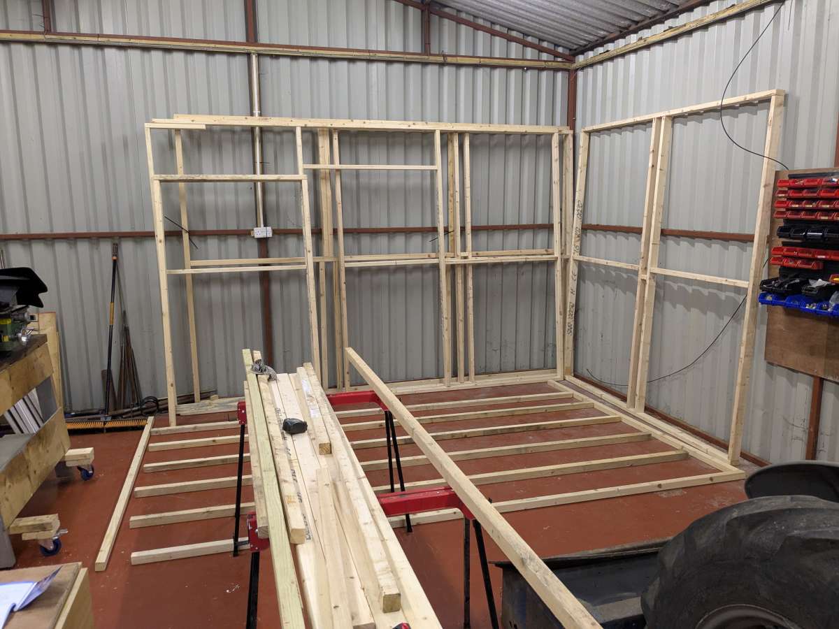

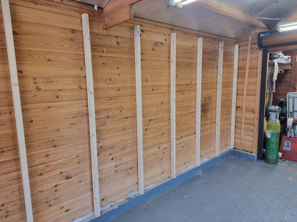

                                        And we’re underway!
                                        I have all the sides built, using 3×1.5 timber. The floor will be 18mm OSB, resting on 2x2s, resting on the concrete floor. Planning to clad the outside for now, then insulate as I can pick up bits on Gumtree here and there.
                                        PXL_20241230_223858298

                                                  #773902
                                                  Nicholas Farr
                                                    @nicholasfarr14254
                                                    Hi, I built my garage with a steel frame and steel sheeting, which was all recycled scrap steel from my employment back then, but I was with a very low budget, so buying a vapour barrier was out of the question, however, the company I worked for, had material delivered in single use two ton bulk bags, and these had to be skipped, as they were non-returnable, so they had no problem for me to take as many as I wanted. These had the tops and bottoms cut off , and then cut along a joining seam and opened out into large sheets, they were then sandwiched between the steel frame and the outside steel sheeting, which has proved very effective to prevent condensation forming on the sides and the roof, which can just be seen at the front end where the last sheets need to be put in place, in the photo below.
                                                    Scan_20250101b
                                                    Regards Nick.
                                                    #773958
                                                    Pete Rimmer
                                                      @peterimmer30576
                                                      I have just about finished mine now. I used CLS battens at half board width and insulated with knauf acoustic roll which comes pre-cut at 600mm centres. On top of this I put edge-sealed and painted 18mm OSB3 which produces a very good base for sockets and wall fixings then cut the socket holes into the walls to fit flush sockets in place of the surface-mounted ones that were there previously. It wasn’t cheap and was a lot of work but so far I have not had a speck of condensation and the light coloured paint on the boards means I have been able to swap the 13 twin fluorescents for 9 LED panel lights giving a much brighter workspace and has also reduced the energy consumption of running the LED lights to about 20% of running the tubes.
                                                      workshopsockets (2)Lighting (1)workshopwalls (3)workshopwalls (4)workshopwalls (5)
