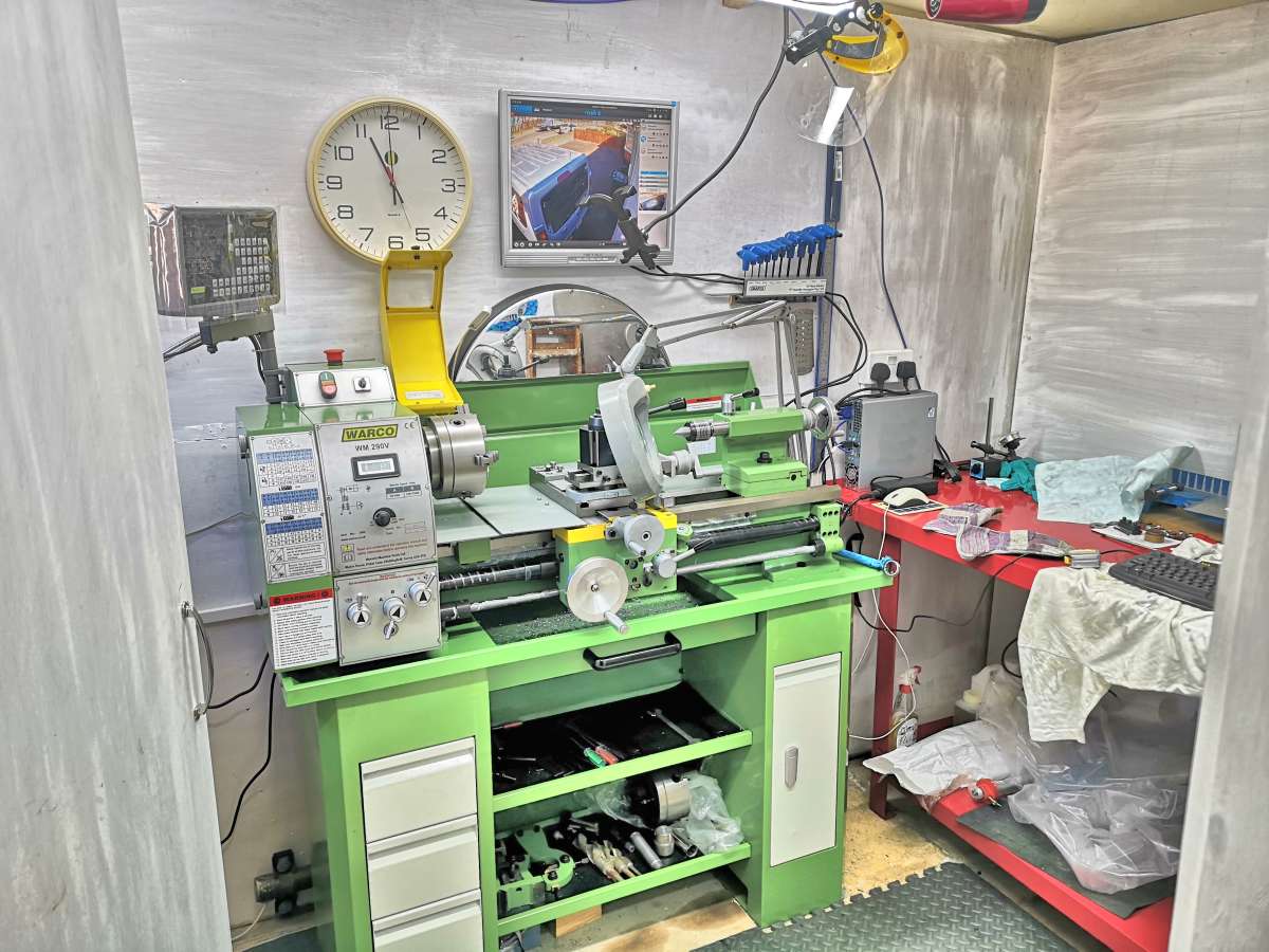

                                          My little workspace has a shiplap timber outer shell with 25mm slab insulation inside with no air gap, covered by 1/2″ rough plywood. The floor is raised from ground level and is constructed of 20mm timber boards on 4″ x 2″ joists covered with 3/4″ plywood and 3 or 4mm sheet vinyl floorcovering. The ceiling uses the same insulation as the walls and is uncovered as shown in the photos. I have a double socket controlled by a thermostat set at 12 degrees Celsius with a 12″ tubular heater in the swarf tray under the lathe (chuck end, see photos) and a four footer (both 60 watts per foot) mounted just above floor level behind the lathe stands (just visible left hand side of lathe photo). I also keep the chuck and toolpost clothed in old tee shirts from autumn on. The Warco mill that now shares this space has no heating near it and the vise and table ends have just suffered their first rust patches in two years so I’ll be sticking another one over there soon. There is little or no ventilation in this space so I may be tackling this the wrong way!
                                          ***I put these images in a gallery but don’t know how to display it (help?), so fresh uploads this time.
                                          CeilingWallInsulation12inchtubeheaterFloorWallsandHeater

                                            Terry – try and cover the whole lathe rather than just the chuck to create a micro-climate for it. A smaller heater placed in the lower shelf would also be really good for this and give you spare heating budget capacity to do the same for the mill.
                                            Since you are prepared to use electric heating you could also put in a dehumidifier perhaps on a timer or instead of the heaters. As it pulls moisture out it will also provide more heat than the energy you are expending, though the COP is less clearly defined than a heat pump. Win-win.
                                            As for the people who keep promoting vents. Have you never heard that hot air rises – and it will go straight out of your top vent. Then when a warm front comes by as it does every couple of weeks in winter in comes damp air to condense on your cold steel. Always always do you level best to seal your workshop and and use a dehumidifier.

                                              @Bazyle Thank you for that Sir. Yes, hot air does indeed rise and seek the fastest path to cold 🙂 As luck would have it my daughter has only just commandeered my dehumidifier for her front porch! I will take extra measures though including tents over both machines.
