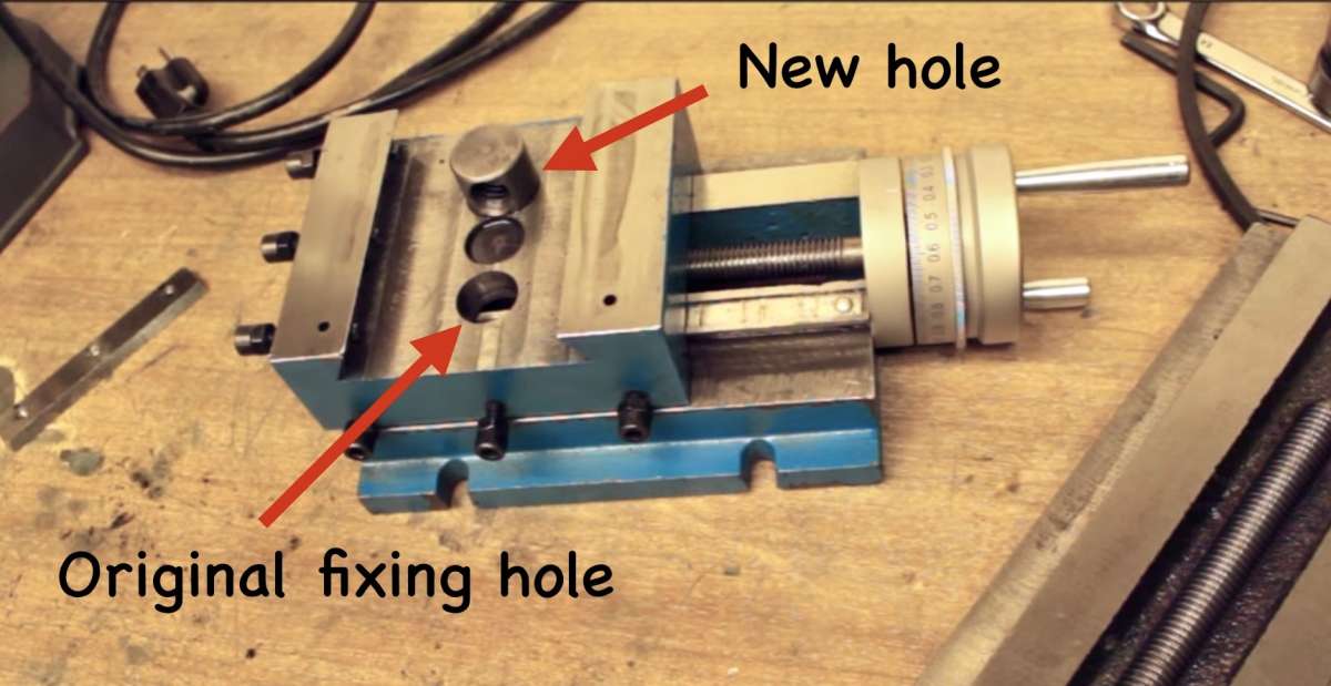

            Looking at the video again the guy said “the lead screw was reversed”, so he moved the nut to the other side. I’m not sure I understand what he meant by this?  If you look at this part it has a central hole (for the nut on the other side) plus two other holes. The empty one is the original and he has fitted the nut into a new hole he bored. I could ask him what he meant but the video is old and he no longer has the table. He’s also been unable to answer other basic questions due to the elapsed time.
            I can’t help wondering if this mod would enable me to swap the table round as the lead screw would be too short otherwise?
            Heres the picture.

              Hi Vic, I guess that guy had a left hand one, and maybe it was a reject with the hole for the nut being on the wrong side.
              Regards Nick.
                  Regards Nick.
                  Yes, that was my thought.

                        Thanks for the additional information. I don’t mind doing some fettling to ensure smooth operation but do you think I would be able to do what I propose in my original post?

                          Hi Vic, if the guy in the video did his one, I would’ve thought it should be possible, but it will depend on your own skills. You can always try swapping the table to the other side without the nut in place, to see if it slides okay, but you will have to make sure the hole is in the right place from the opposite side, as it may not be dead centre. The main thing to consider though is, will it mess the whole thing up if you don’t get the new hole in the right place, i.e. will it still go back the right way and work okay if it goes wrong.
                          Regards Nick.

                            That’s exactly what I was thinking Nick, thanks for reinforcing my thought process!
                            I did wonder how the guy in the video might have got that new hole he bored exactly in line. The best I think I could do is to centre the existing hole on my mill as a reference and give it a try.
                            I suppose if the worst comes to the worst I could end up using the table as it is. Not very convenient but still usable.

                                  The first consideration in swapping the top slide hand wheel to the other end may be which way the table moves for clockwise rotation (ie numbers increasing). On the top slide, the hand wheel is fixed to the table, whereas it is fixed to the base for the lower axis. This means that the top screw is RH thread, and the lower screw LH, both so as clockwise rotation moves the table in the away direction. I think it will be OK, but you should check how this will turn out for whatever change you want.
                                  Both the nuts and the gibs and their adjustment screws are part of the middle block assembly. At a quick look, the dovetail ways are machined central on the other parts, the top slide and the base. So not guaranteed, but the top slide should stay central if reversed. You would still need to drill the hole for the second nut position. The lateral placement would need to be checked carefully, though again I suspect the complete lead screw set up is nominally central on each axis. The options would then be to reverse the slide, or to drill and tap new lead screw mounting holes at the other end of it, possibly decided by which way round gives better smoothness of travel.
                                          Do the job in a way that does not require precise alignment. Or, to put it another way, let the table screw determine final alignment of the nut. Make a bigger hole in roughly the correct place, wax the nut, put some JB Weld in the hole, put the nut in the hole, screw the upper slide back on. Leave until the JB Weld sets. The screw will align the nut up and down, left and right and rotationally in plan. If the JB weld is a bit thicker on one side of the annulus than on the other, who cares?
                                          It would be a little bit like how they fixed railings into stonework with lead – drill the hole near enough, put in the railing and then pour in the lead.
