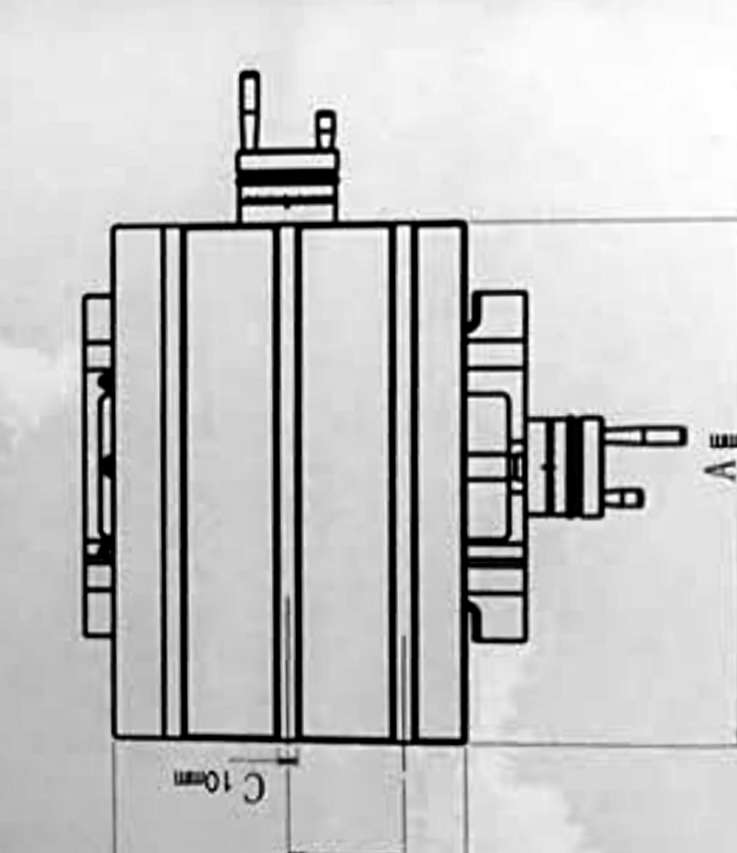

      I have been thinking one of these small tables might be useful for some jobs on my wood turning lathe. The problem is that the hand wheel on the table is on the wrong side. Do any of you have experience of these things. Is it likely I can swap the table round so the top hand wheel is on the left side instead of the right?
      IMG_8961
      #709970
      DC31k
        @dc31k
        It is possible.
        If you look at the second photo (i.e. the technical drawing), the right hand view is of the underside of the table. That shows the nut for the Y-axis at the bottom of the view, nearest the handwheel.
        If you swap the table to the other side, you might have to swap the nut to the other side of the casting (because if you leave it where it is, the leadscrew is likely to be too short).

          Week spotted! Thanks for that. I had (wrongly) assumed the nut would be in the middle. If it’s part of the casting then it’s a no. Buying a new nut and fitting it on the other end could be problematic. Sadly all the small tables follow convention and have the handle on the right as it’s facing you. 🫤
          Edit: Looking again the one you mention isn’t the one that needs changing. There’s no guarantee they haven’t done the same thing on the other axis though? The drawing is not too clear that it can be trusted.

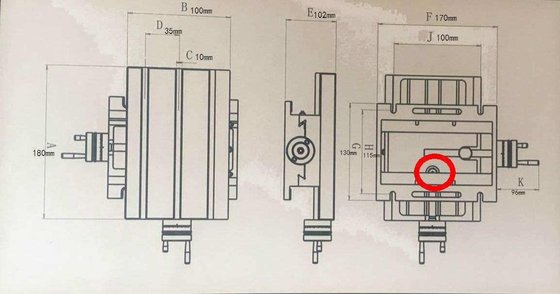

            Have a look on YT for Winky’s Workshop. He shows disassembly of a larger version of the table.
            The nut is almost certainly NOT part of the casting. It would be like a (bronze) lathe compound slide nut. The nut just floats in a circular hole drilled in the stationary part of the slide. On the table you are considering, the nut won’t be bronze, but it will be a separate part. On the YT video, it is not in a hole, but screwed to the lower part with four capscrews.
            The red circled part below is the underside of the nut in question. It would need moving the same distance ‘above’ the horizontal centreline as it is currently ‘below’ that line.
            nut
            Edit: in the post above, I said Y-axis. That is incorrect. I should have said X-axis (going left-right as you use the table).
            Second edit: another alternative is to swap the side of the Y-axis (lower section of the table) but that looks more complicated. A third option is to extend the X-axis screw, leaving the nut where it is. The issue is whether it is a standard thread – some of the Chinese leadscrews use trapezoidal screws in a non-standard diameter/pitch combination.

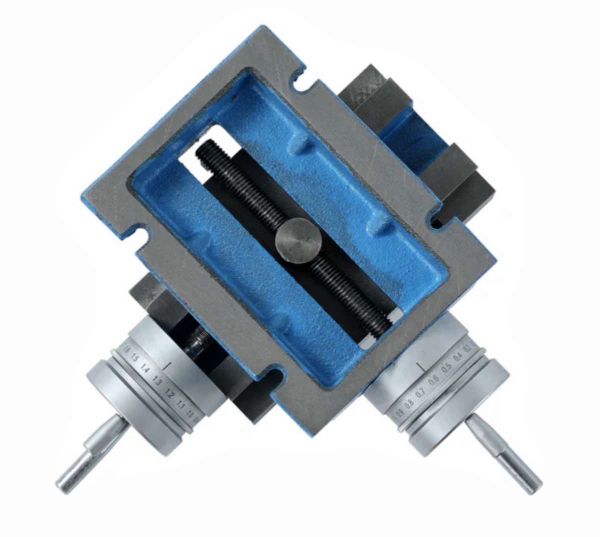

                                      Thanks for that. It looks identical to the others I’ve seen but they show a picture of the underside. It looks like I could just flip it round as, as you say the nut is in the middle?
                                      IMG_9012
                                      #710817
                                      DC31k
                                        @dc31k
                                        The nut shown in the picture in your post is for the Y-axis. That is not the nut that would be entered from the opposite side if reversing the X-axis.
                                        It would be a big step to assume the nut for the X-axis is central and directly above (below in the photo) that one. Try to draw a cross section of the table with that assumption held to be true: it would be difficult to come up with a method of constraining the two nuts with the necessary degrees of freedom if they were directly on top of one another.

                                          I do wonder if the two axes share the same piece of metal for a nut.
                                          Martin C
                                          #710858
                                          Vic
                                            @vic
                                            From what I’ve seen of other tables the nuts share the same part. Due to the bolt holes though they are not opposite each other. One nut is in the centre and the nut on the other side is quite some distance away. I’ve asked another vendor that sells this type of table (at a considerable discount compared to the Aim one) if they would be able to take a picture of the base. If it’s the same as the Aim table I may take a chance.
                                            I’d obviously like to avoid it but if it comes to it I can hopefully replace the nuts and make spindles from off the shelf threaded rod. It won’t much impact the table for the use I have in mind for it.
                                            Edit: If the castings are any good I’ve just seen some trapezoidal screws and nuts that aren’t too exorbitant. 😄
                                            #710869
                                            DC31k
                                              @dc31k
                                              As a practical matter, I think that would be harder and more costly to make than with separate nuts.
                                              It would mean the centre-to-centre distance of the threaded holes to accept the two leadscrews would have to be predetermined. It gives no place for any tolerance in the up-and-down location of either axis screw on its casting. It means the total stack up of the male-female dovetails on X plus the male-female dovetails on Y has to be held to an exact number.
                                              Much easier to have two separate nuts, that can slide vertically in their housing. The two dovetails then become independent of each other and each can accommodate variation in its overall height. It also decouples any variation in dovetail stack height from variation in leadscrew height relative to any set datum line.
                                              As I said, draw a cross section through the centre of the one piece nut that you suggest and then draw all the other pieces in relation to it. You will see the difficulties it imposes and thus the manufacturing cost increase it would cause.
