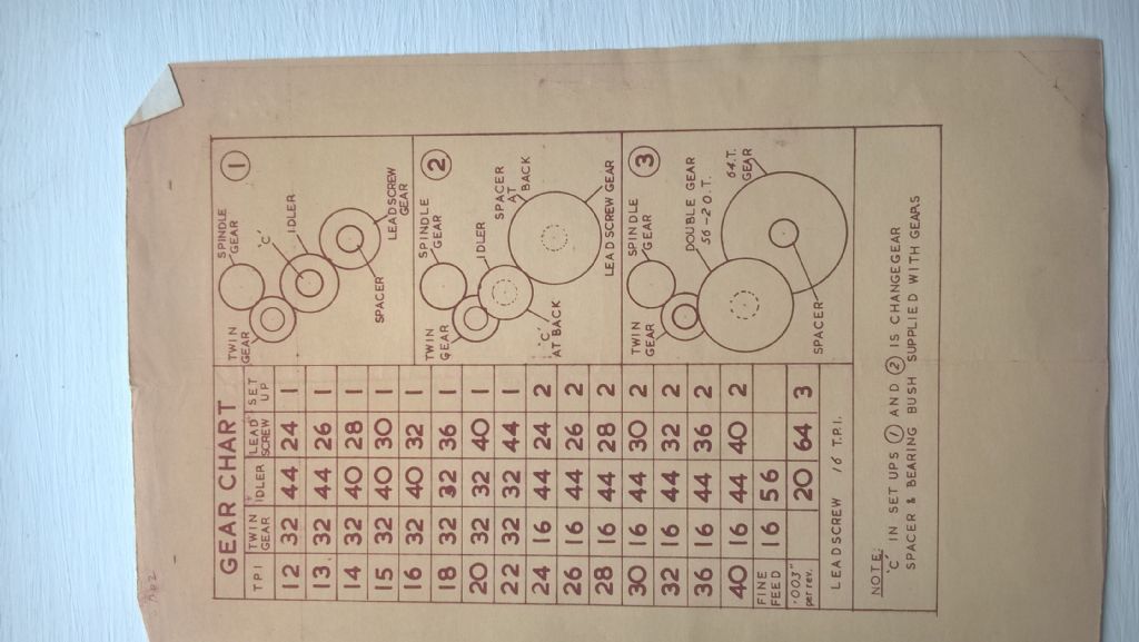

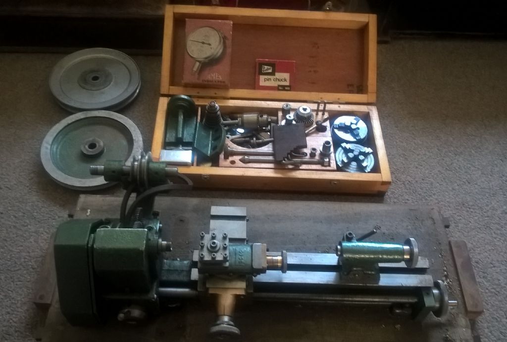

                  gear chart.jpgThanks for the replies. A couple of photos, including the Gear Chart as requested.perris1.jpg

                    Cornish Jack
                      @cornishjack
                      Peter, I would suggest, having seen the photo, that you try to keep that intact as a package. It appears to be quite comprehensive and hiving off the bits and pieces would be a shame.
                      Value is always difficult to assess but from comparable machine prices, I would see £150 – £180 for a private, as distinct from a dealer sale, as being a fair range, considering the accessories.

                        Peter,
                        Thanks for posting the Gear Chart … Much appreciated.
                        Having seen your photo; I agree with Bill, that it would be a pity to split such a nice kit.
                        … That said; if you want to recoup maximum cash for it, you may do better selling the major accessories seperately.

                          #257948
                          michael potts
                            @michaelpotts88182
                            Hello Peter.
                            You have a Perris PL100 lathe, a much rarer machine than the others that have been discussed on this thread. The crucial point is that it is unlike the PL90 machine, it has a different leadscrew, and the gears do not fit the other machines either.
                            These machines appear to have been built between 1966 and 1971 or thereabouts.
                            Your machine is therefore fairly late, appears to have been well cared for, and is very well equipped.
                            One was recently sold on ebay, not as well equipped, and fetched just over £400.
                            Last week I bought what were described as spare parts for a Perris lathe. They were most of a PL100 lathe less the bed, headstock and spindle. I was pleased when you published a photograph of the gear chart because it allowed me to check the gears that were in the spares. They were all there.
                            I would be interested in purchasing this lathe if you do decide to sell. I would also be interested in buying any brochure, handbook, or any other documentation that you may have, or of course a copy. All costs would be met.
                            If you wish to find out a little more about your lathe look at Tony Griffith;s website, lathes.co.uk . He has a list of dozens of lathes, milling machines, drills, shapers and other machine tools. Perris lathes are there, bottom of the second column. The bit you need to read is 'The evolution of the Perris lathe'. It was written by Andrew Webster some time ago. It appears to be a complicated story. There is a bit about the PL100 lathe, but not much. There is less on the main site. As I said it is a rare lathe.
