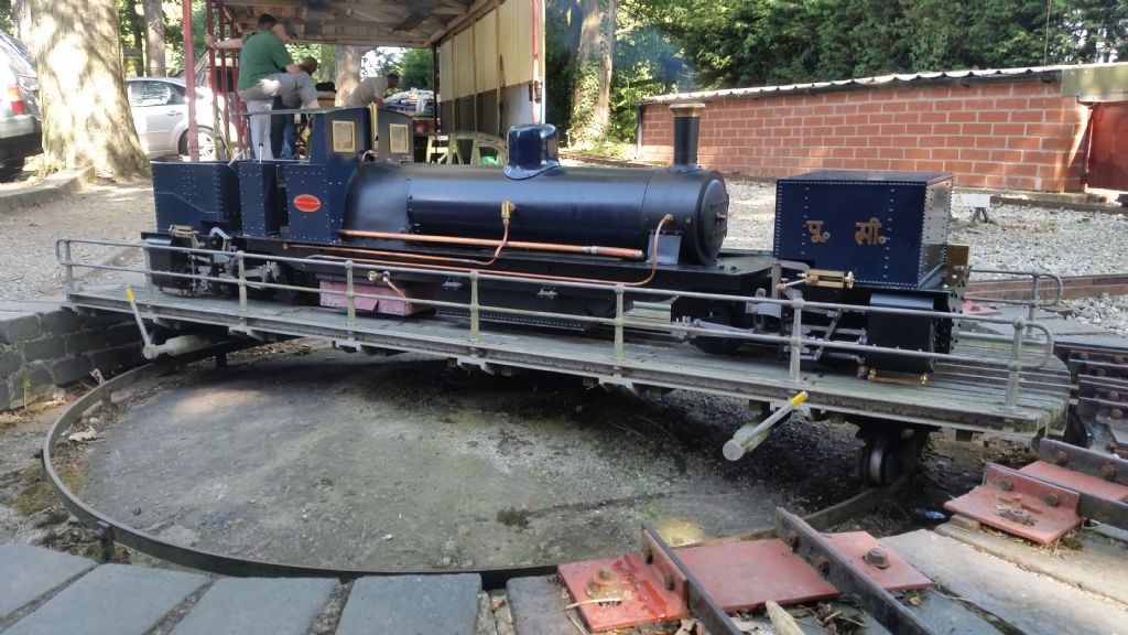

          Here she is on the turntable at Derby SMEE, Morley.  A big engine for a 3.5" gauge, over five feet long.

            What a beauty she is too! Thanks for posting the pic. I used to watch the full-sized later model Garratts shunting in and out of the yard at the powerstation I worked on in Zimbabwe circa 1980. Beautiful machines to see in motion, as I am sure yours is too.
