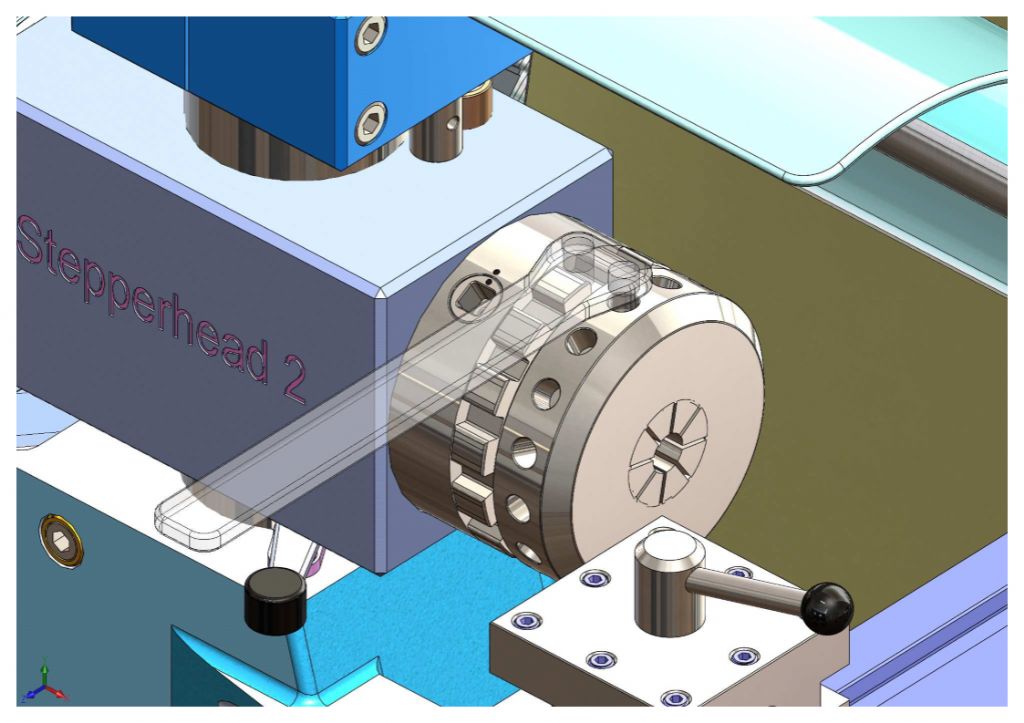

                      What do you think of this spanner and ER32 fitting? There are 16 grooves and 15 holes in the nut, so there is always a zone for tightening/undoing the collet without locking the spindle.
                      Alan

                        Posted by Alan Jackson on 31/01/2021 11:32:26:
                        Alan
                        I admired it principle, as soon as I saw it in MEW, Alan
                        … I thought it was very clever yes
                        My only reservation is that the load on those pins is [if the prescribed tightening torque is used] potentially enormous; so I will be interested to see how well it works in practice.
