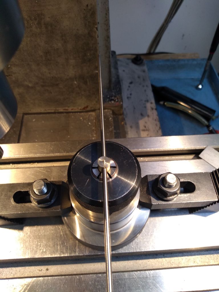

      I thought this might be useful to someone. I needed to hold a small cylinder of brass to mill a transverse slot across one end – this is the top block of a new pendulum. But how to hold it for milling? I mounted the brass in a Myford collet in the MT2 chuck that screws on to the big bore spindle.
      This is the chuck clamped down to the mill table with a silver steel rod to get the cross-hole aligned. But how to get the axis of the collet aligned with the spindle?

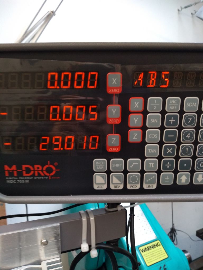

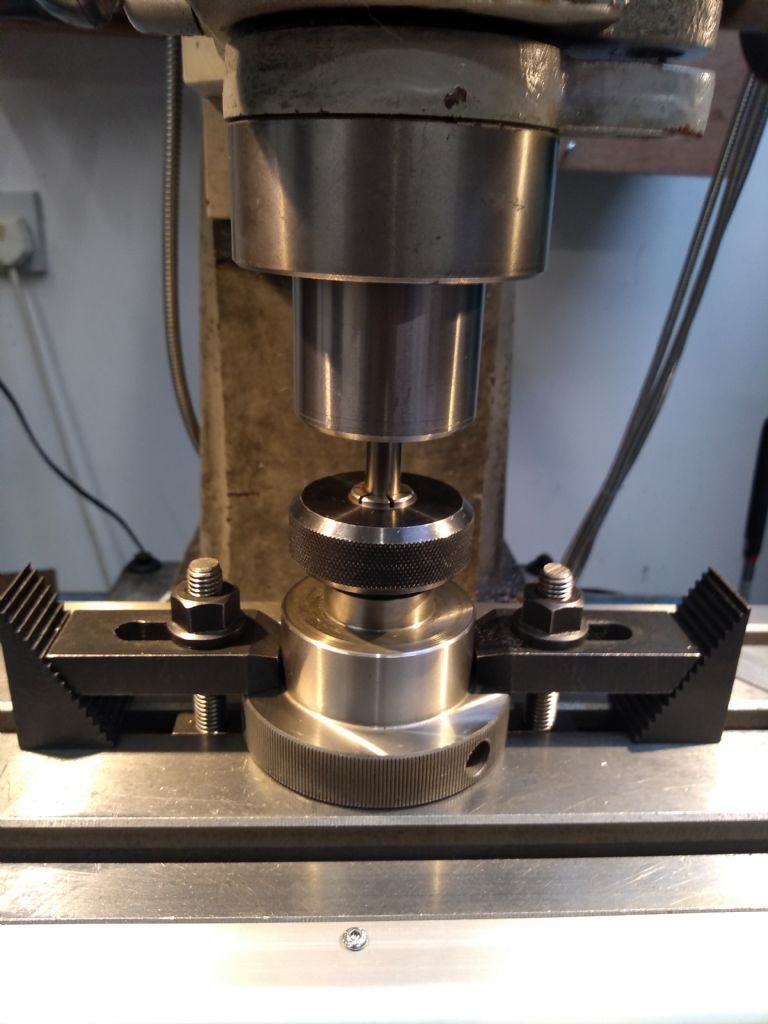

      So I put 10mm collets in the mill and the chuck, and gripped a bit of 10mm ground steel in each before tightening the clamps.
      Then zeroed the X and Y axes on the DRO. Now I could get the axes back in line using the table feeds. As always it took longer to work out what to do and set up the work than do the job.

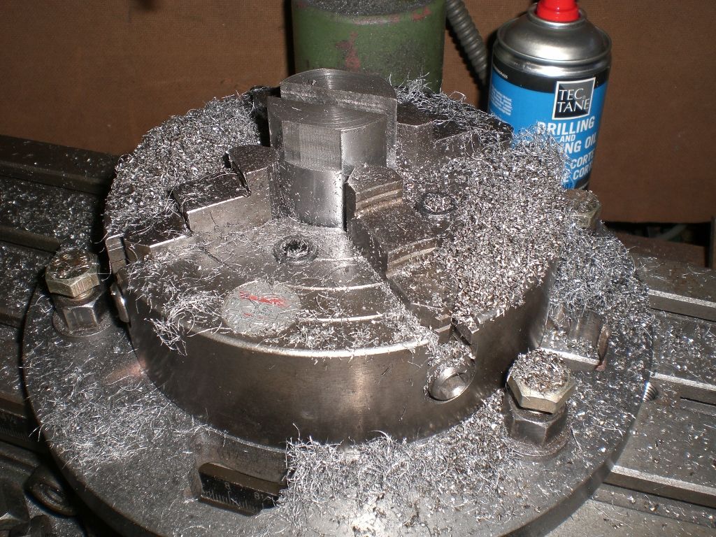

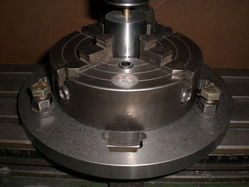

                      Hi, well I did this about 4 years ago, with a piece of 40mm ram rod.
                      Much the same as John's idea, but I probably would use a collect block in a vice for smaller stuff, but hay! utilize what you have, that's what I say.
                      Regards Nick.
