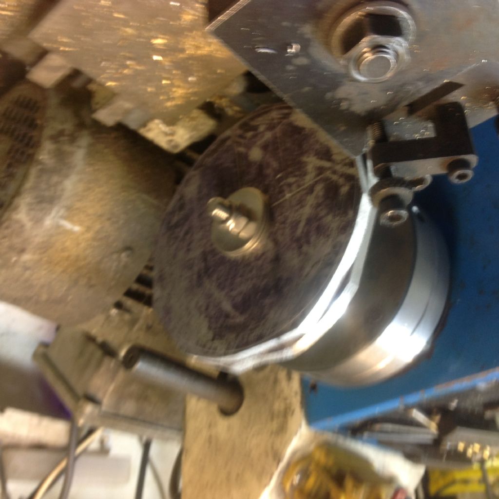

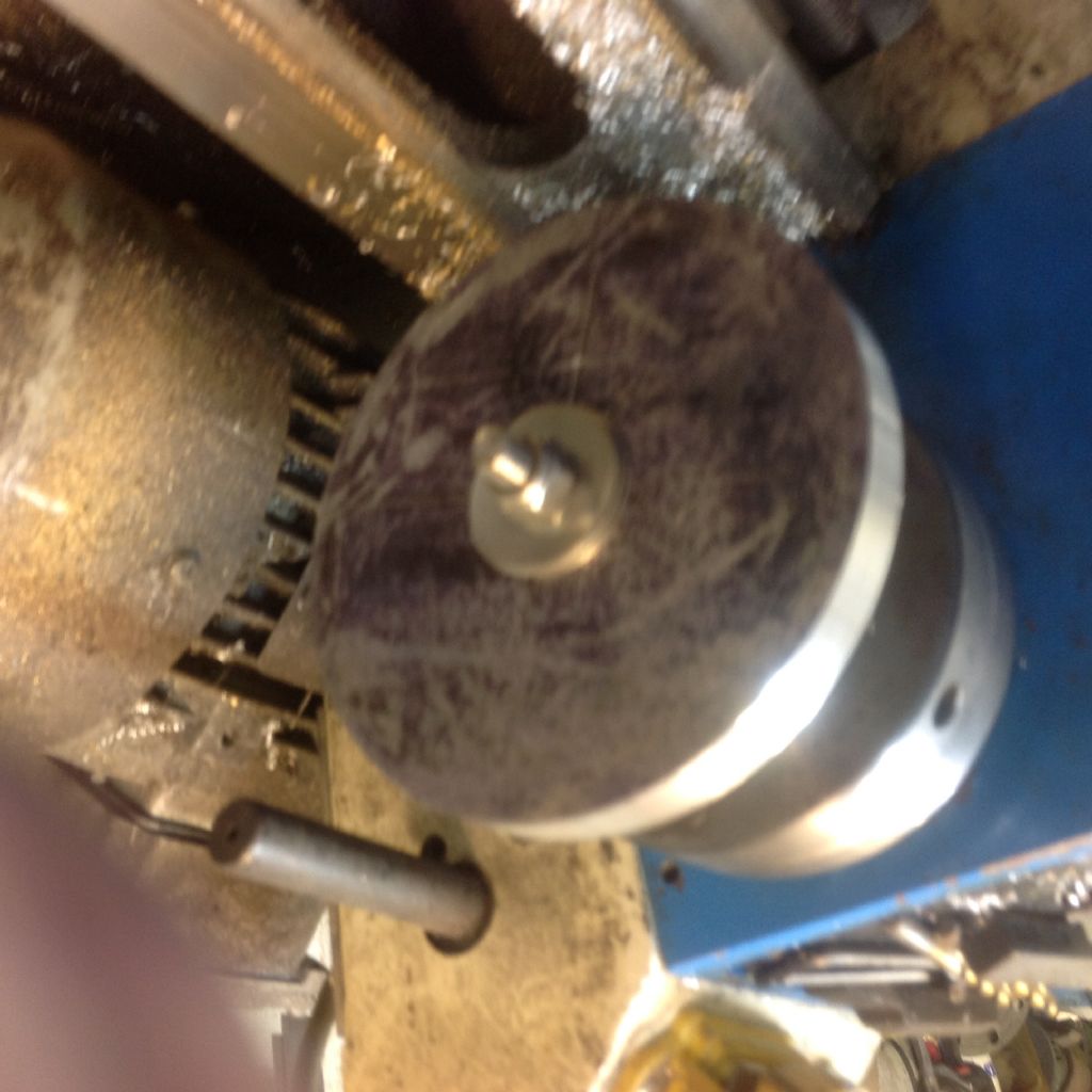

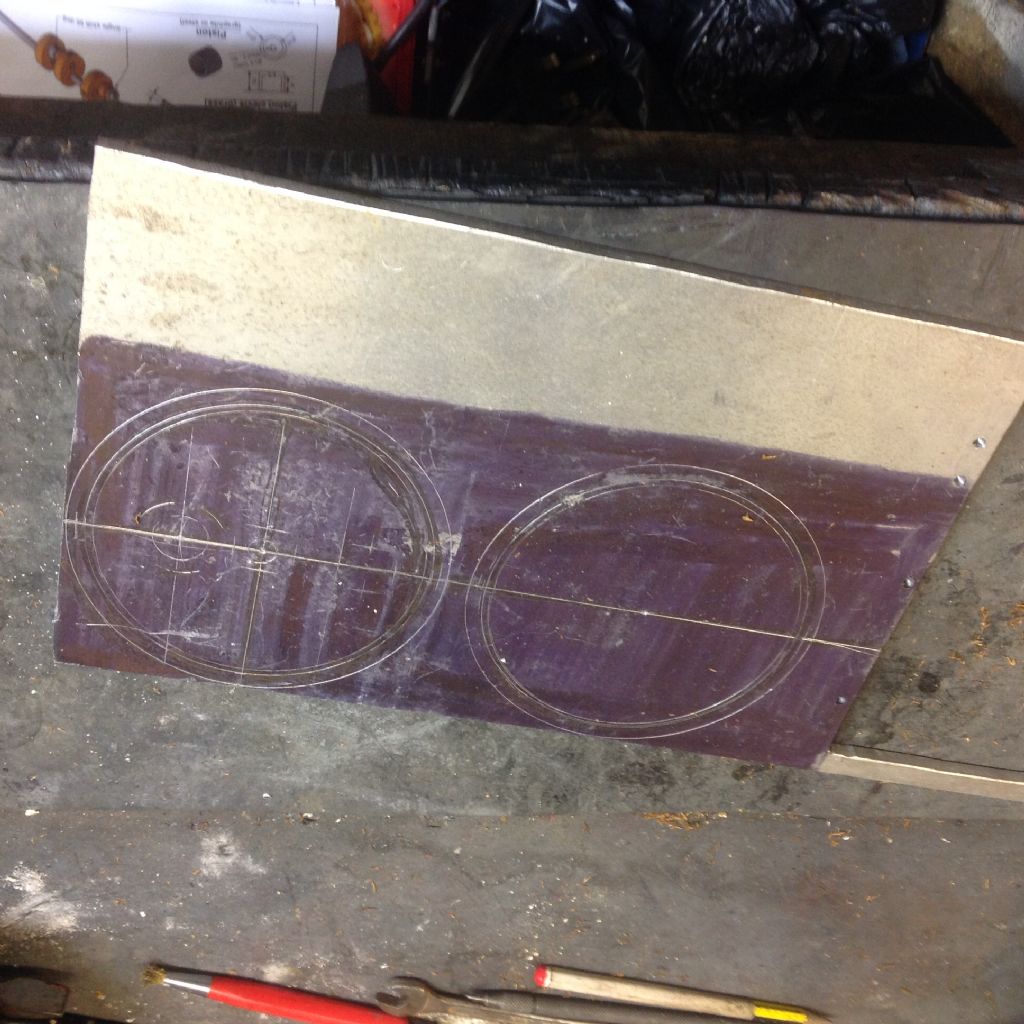

              Hi all
              have made a start on the coffee cup engine dispacer ends used some 'scrap' aliminium plate marked it out,made a mandrel to clamp rough the plates together and turned to size in lathe.some photos in album but unable to upload to this thread.Any clues please ?

                #222163
                  Looks like you have taken them on a phone which rotated them automatically? This rotation doesn't always actually 'stick' to the file when its uploaded.
                  #222167
                  tom bates
                    @tombates28045
                    Neil thanks for the prompt reply. I took these photos on my i pad should I be using a seperate camera to upload pics to avoid this problem ?

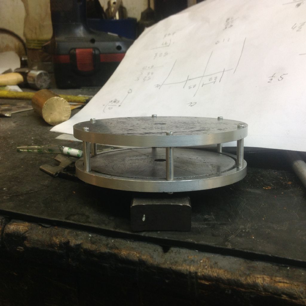

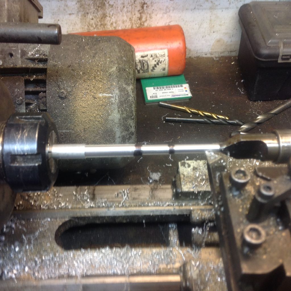

                              @tombates28045
                              image.jpegMade the 6 x18 mm spacers for the displacer cylinder today easy turning exercise (really?) only broke 1x2mm tap😢 so only took photo of a assembled displacer
                              #222353
                              Ian S C
                                @iansc
                                Only problem doing the discs that way, you get a spare hole in the bottom one that you don't really need. A way around that in future, glue (PVA) the plate on a bit of wood, get a small steel disc with a centre hole in it, mount the wood either on a face plate, or a 4 jaw chuck, take the small disc and bring the tail stock up and sandwitch it against the aluminium disc.
                                Ian S C
                                #222354
                                Ian S C
                                  @iansc
                                  Ideally the spacers around the displacer chamber should be of an insulating material, some sort of plastic. My LTD motor is held together with 12 x 5 mm Nylon bolts tapped into the top plate.

                                  #222368
                                  tom bates
                                    @tombates28045
                                    Ian thanksfor the info, but the reason I did it that way was that my rotary table is too small to fit the displacer disc if I try to fit my 4 or 3 jaw chucks I do not have enough height to fit any tooling
                                    with regard to the spacers I did consider making them from delrin but decided to stick to the plan. Might make delrin at a later date. Cheers Tom b
                                    #222380
                                    Gordon W
                                      @gordonw
                                      I made the spacers from hardwood dowels and c/sunk woodscrews into each end. The spacing is not ultra critical and careful marking off should be ok.

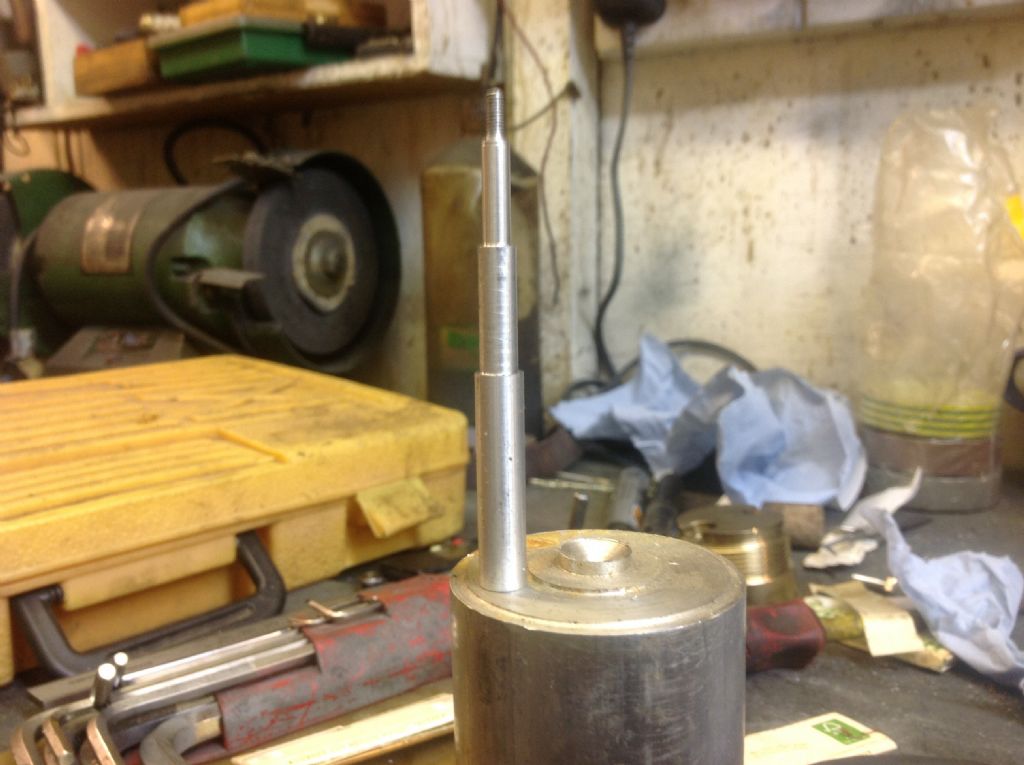

                                            tom bates
                                              @tombates28045
