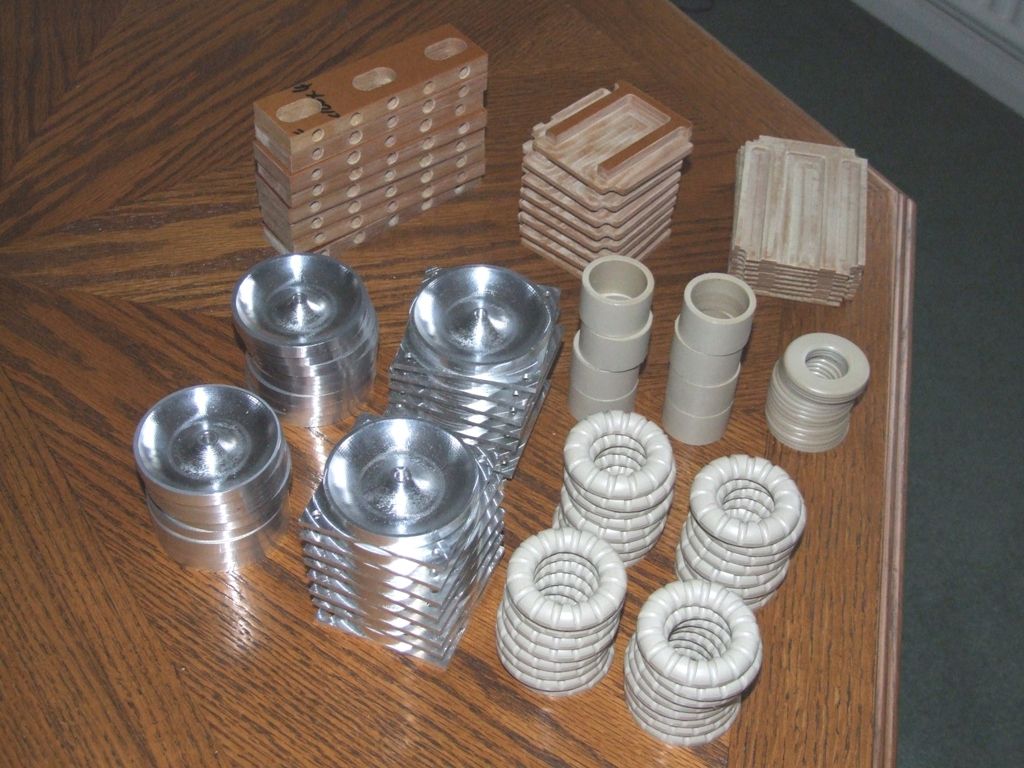

                    The impetus to go CNC came from work, where I was doing the mechanical and electronics design for a high power bi-directional AC to DC power converter. Clearly the case and liquid cooled heatsink was going to need to be CNC milled. I looked at a number of options from new, or secondhand, professional to high end hobby. In the end I settled on Tormach. The criteria were a minimum envelope of 6" cubed (which in restrospect would have been far too small) and 4-axis. Of course I could see that the CNC mill would be useful for my traction engines as well. smile
                    I was already conversant with 3D CAD, so it was simply a matter of learning CAM. Suffice to say I ended up with VisualMill, although looking back I'm not sure that was the right decision. OneCNC might have been better. These are commercial packages, but remember I want to make parts in a sensible time so multiple tools, automatic tool length measurement and tool tables, plus 2.5D, 3D and 4th axis capability were essential. Re-machining capability is essential for me.
                    Learning CAM and CNC was a very steep learning curve done under extreme time pressure from the client. Within a few weeks (full time) I was comfortable making fairly complex 2.5D and 3D parts. I can't show many of the larger parts, but here are some of the simple parts I made while feeling my way:

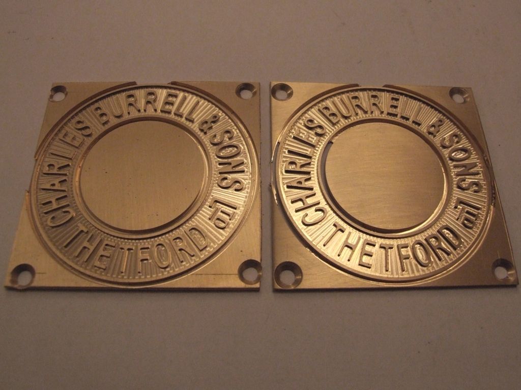

                    Subsequently I've made many parts for work and for my engines. The engine parts range from simple but where multiple parts are needed like wheel spokes to parts that would be difficult to make in the workshop by other means:
