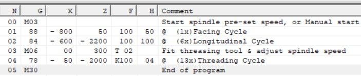

                                                  Nigel, a bit more of an insight:
                                                  I use a 1985 Emco 5cnc lathe and an Emco F1 cnc mill, both are programmed by manual G&M code entry, either at the machine control pad or via an RS232 link to a computer.
                                                  On the lathe a single line of code will face the end of a bar, another line will turn any amount off the bar at the chosen depth per pass and selected cutting feedrate.
                                                  Threading either metric or inch is also a single line entry for threads from 0.25 to 2mm.
                                                  To part the work off also only needs 1 line of code.
                                                  There are 2 methods of programming, Absolute or Incremental that is used below.
                                                  In the code below the bar is 16mm diameter extending 25mm from the chuck jaws.
                                                  The RH cutting tool is positioned at 16mm diameter and the end of the bar.
                                                  No decimal points are used so 800 = 8.00mm and 50 = 0.50mm
                                                  After each cycle the tool returns to the cycle start position.
                                                  Line 01 faces off .50mm for 8mm depth at 100 mm/min feedrate.
                                                  Cutting point of tool now 0.50mm from end of bar.
                                                  Line 02 turns 6mm off (12mm off diam) for 21.50mm length at 100mm/min
                                                  Line 03 Toolchange to threading tool, X&Z dimensions are the tool offsets
                                                  Line 04 Threading cycle .50mm depth of thread for 19.50mm at 1.0mm pitch
                                                  The 21.5 and 19.5mm dimensions are because the cycle starts 0,5mm from the end of bar.
                                                  It is only a 2 minute job to enter such a program at the machine control, takes less time than a computer takes to start and load the CAD.CAM program never mind about doing a sketch, converting to a model then completing the Manufacturing set-up then finally using a Postprocessor to output the machine code.
                                                  This is only true for simple turning and milling operations, for more complicated work and 3D milling CAD/CAM wins hands down, unfortunately such programs cannot be used by my old Emco machines without retrofitting, I have been messing with a lathe conversion and have CAD/CAM facility on that using Mach3.
                                                  Video showing sample G code entry here: **LINK**
                                                  Emgee

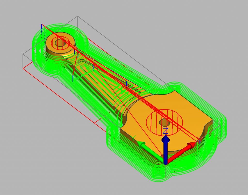

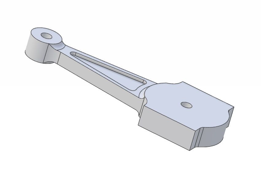

                                                    I have been having a "play" with some CNC software in the last couple of weeks and even as a complete novice, with resppect to cnc, can produce simulated toolpaths for a simple 3D drawing and subsequently the gcode to make the part, The software flow goes like this:
                                                    I designed part in Alibre 3D – loaded stl file into Meshcam V8 and did the necessary to generate the toolpaths – pressed the save gcode button.
                                                    This is the 3D part:
                                                    3d conrod blank
                                                    And the resultant toolpath looks like this:
                                                    Roughing toolpath
                                                    This is for a roughing pass and doesn't machine the top surface. It took a number of experimental tries but the gcode is only a mouse click away and further toolpath generation will produce a finishing cut which will do all the final machining. The two holes where the big and little end bores go are intended to be for mounting to a machining fixture so that the blank can be flipped and a pocket machining run will carve out the other relief and recess.
                                                    I found that the main problem I had was learning all the new (to me) terminology.
                                                    I realise that this doesn't add much to the original query, but does illustrate that, with the right tools, control of a machine is within the grasp of most people.
                                                    Edited By John Hinkley on 01/04/2021 11:46:26
