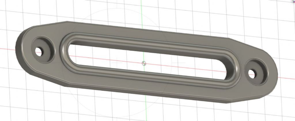

      Now that I've got the hang of my mini lathe I'm starting to dream about a similar milling machine.
      As an example, if I wanted to mill something like winch fairlead below, how would a milling machine cut those arcs? Would that require CNC ?

          The slot end arcs would be cut with a 'normal' cutter, corner rounding cutters are available to do the slot blend rads. The end rads would typically be done with a rotary table after milling the angles so CNC is not needed. Don't know about the Sieg conversion but all the CNC mills I have worked on do have some sort of switchable electronic hand wheel so all the 3 axis [or more] can be moved by 'hand'

            You could make the part on a conventional mill with the aid of a rotary table and internal radiused cutter but would involve a number of set-ups, with cnc the blank material could be drilled and counterbored then screwed down to a sub-plate to allow the rest of the part to be completed with 1 further set-up on a cnc machine.

                First step of you want to use CAD/CAM is make the model, either drawn in 2D or 3D in this case Fusion 360 as I need the practice. Picture of the completed model based on your picture.
                Emgee
