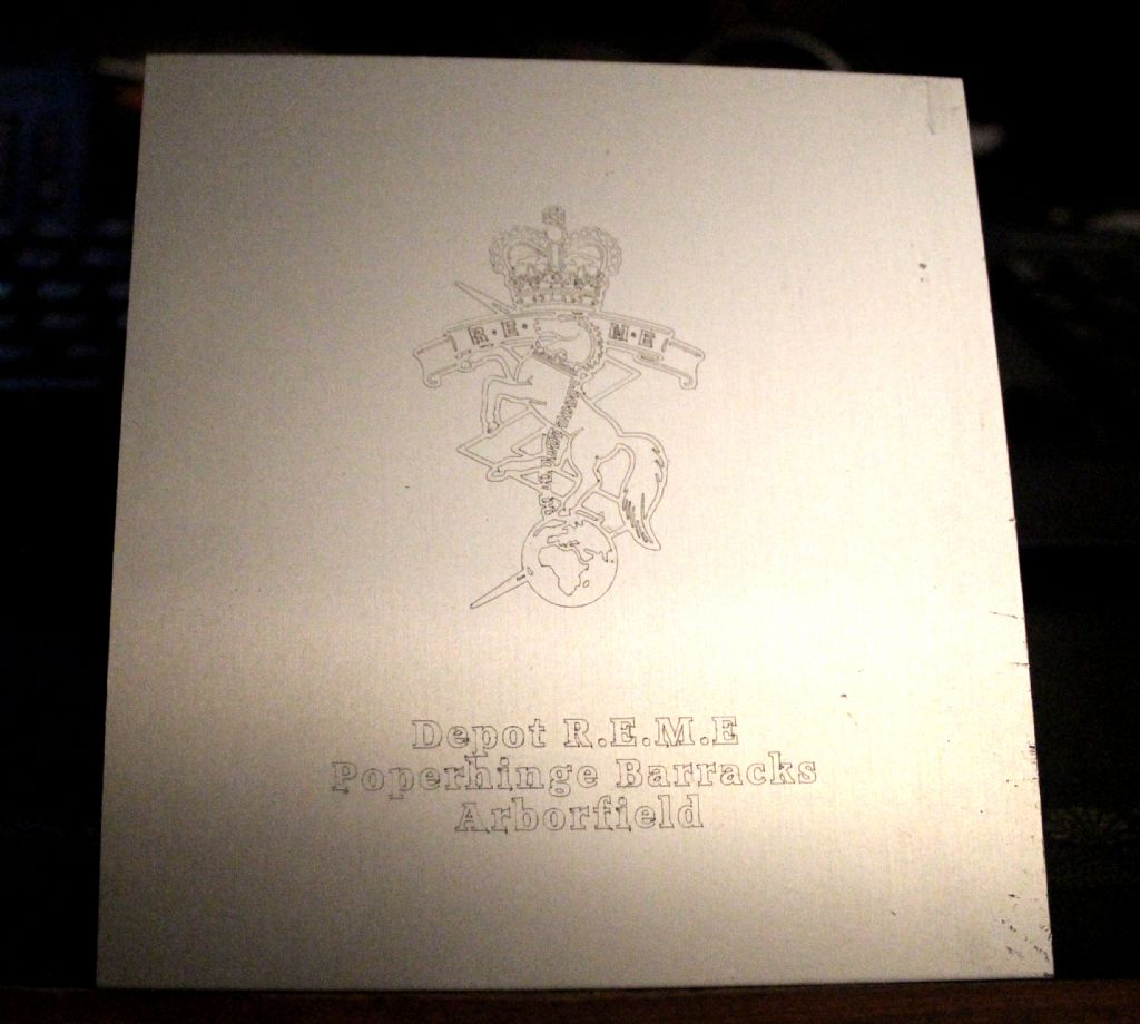

                    "and engraving is particularly sensitive to bed-levelling"
                    Unless you use a spring loaded drag engraving tool. I made my own to engrave some numbers on a curved surface only this week. To see what it could do first though I stuck this piece of 5.5" x 6" ally sheet down on a bit of MDF – no attempt at leveling and let it go. Apologies for poor pic quality but our conservatory is a bit gloomy this time of night.
                    Machine is ISEL CPM 2018
                    Rik
