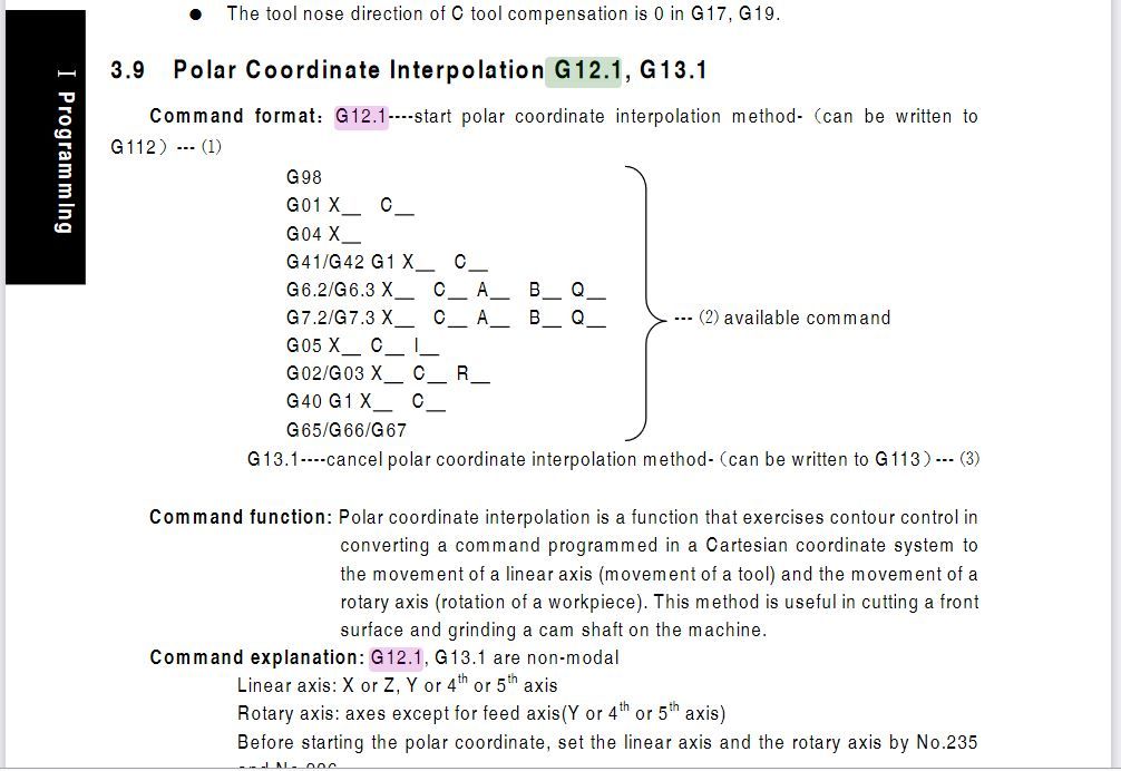

        Nope, No G12.1, G13.1 nor G112 / G113, so can't do!

          Are you sure?
          This is from the manual I downloaded.
          #564689
          Joseph Noci 1
            @josephnoci1
            Well….
            I clicked on the link you gave and abt half way down is a table of supported G codes, and G12.1 et-al is missing so looked no further. After what you posted I downloaded the whole manual and it is as you say!
            I need to dig some more – $3K is a lot of money, but if its not good money after bad, may just be my way out!
            Thanks for this info!
            Joe

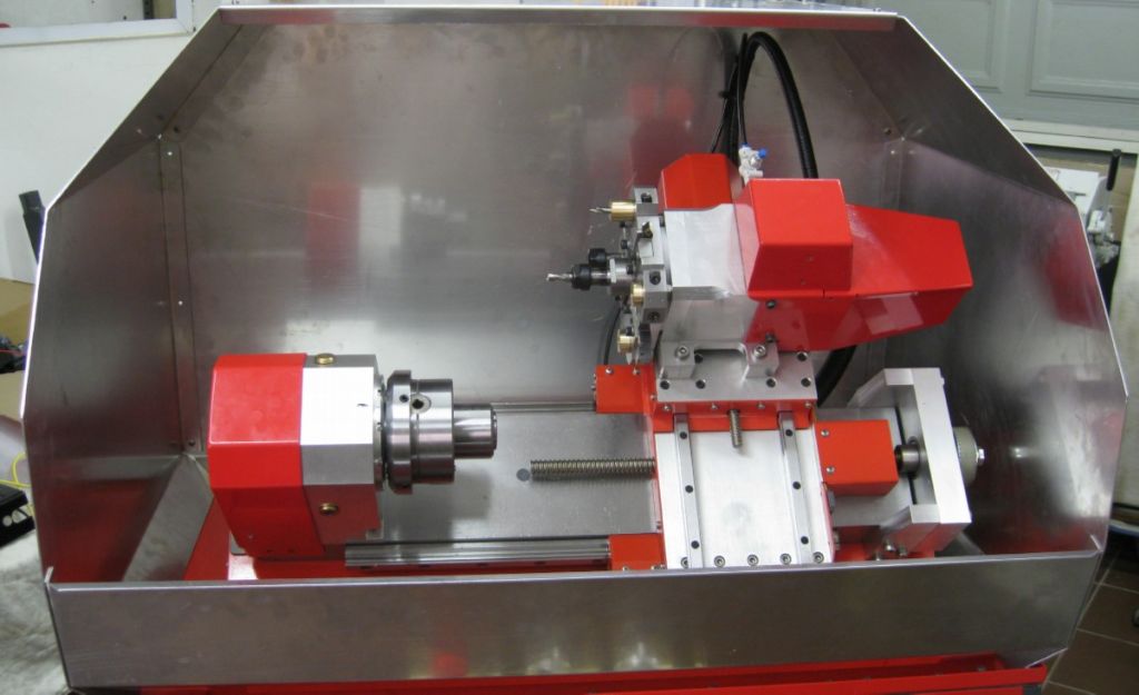

                    Polar Kinematics are fully ensconced in The Lathe's Linuxcnc controller and working very well,
                    I believe all the major Linuxcnc issues are at an end, with only a few minor things to still fiddle with.
                    My Good Wife has again proved to be a Star – She decided to work fully with the Linuxcnc source-code since we had some show-stopper issues in machining 'Polar' parts – She eventually found a bug in Linuxcnc, and the Developers agreed and fixed it! So we now have a fully working C axis Live Tool Lathe!

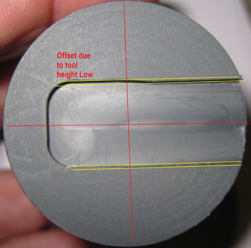

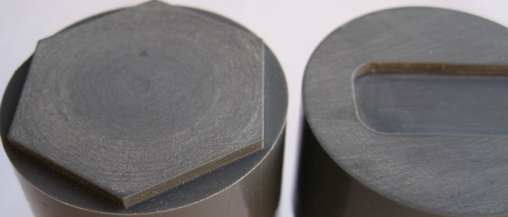

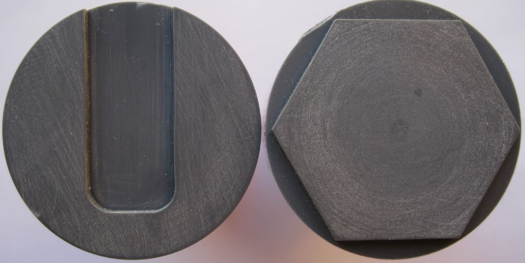

                    Tool offsets are all implemented and working. The fun started when I began to machine test pieces. I did a simple hexagon on the end of a 40mm OD plastic bar, and a U shape across the face of the same sized bar. The U shape is particularly challenging as the milling cutter approached the center of the bar – at that point there are small movements in X with large C axis Rotations.

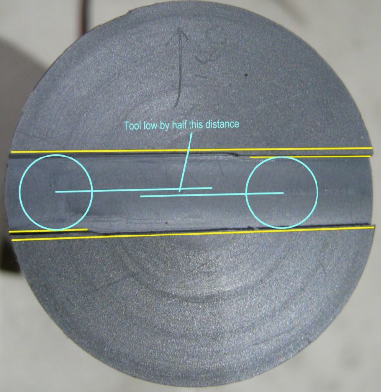

                    The first result of the machined U …
                    Around the centre the cut lines have a 0.2mm deviation – they are parallel, but offset.
                    This was due to tool height, 0.2mm below spindle centerline.
                    This photo shows the 8mm milling cutter cut a slot part way through the bar face, then withdrawn and then the bar rotated 180deg in the C axis and the cutter then brought in again.
                    The cutter cut 0.2mm low each time, hence the offset seen below.
                    The ATC was then raised with 0.18mm brass shim – still a tad low – and another U machined.

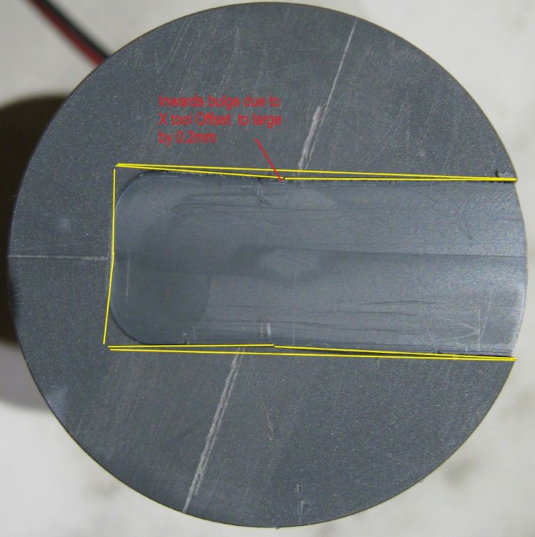

                    This shape made sense and showed that the Live Tool X offset ( G54) was in excess by 0.3mm / 2 ( since the Gcode for these modes are always in 'Diameter Mode'. This clearly shows that the left and right ends of the U are almost at the correct heights, since that is related to tool height and not to X position, while near the center, at the bulge, the C axis is almost at 90 deg, ie, the U sides are vertical, and so X offset plays a big role.
                    This error in X offset ( since all tools are referenced to the master tool in station 1) is due to an error in tool-1 X offset because of poor Homing repeatability and accuracy. I use Hall effect sensors, and extensive tests show no better than 0.2mm spread in detection. So the sensors have to be hugely improved.
                    Sorry about the crappy red text – it says the bulge is due to the X tool offset error of 0.2mm
                    I then machined the U again, but this time setting the Live tool offset AFTER Homing, ie, eliminating the Home deviation – this could be done each time the machine is switched on, then home would not matter, but that is a pain…Good Home sensors are imperative.
                    The left side of the U shape below is about perfect. The right side not so much… Further investigation reveals that it is actually the bottom right of that edge that bulges out – and that is due to not-so-good resolution on my C axis encoder – 4096edges which gives 0.08deg, with a servo deadband of 3 edges which is 0.24deg accuracy at best, with an additional 0.08deg on top of that for position repeatability. So, I need a much better encoder – 8000 edges or so..2000 pulses. The Hex is off course much better, and much easier to achieve good results – the C axis encoder contributes less error since the x deviation versus C angle change is never as disproportionate as when the cutter is near bar centre. The hex is actually very good within 0.02mm in dimensions which in plastic is not bad.
                    In polar/Live tool mode, every little error has to be fixed, any play, offset, etc is critical, and tool height is King…
                    Will try do a video of the lathe cutting stuff in Polar with the live tool.

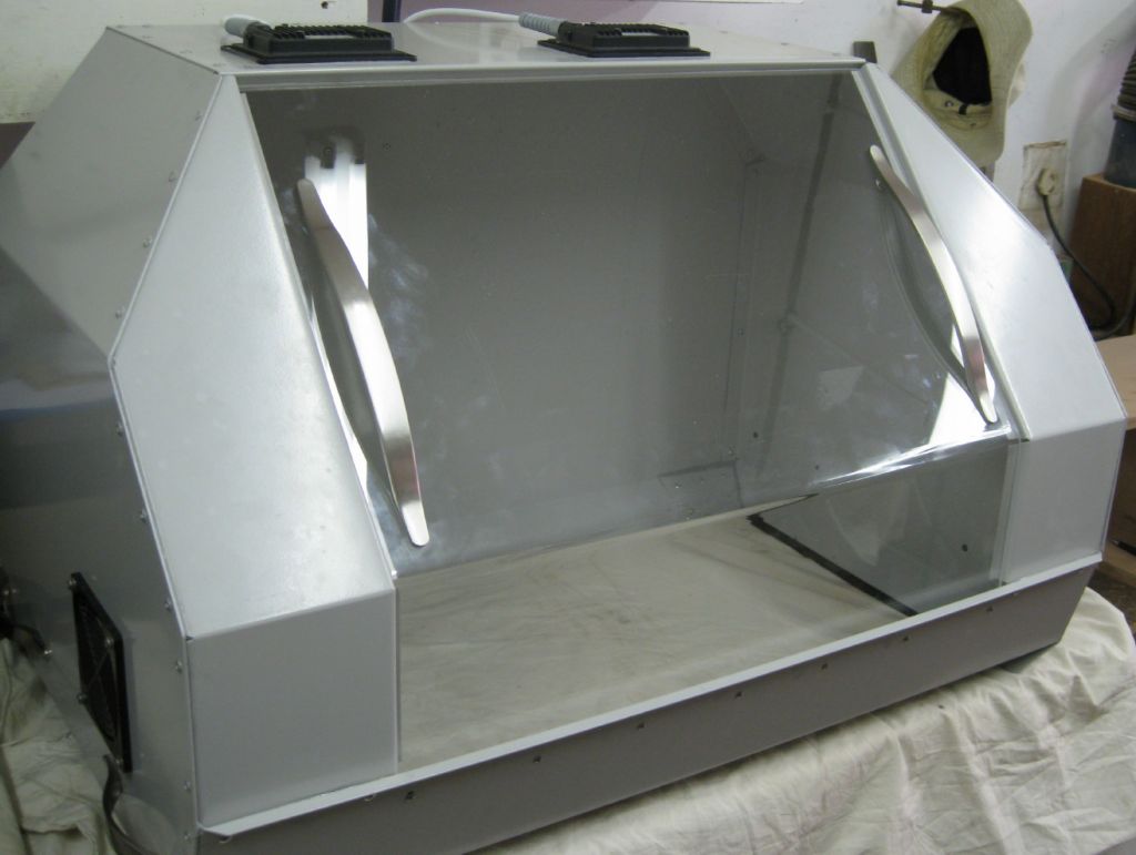

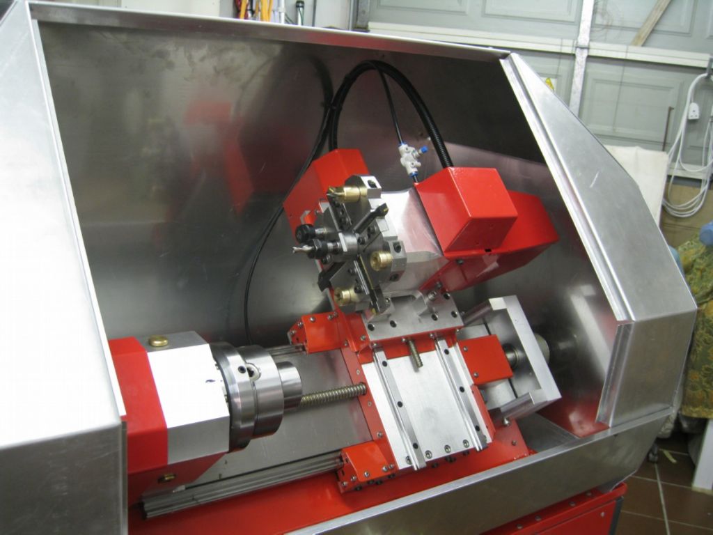

                      So while the design concepts for all that brew, I continued with the Splash guards. This encloses the lathe entirely, to be fitted with a perspex front panel for viewing. I cannot get the flexible acrylic matl in Southern Africa, so Perspex it is..
                      Also have to think a bit about lighting internally – IP66 lights don't exist here…
                      The Guards so far-

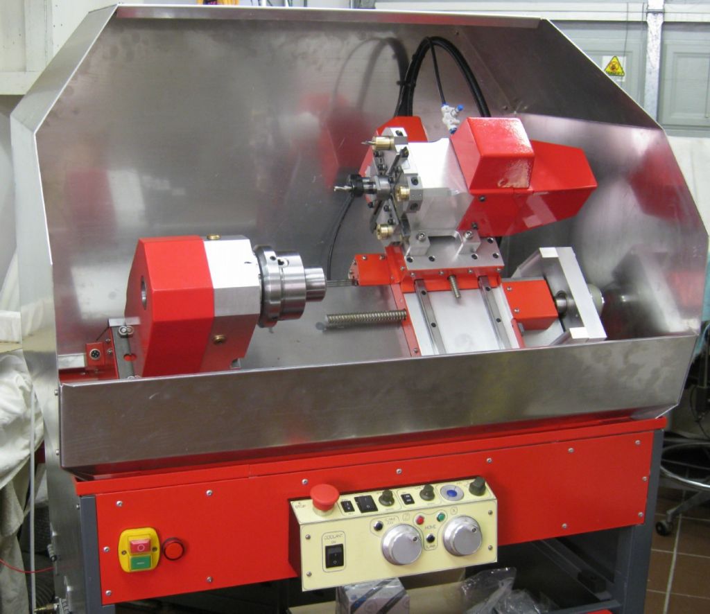

                      Edited By Joseph Noci 1 on 13/12/2021 20:56:05

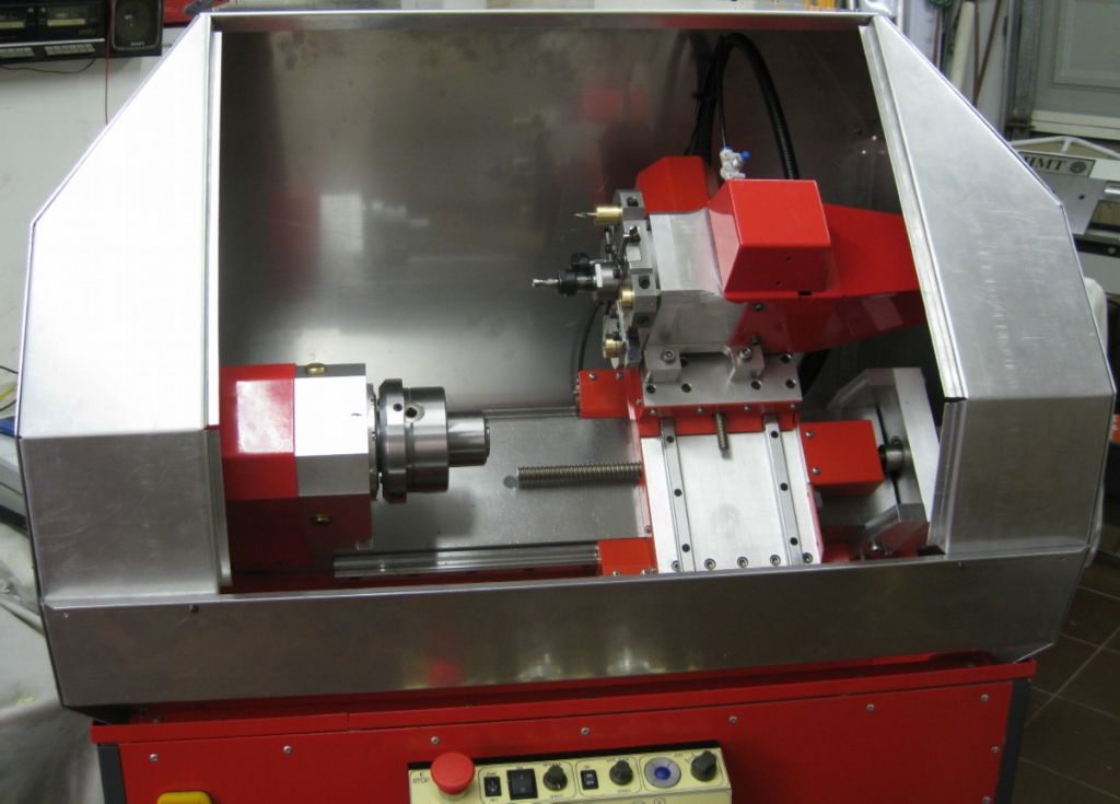

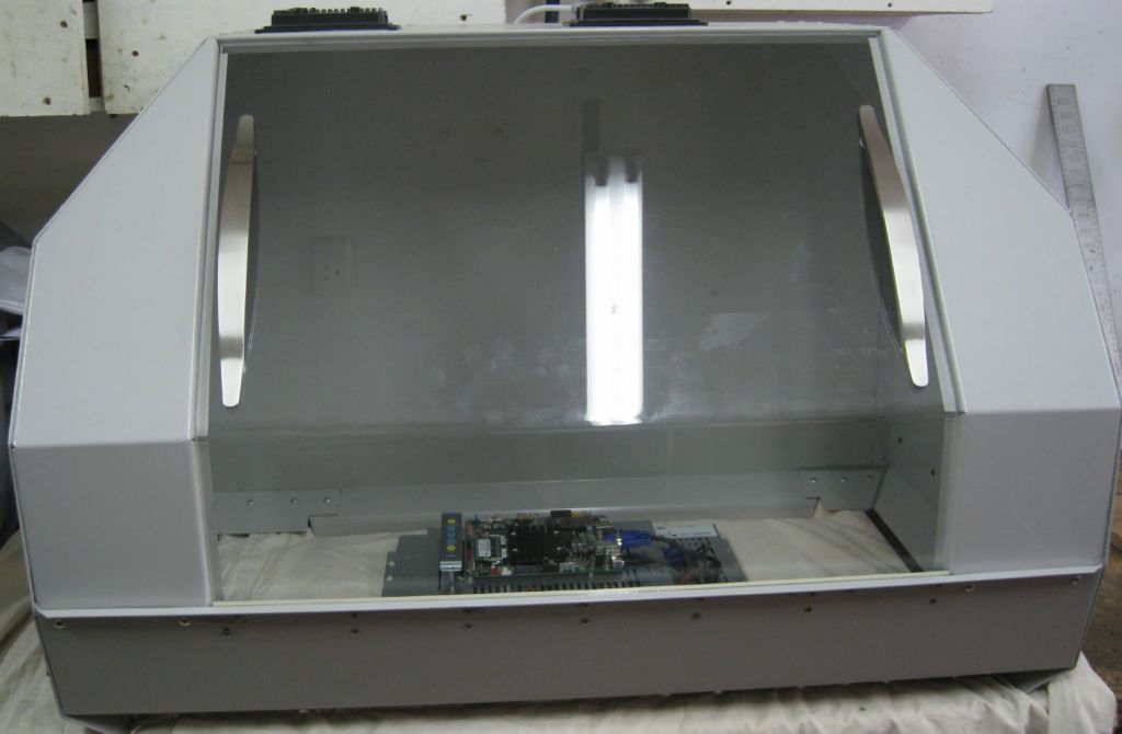

                              Progress on the lathe enclosure was somewhat hindered by the holidays – Powder coaters , Perspex suppliers, FESTO piping/stopcock suppliers, LocLine suppliers, etc, all insisted on closing for the holidays…
                              Some have opened, some have supplied and so some progress has been made. Getting close now…

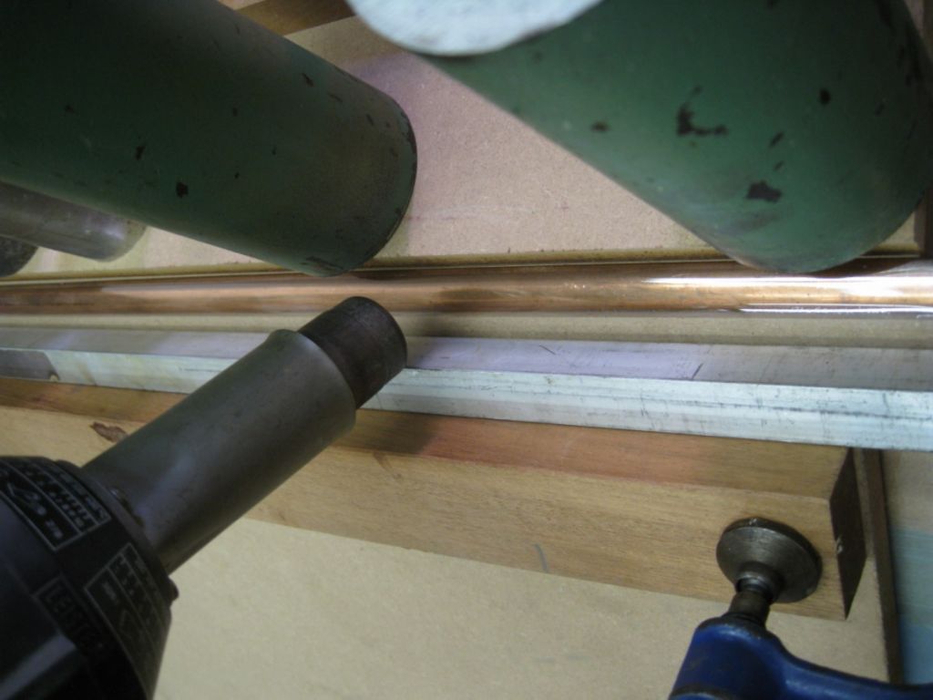

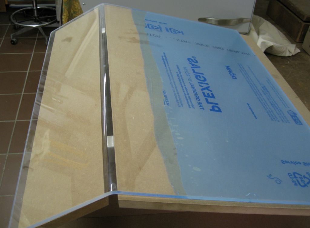

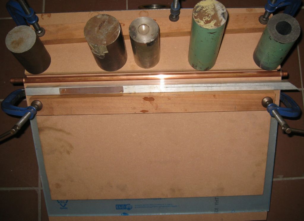

                              The Splash.Swarf enclosure is complete. All the Metalwork is done, painted and together. I used 6mm perpsex for the window ( no sanely priced 'flexicrylic – the non-shatter stuff – available in Southern Africa – R4700.00 for 2.4Mx1.2M, the smallest available)
                              This required a 38degree bend in it, so I mad a supawood jig and heat-bent the perspex with a heat gun. That worked very well.
                              Heat gun heater..
                              The bent sheet.
                              Handles fitted and cover located on Enclosure window.

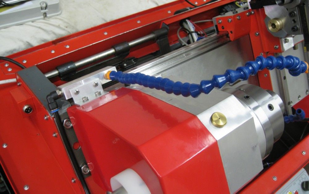

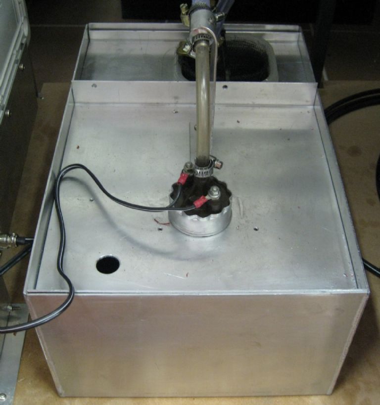

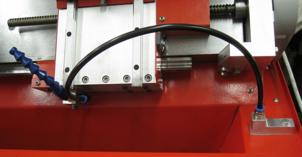

                                The coolant pump is also done and tested.
                                In a previous post I indicated I would use a neat oil 'coolant'/lubricant – That was not a success. The oil was great, very thin, and does is intended job well, but the mess is intolerable. An oil film sits on everything, and just sits there. It does not run off like the water soluble oil solutions do. It sits on the swarf and takes days to drain of, and even then , not so well. So I dug for a more modern soluble and found some excellent stuff – Ecocool 600-NBF, made by Fuchs. from 4:1 to 20:1 mix, and £45.00 for 20liters. When mixed, the solution is clear and has no detectable smell. Drains off quickly, and left pooled on a shiny machined clean mild steel plate over the Christmas/New year week, left not a mark.
                                The pumps is a 12V fuel injection pump – seems to be able to develop a good few bar pressure. It hangs in the coolant tank with an inlet sieve. The drain from the lathe goes through 2 further sieves on route before the coolant drops into the tank. We will see what the coolant mix does to the pumps gears/seals, etc. The pumps was inexpensive anyway!

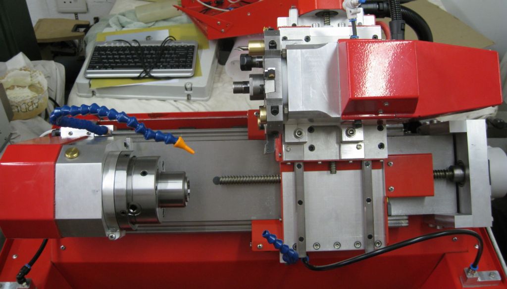

                                Coolant spouts placement on a CNC lathe is a big deal..Normally on the CNC machines the coolant spouts from the tool holder onto the cutting edge, often out the cutter itself with special coolant channels in the cutters, drills, and tool changer. Since that is not possible on my setup, I opted for two spouts, one placed for surface and face cutting, and one for drilling and boring and with Live Tool spindle- the latter spout to the right of the workpiece, the former on the left.
                                (some suppliers are STILL on holiday, so the right spout locline has not yet been lengthened..)
                                The left spout is fixed, and will flood fully the workpiece from behind / under. The right spout moves with the carriage and is aimed at the workpiece center face.
                                Still some machine covers at powder coaters, and when that's done the machine is 'ready' to use…

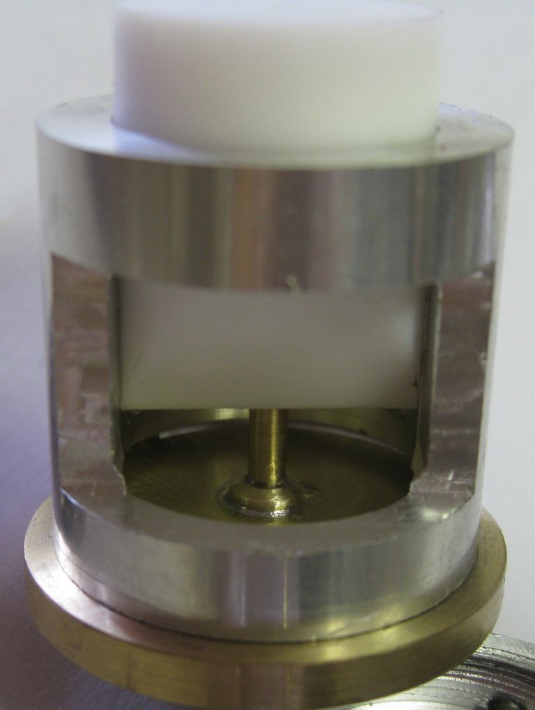

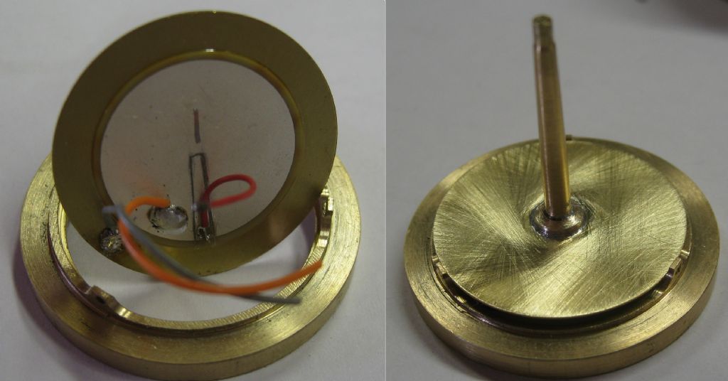

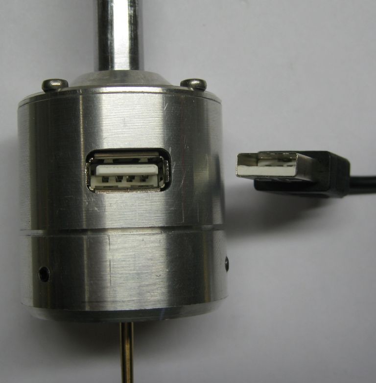

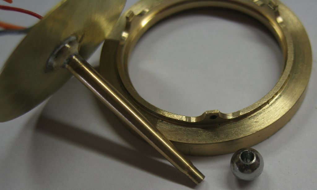

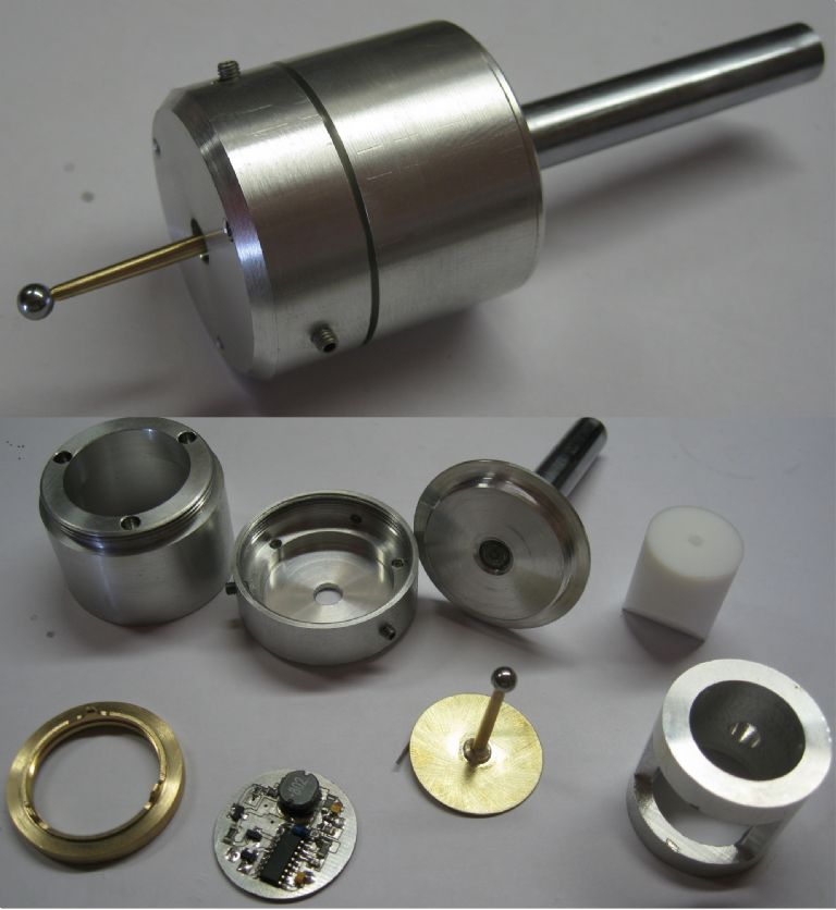

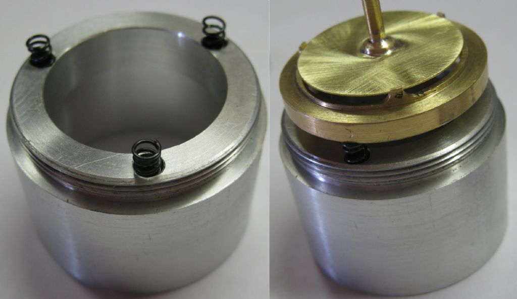

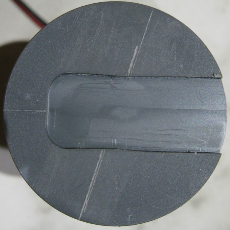

                                        Not really a continuation of the Lathe itself, but related since I am pursuing touch probing concepts for the Lathe.
                                        Most 3D touch probes work on the principal of a lever (the ball attached to the end) moving a tri rod contact from 6 balls, all items electrically in series, so when one rod breaks contact with a ball, the touch probe has made contact.
                                        Some DIY attempts have used a Piezo sounder disc attached to the touch probe, and relies on high gain amplifier detecting the voltage spike from the Piezo when the probe 'strikes' the workpiece. These have various measures of success – contact must be 'definite' – slow approaches require very high gain in the amplifier which then requires deep filtering to prevent machine vibration detection etc…

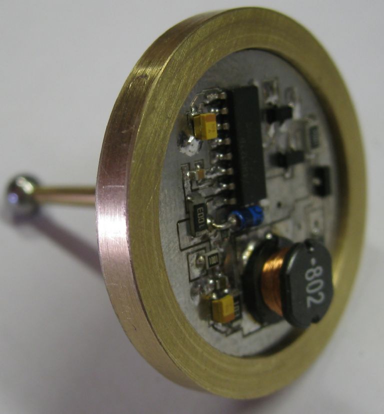

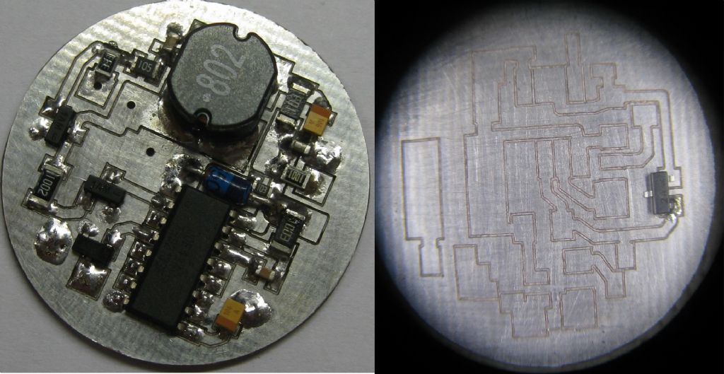

                                        I went another route – used a piezo disc, but in a closed loop oscillator so the probe ball tip 'vibrates' ultrasonically. The disc holder is critical – the piezo disc domes in and out during oscillation, so supporting the disc is normally at 2/3 its diameter. I supported it on the periphery at 3 small points, zero deg, 120deg, and very critical, 220 deg, NOT 240deg. 240deg gave a probe tip up/down motion only, almost no side motion. Moving the 3rd support caused the tip to oscillate up/down and circularly, ie, the tip oscillates all over inside a sphere around 0.003mm larger than the ball on the tip…This was measured with a Laser inteferometer at the local Mining Mineral analysis labs..!!
                                        The piezo disc is a common buzzer disc, with 3 contacts – GND, main contact and feedback contact. The oscillator runs from 1.2V and the feedback is set so that is just oscillates reliably between 0deg C and 50degC. The slightest contact with the ball in ANY plain stops the oscillation. This cessation is detected within 3 oscillation cycles ( @3.9KHz = 0.7msec) . Deflection of the ball at cessation after 200 to-and-fro runs is around 0.008mm in horizontal, and 0.006mm in Z.
                                        It works a darn treat!
                                        The assembled probe and its bits below.
                                        The PCB – engraved on my PCB router..
                                        The Piezo disc from the rear – with the disc holder beneath it – left.
                                        The disc with probe, fitted to the holder supported by the three points.
                                        Electronics on the rear of the disc holder
                                        The jig used to located the probe on the disc when soldering it in place.
                                        Left, main body with Z springs
                                        Right, disc and holder atop the Z springs

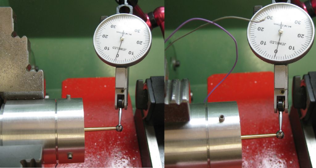

                                        View of the probe tip and drilled ball – also the disc holder
                                        Setting tip runout – 1/2 div @ 0.01mm div guage.
                                        This one for the Mill, another for the lathe – a different shape to fit an arm on the ATC…
                                        Joe
                                        Edited By Joseph Noci 1 on 23/03/2022 17:10:52

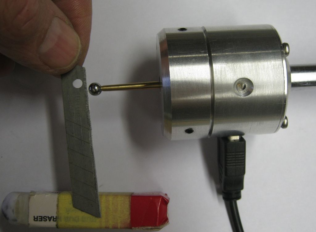

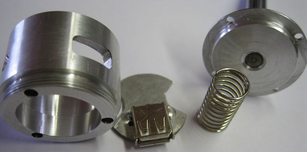

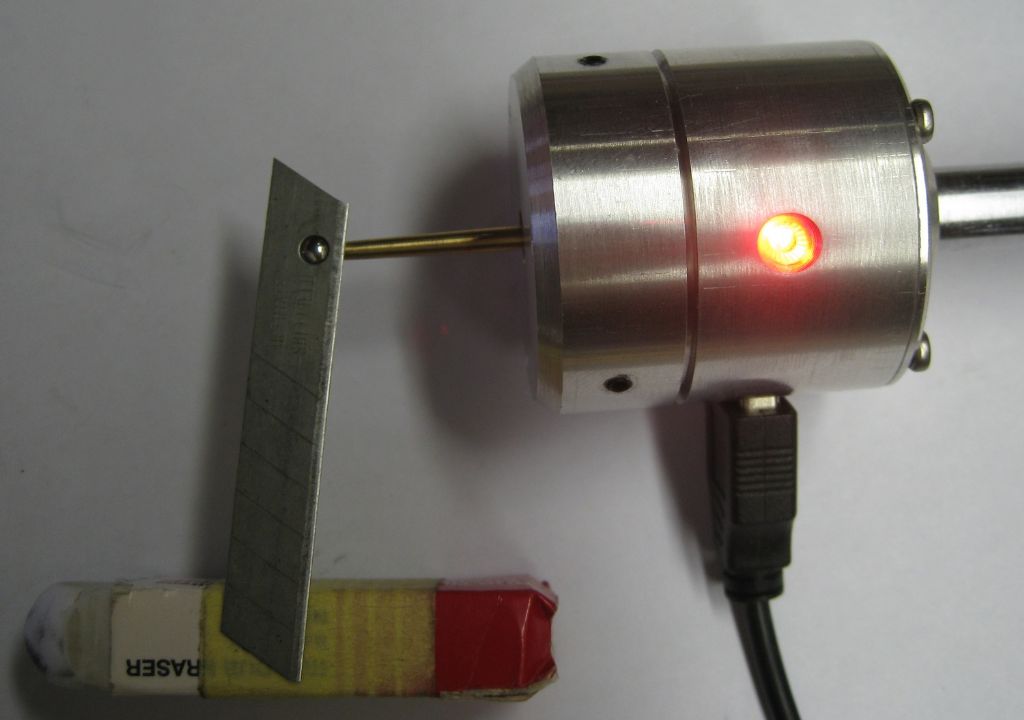

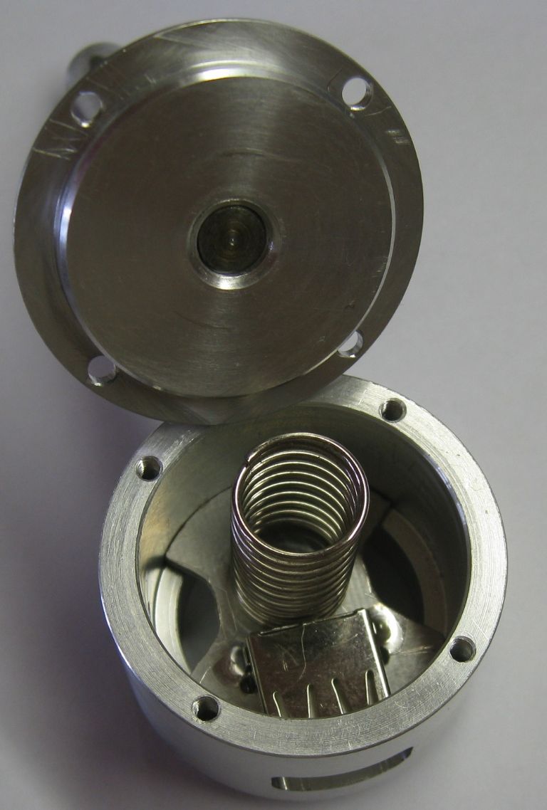

                                                Finished off the probe as far as I want this prototype to go – It really works well. Fitted an LED so I have a visual indication if I use it on a manual mill. Connectors for these items are always an issue – I hacked in a USB-2 connector – use two pins for power and one for the open drain to ground output to Linuxcnc for probe contact. When I do the actual one for the lathe it will be permanently mounted on the cross slide and a different format. The proto in the images is great for the mills.
                                                It is REALLY sensitive less than 1gram activates it fully, and oblivious to machine vibration, etc. A crash ( it happened..) of 4mm overrun pops the Piezo disc out of the tri-point holder with no damage – refit it and recal ( runout) and all works fine again! Of course this is only valid in XY – Z would kill the piezo disc!
                                                The USB connector pcb – held in place against a rebate by the spring seen below, when the rear shaft and cap is fitted.
                                                Business end of the USB connector
                                                A section of snap-off blade shows how sensitive the unit is. The blade weighs 1.37grams and one end sits on the eraser so the weight on the ball is maybe 0.7grams or so.
                                                And while its powered it sits and sings quietly at 3.9Khz…
