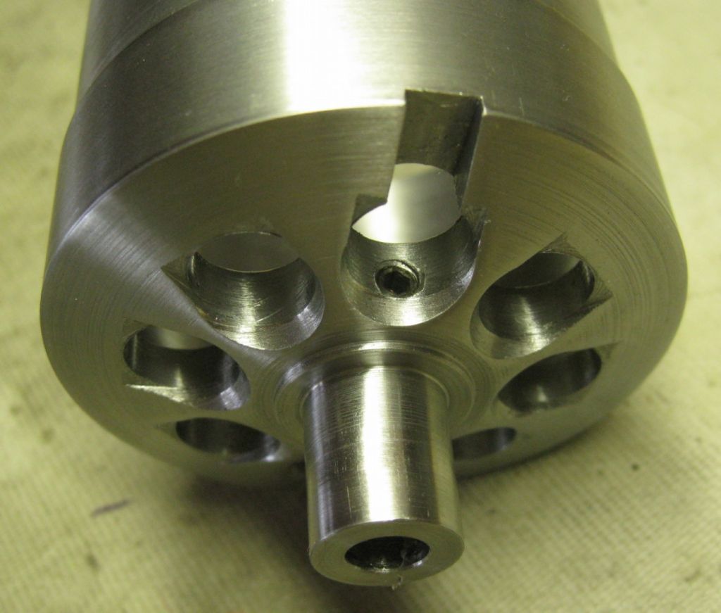

      CNC'ed the air cooling holes into the magnet Rotor housing this morning, and fitted the locking grubscrews. rotor aircooling1.jpg
      Getting there…

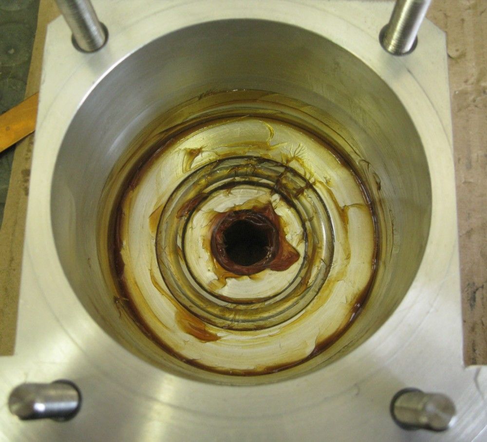

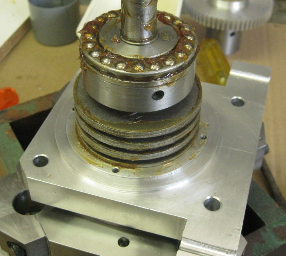

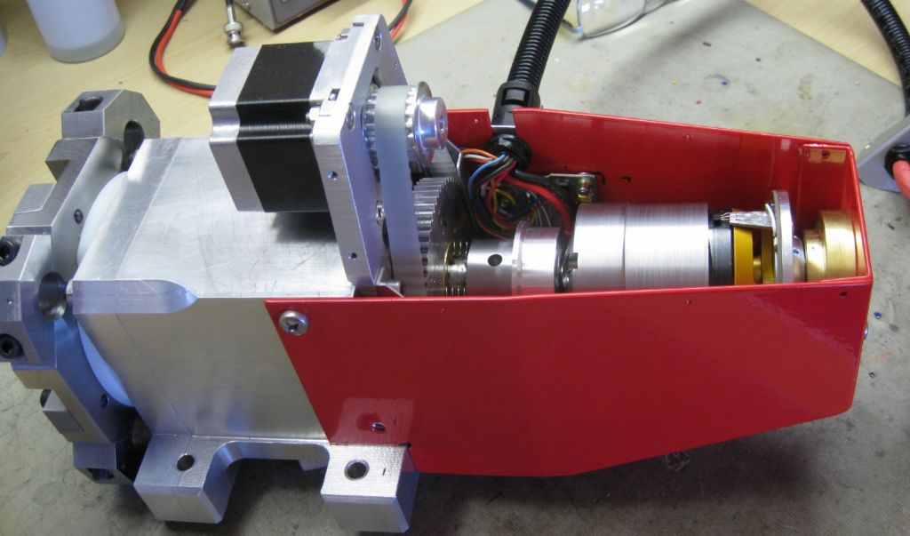

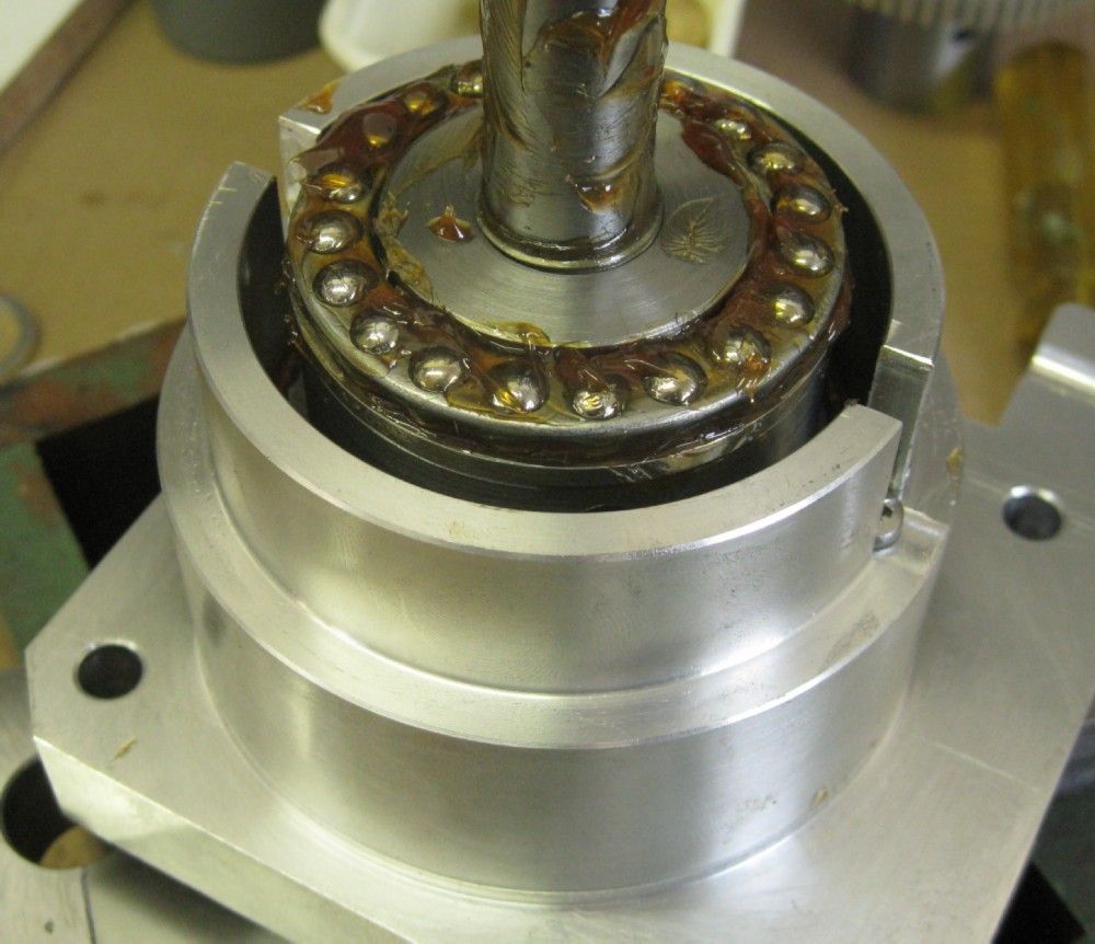

          The ATC is 'complete' – all parts are done and the thing is assembled. I have tested it using a Nucleo with some test code – The Hirth coupling disengages @ 105psi and the stepper turns the tool plate just fine. The live spindle drive also works very well, so all in all I am happy.
          View of the Bellville springs under preload.
          Piston travel limiter installed.

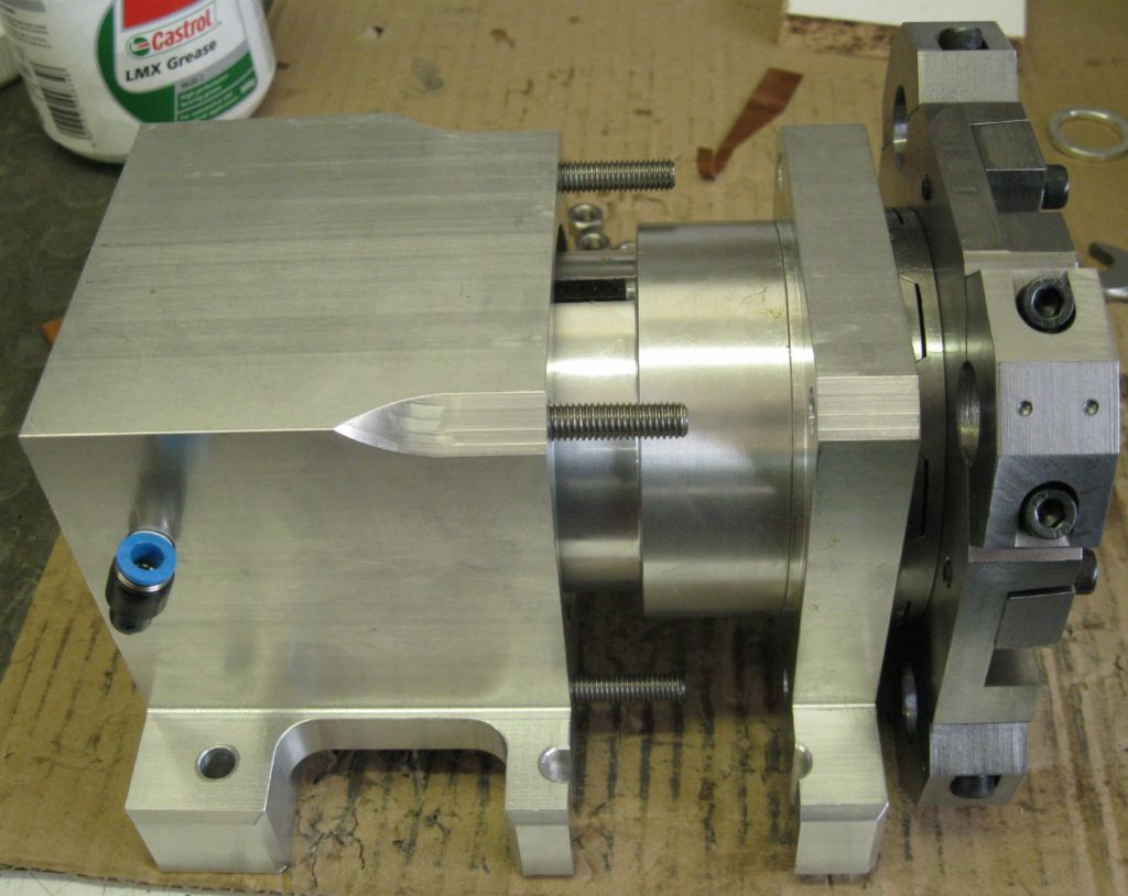

          Piston fitted into the cylinder body.
          Mating all parts together

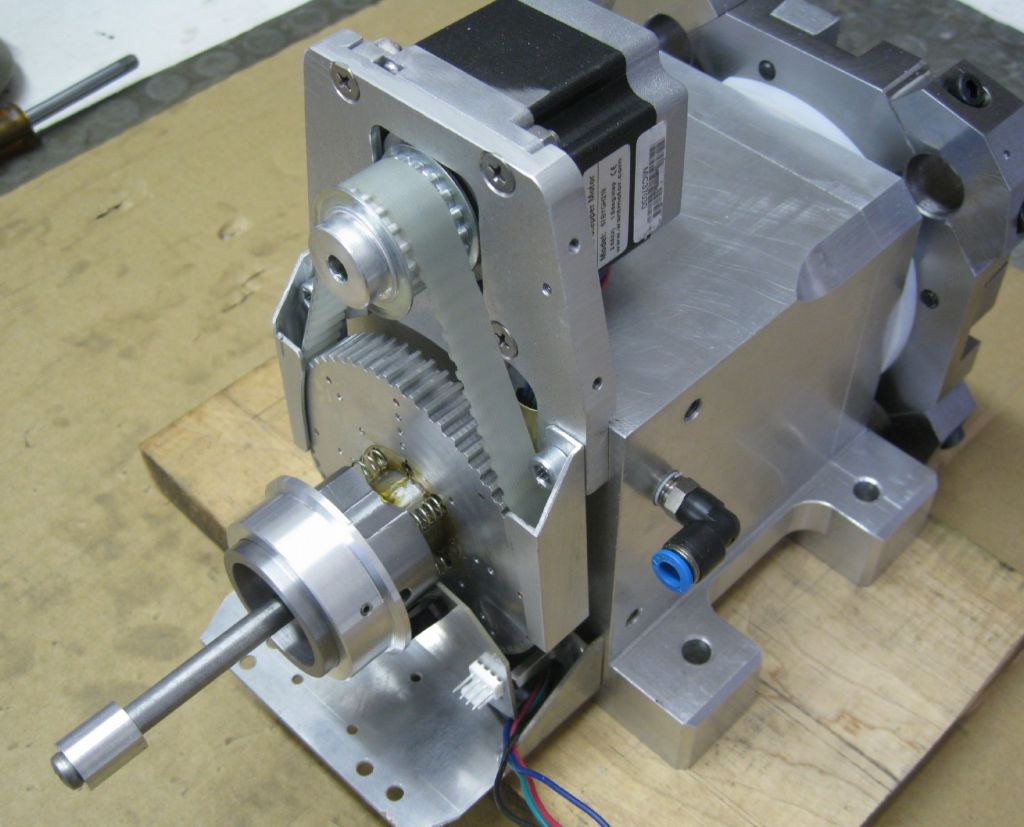

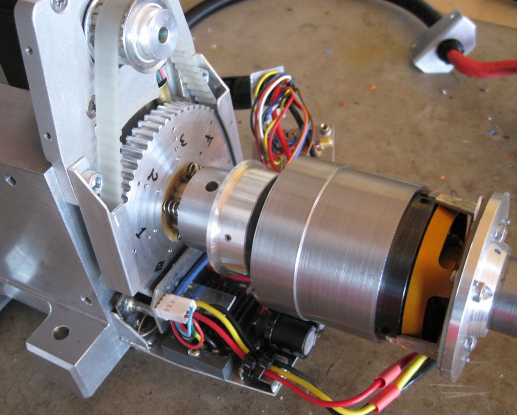

          Live spindle drive shaft installed
          Spindle motor and drive electronics fitted

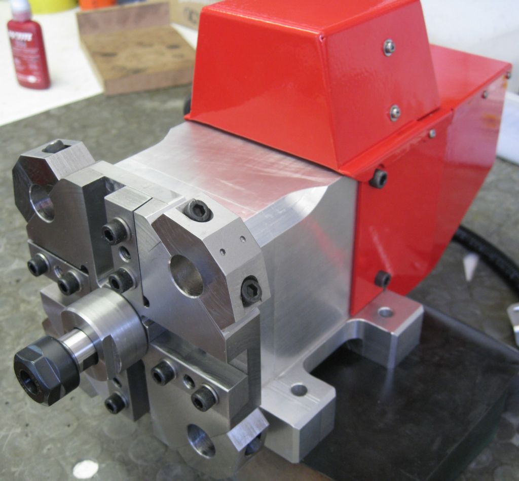

          Main cover fitted

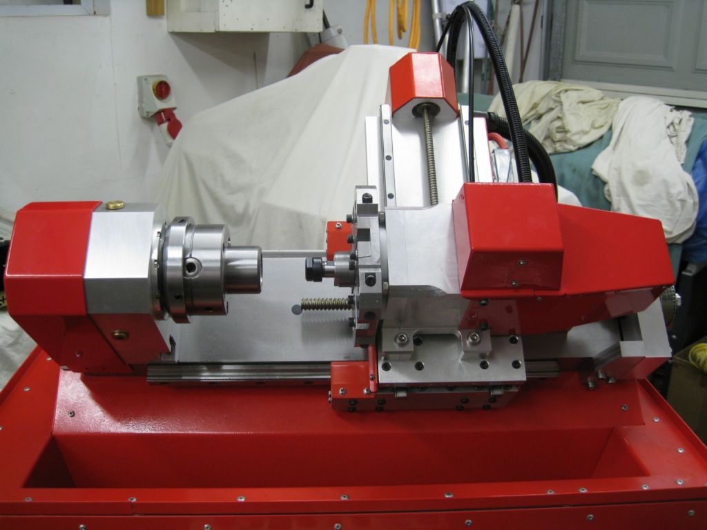

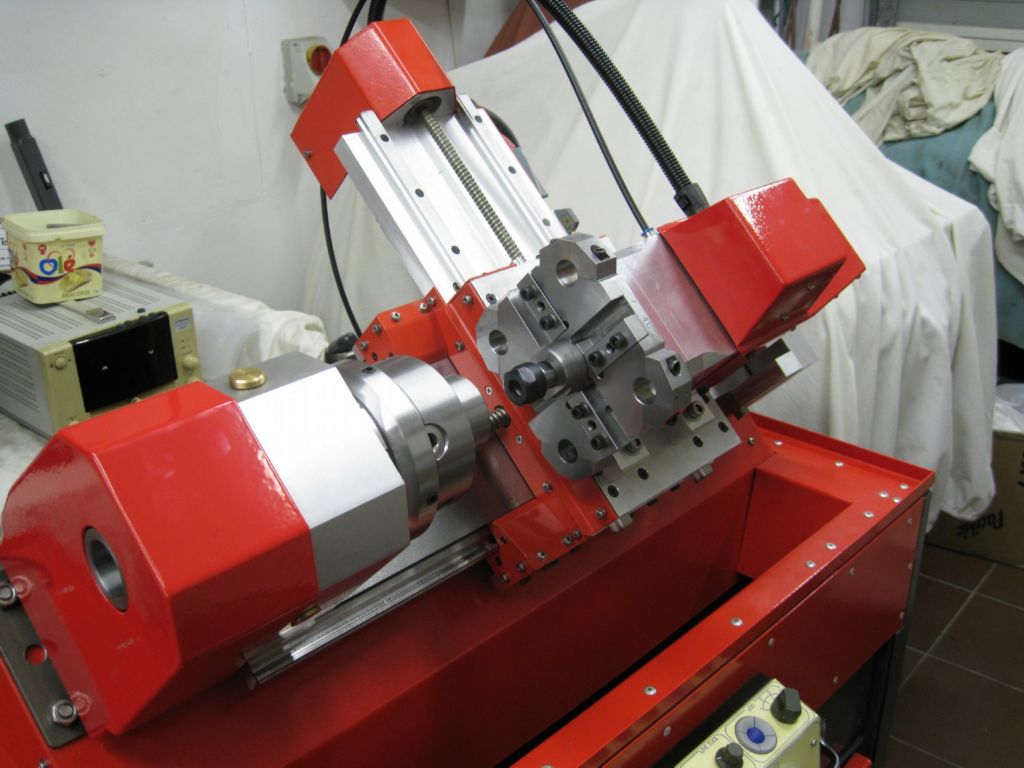

          All covers on, ready to fit to lathe
          Views on the lathe
          Now the big deal is to get LinuxCNC to talk to the ATC, so I am bum on chair and head buried in the mess of LinuxCNC, HAL and that cryptic world!
          Last post on this lathe will hopefully be a video of it working..
          Joe
