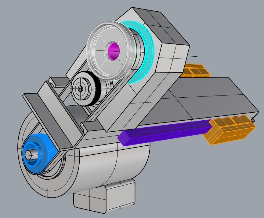

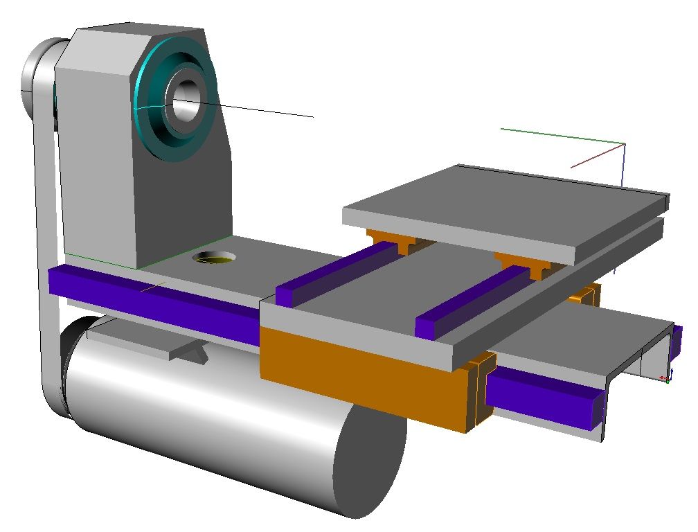

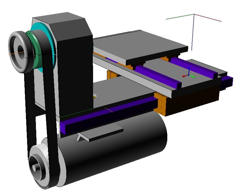

        In between many projects I have a long standing one that I have finally made a start on – A 'small' CNC Lathe, build from scratch, not a CNC conversion…
        The concept started small, an ER40 Collet spindle, 6000RPM capability, sort of 400mm x 400mm footprint…And then it Grew-some… I have a very nice pair of Taper Roller bearing, P5, but Imperial1-7/8 inch ID and thought to use them so moved to a 5C collet spindle. That allowed larger diameter work, so the bed grew to accommodate – to be made from 140mm wide U channel, 8mm thick. The Headstock to be made from a large chuck of aluminium, 7075 – I decided Aluminium is ok, it will conduct heat away easily, and the intended use is intermittent anyway. And so the size of the machine grew to be bigger than what my Mill is comfortable with and the challenge is now there..
        I did some rudimentary 3D design to get basic dimensions, and started by making the spindle and basic headstock assemblies.
        Some renderings of the concepts:

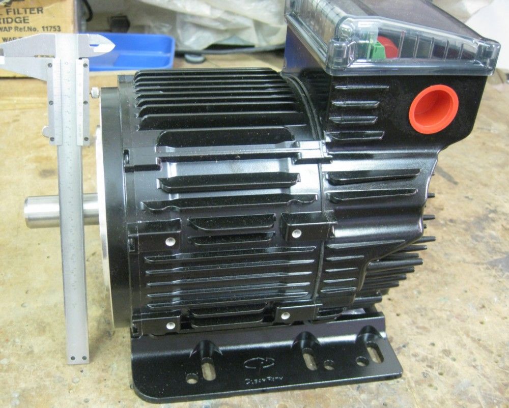

        The underslung motor is a 1KW 80VDC motor – to be driven by a GECKO servo drive with an encoder fitted , ie, a proper servo drive so the spindle can be positioned to any angle, do screwcutting easily, etc. Brushes don't bother me, again, service is not production…and I have the motor and GECKO drive..
        The spindle with end-plate labyrinth seals – spindle bearing will run in oil – I still want 4000 to 5000 rpm out of those big bearings * TIMKEN*..

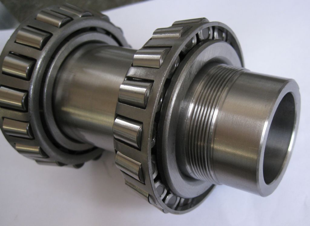

        So, with ideas in hand, The hunt for materials began – here in Namibia, that is a BIG challenge!

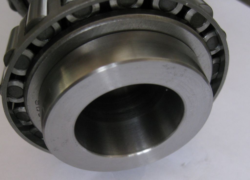

        I found a very nice ( even If I say so myself..) 5C spindle, hidden in a section of broken Rear drive shaft from a large Caterpillar at the local mine vehicle repair 'shop' – I just had to dig the spindle out from the swarf in the shaft…
        Spindle all machined, and ground internally, and externally for a very snug bearing fit. 5C collet end seen here.
        rear or closer end seen here.

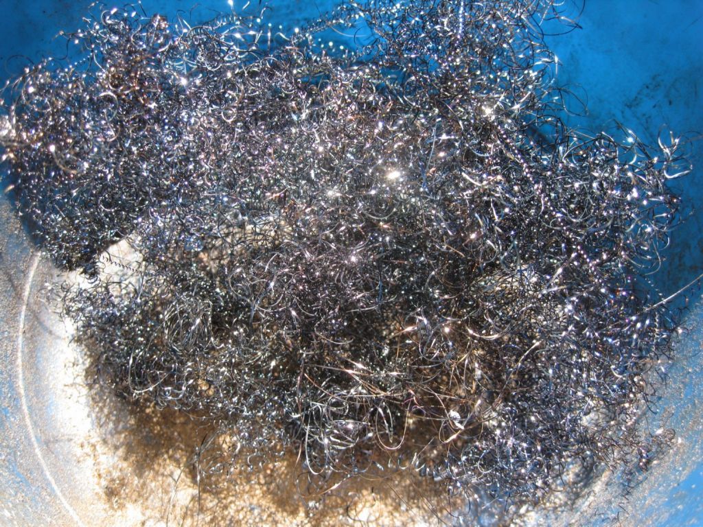

        Was hidden in a few buckets of this nice shiny blue swarf..The swarf came off HOT, sometimes flaming at the cutting edge, with a shiny smooth cut surface – no idea what the steel is!

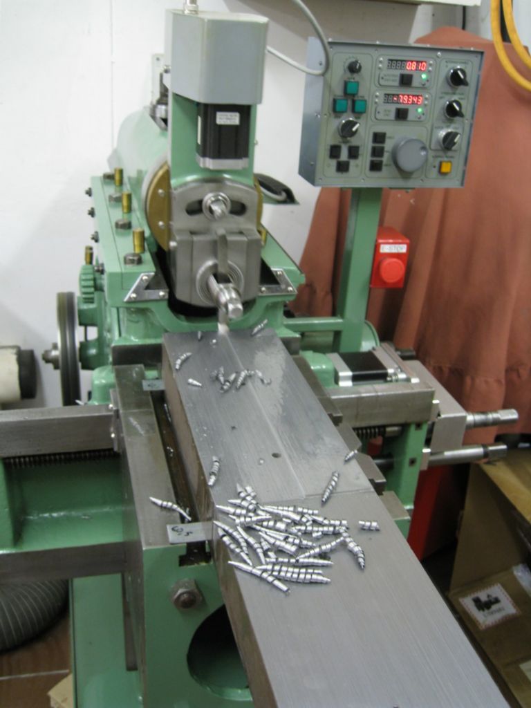

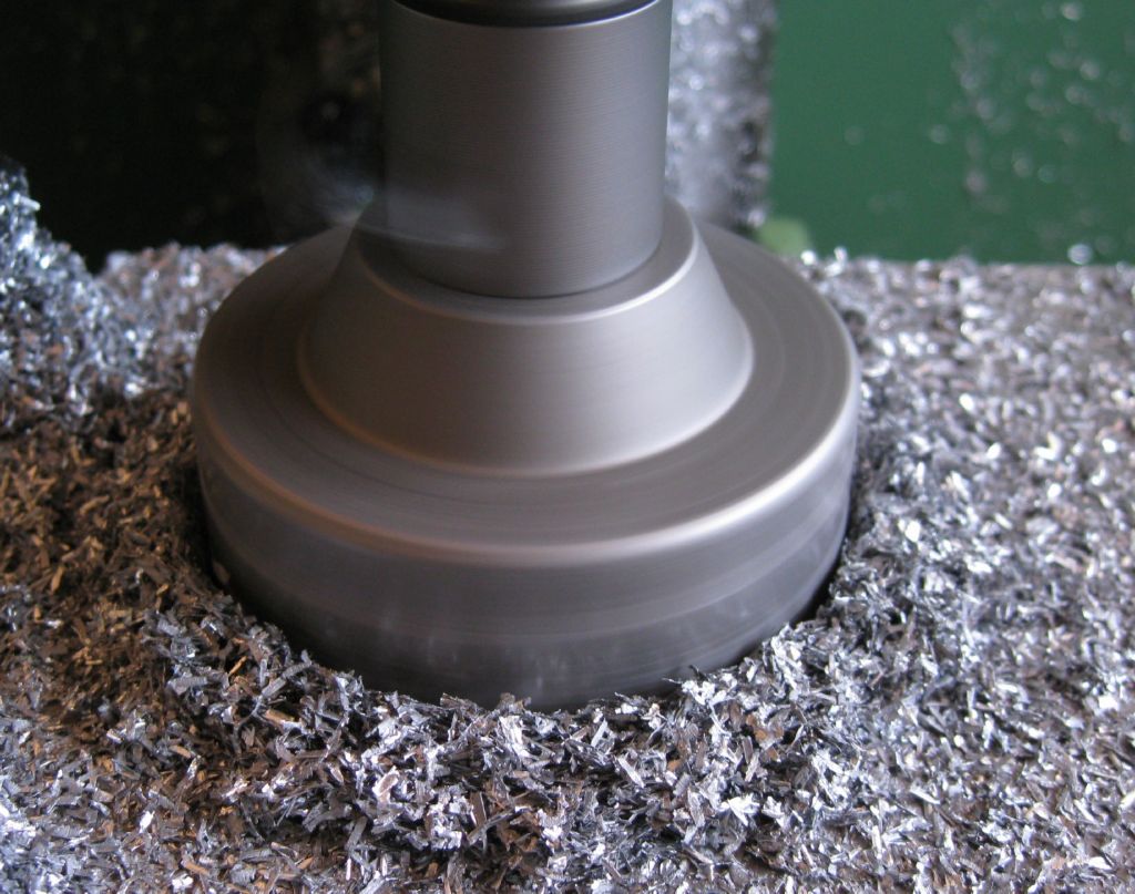

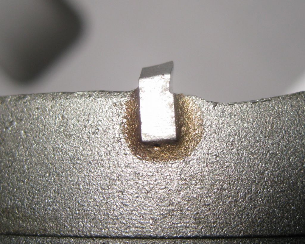

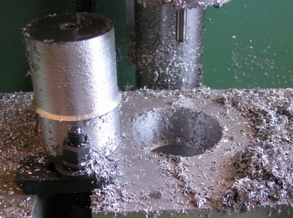

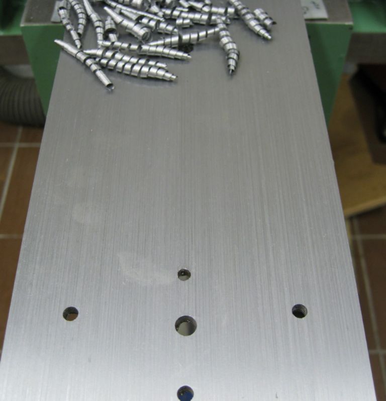

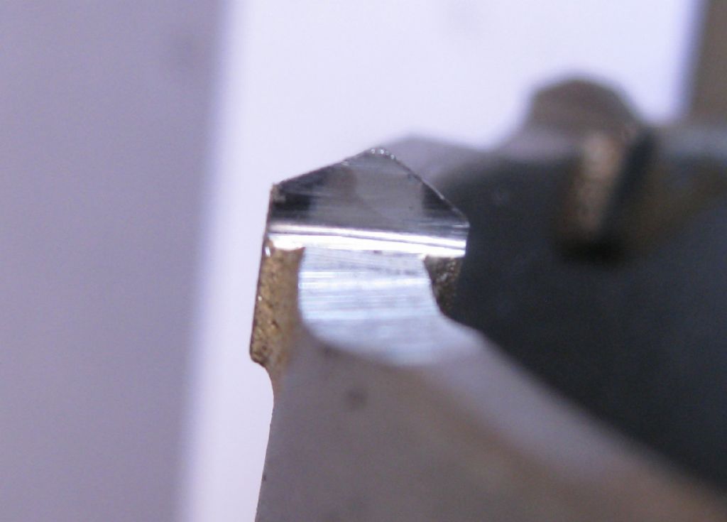

          This is a big block of Aluminium – 150x200x100mm – I need a hole through the 100mm depth, 70mm diameter or so, so tried a hole saw – waste of time – just clogs up and takes forever. Drilling and boring out increasing each time was just too much, so I purchased an SDS drive concrete coring bit – 70mm OD. Turned a MT2 taper on the drive shaft ( very nice steel too, that drive shaft!) and sharpened the cemented carbide teeth on the core bit – gave them a good positive rake. Set up in the EMCO FB2 mill and drilled a core out the block – took 31 minutes…
          SDS Coring bit – with taper machined on shaft
          Teeth sharpened:
          Front view of teeth:

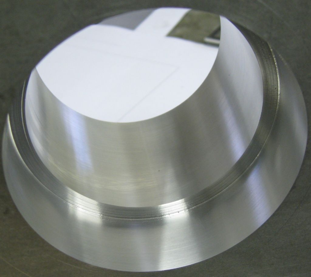

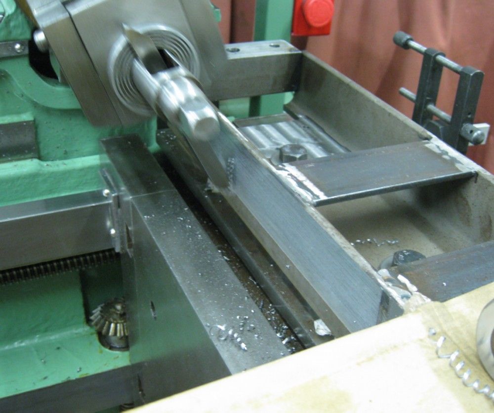

          Making the hole:
          The cored piece..done from both sides – lots of chatter, etc..

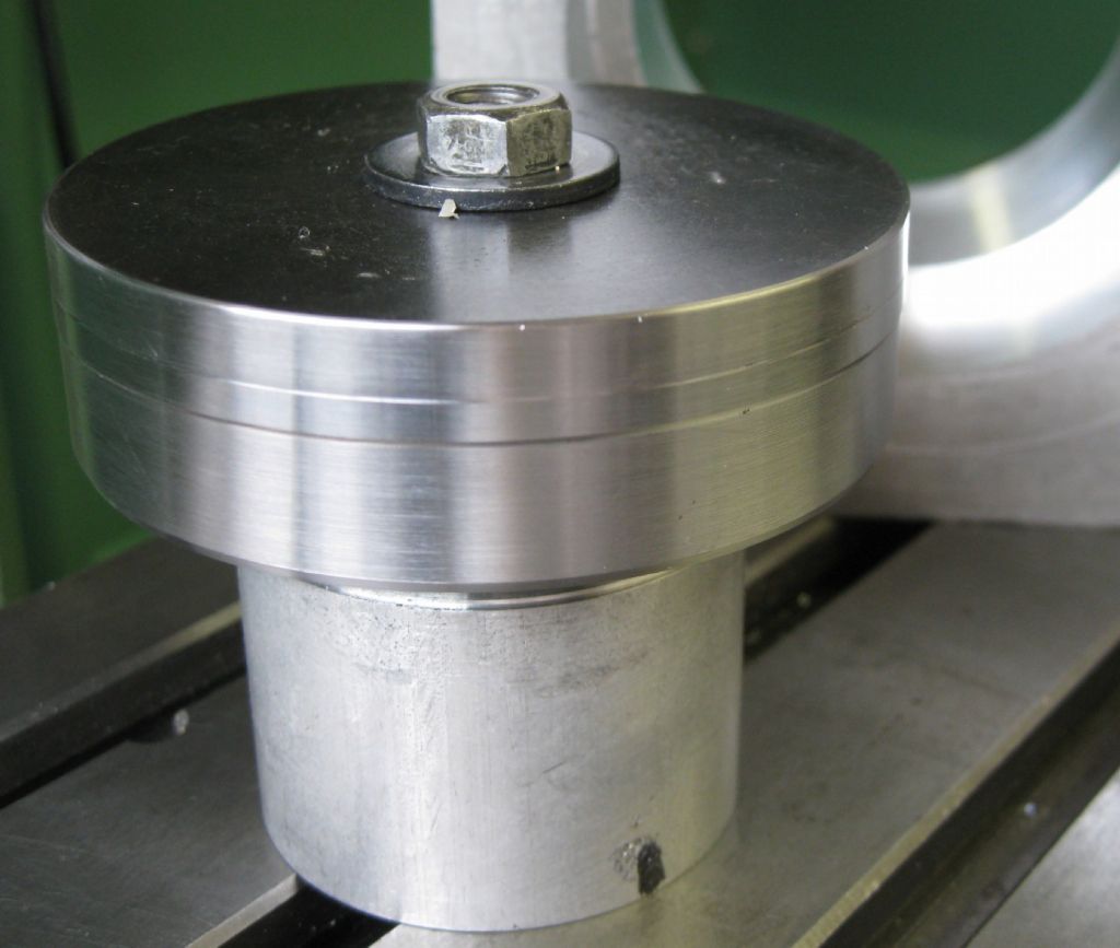

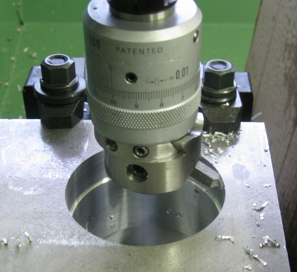

          Then boring out the hole and boring out for the bearings – rough bore first
          The bearing boring had to be done from both sides, and I wanted the holes lined up to better than 0.005mm….
          So a mill tramming took place, which is covered in Graham's FB2 thread – took 2 days with lots of effort – was worth it!
          The idea then was to fit a locating boss to the table, which would snug up into the inner bore. fasten the block down to the table, bore the bearing hole out, and then rotate the block over 180deg, slip over the locating boss, and do the second bearing hole. The boss was made from a hard steel, polished, and 'just' fits in the inner bored hole – it is a real bugger to get the block down on it – cannot be slipped over even a little skew…
          The boss:
          The block slipped over the boss, and checking for center location before final boring of second bearing hole.

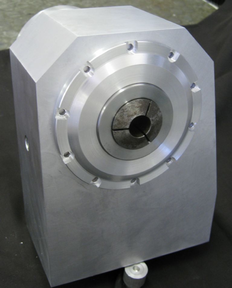

          The headstock block bored out:

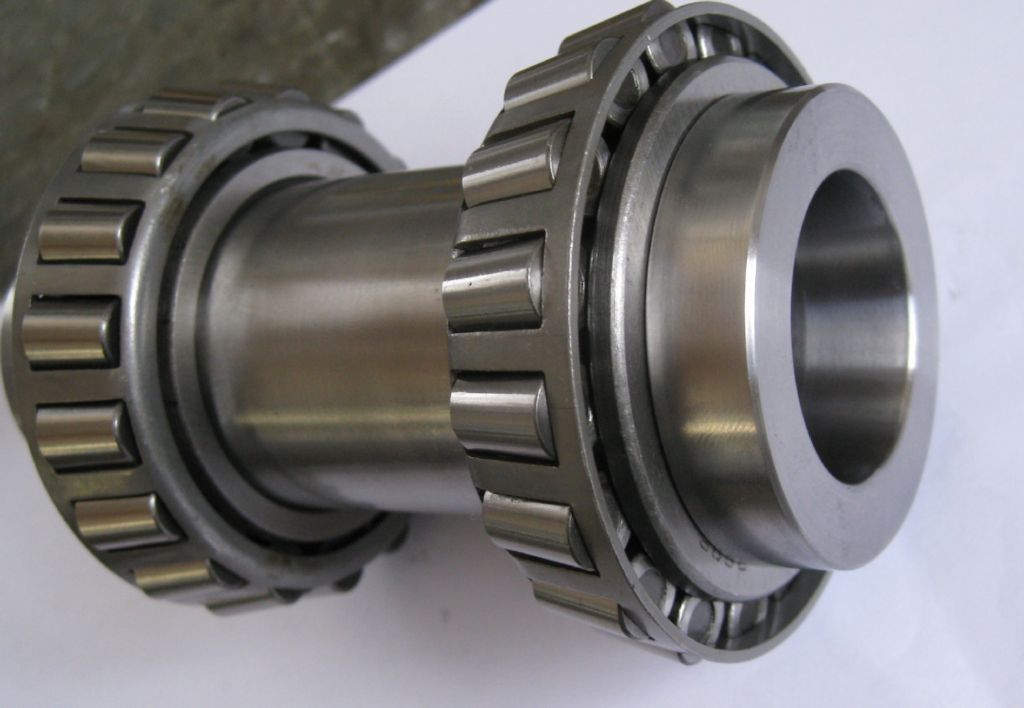

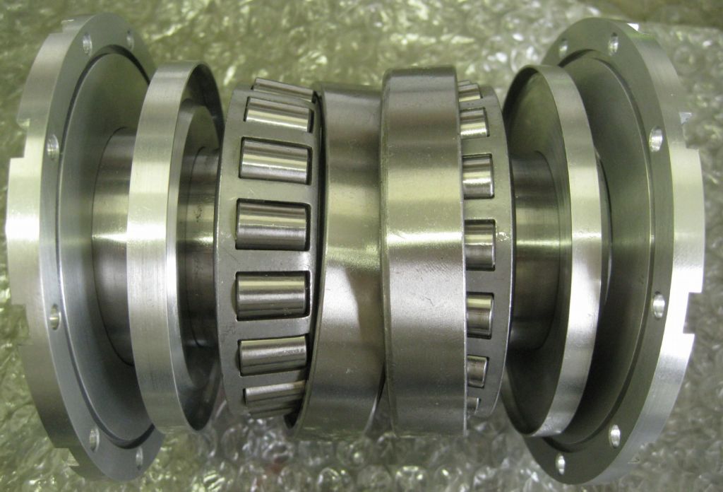

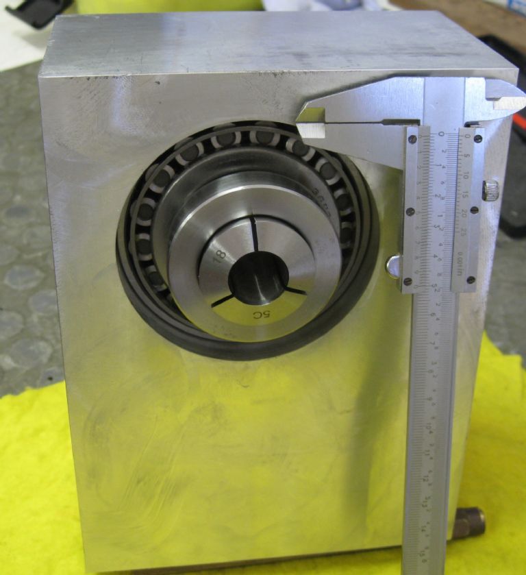

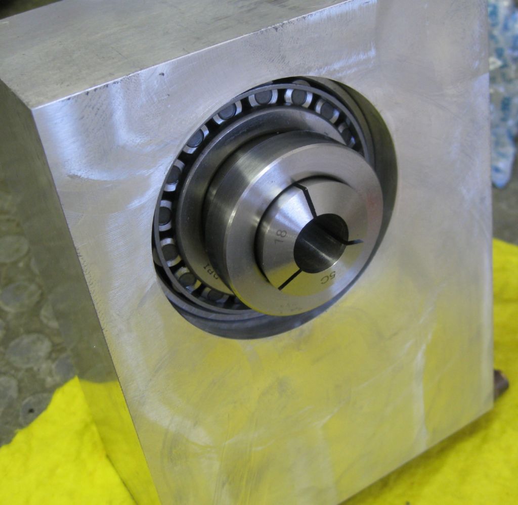

          Bearings and spindle test fit:
          Next up – Labyrinth seals…then the bed – in the shaper and more such fun..

                    Posted by Joseph Noci 1 on 05/11/2020 21:55:20:
                    Now the Headstock…
                    You know the old gauge-maker's trick of making a relief groove a little way along the gauge (=boss) – where the leading edge of the skewed block would try to dig in, as it binds? Gives it somewhere to go, and the leading ring of the gauge, now safely in the block, now helps align the block as it passes over the gauge diameter immediately following the groove, thereby avoiding buggery. [Hope this makes sense – it's late: nurse is getting ready to tuck me into bed…]
                    Distance between bearings looks a bit mean, and drive belt between bearings might be preferable – albeit less convenient?
                    Edited By Kiwi Bloke on 06/11/2020 08:56:45
                    Edited By Kiwi Bloke on 06/11/2020 09:01:36

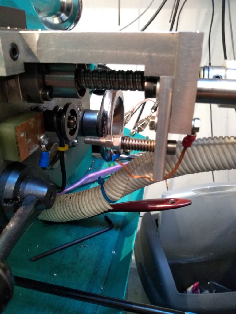

                        Nice project Joe. You have probably though about this, but a precise electrical index on the cross slide so that it can be set to a calibrated position with every tool makes life so much easier. I favour a hard contact rather than a toggling microswitch or proximity sensor – you want micron precision. Then every time you switch the controller on, you zero the cross slide machine coordinate to the index, and can then turn precise diameters using pre-stored tool offsets. It is much easier to design the index in rather than add it later!
                        Another useful option would be an in-built setter for the Z axis to allow you to set the tool to the end of the stock. I have a device based on electrical contact between the tool and stock that does this which requires slipping a sensor over the stock and making temporary connections to the toolpost and spindle, but the sensor could be built in to the headstock. Happy to provide more details if you PM me.

                          Posted by Martin Connelly on 06/11/2020 08:22:46:
                          I would be a bit concerned with the encoder being on the motor shaft and not on the spindle. Any slip or effective diameter mismatch on the belt drive will cause issues with things like screw cutting. The fact that you mentioned the encoder on the motor makes me think this is a turning process you are intending to do.
                          Martin C
                          Martin,
                          You are quite correct – stupid idea – the remnant was still in my mind as I had thought of using toothed belts and pulleys originally, but decided against as that imparts unwanted vibration to the setup when run fast – ditched the idea but not the encoder location..I think that idea was flawed anyway, as even the toothed belts do move on the pulley when reversing, albeit slightly.
                          Kiwi – Bloke..
                          No, I don't – please explain – I am keen to understand that – it seems like it can be a big help! It might not be evident in my photo, but that 'ridge' about 1/3 way down from the top surface of the gauge is the snug fit – the part above and below is 5-6 hundredths of a mm less, and then the 'ridge' is domed, like a torus with the peak diameter being the snug fit – gives some skew leniency, but not much!
                          When you say 'mean' , do you mean close/narrow? The bearings are 40mm apart – that is narrow, but the bearing is also 90mm OD, so lots support in twist – also , its a 5C collet system, so there wont be any 100mm diameter workpiece in this lathe.. The headstock will be oil filled, bearings must run in oil for the speed, so belt down the center is hugely complicated..and I hope not needed!

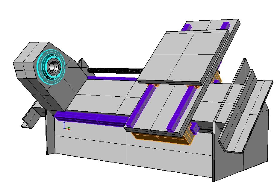

                          The intent with this lathe is to make it a slant bed, with a tool changer, etc…So from the first rendered view I posted, the tool will sit on the cross slide table, away from the viewer – where is the better place for a hard contact reference? away from the viewer, ie, the rear of the cross slide?

                            My contact is a small shim of beryllium copper soldered to the to face of a bit of PCB and mounted on the face of the apron underneath the slide. There's a bracket on the slide attached to the screw bearing plate that carries a spring-loaded stainless steel screw that connects the shim to ground on contact. It has been slightly improved since this picture:
                            I'll try to get a better one. I do need to re-make the contact pad but it has worked flawlessly for a couple of years. On your slant-bed design the end of the slide away from the axis would be best just to keep the swarf away.
                            I basically use the same sensing method as you are proposing but I felt (and measurements confirm) that resistance measurements aren't reliable. My method is to connect the chuck and the toolpost to a current supply that runs about 2 amps between them. When the tool doesn't contact the stock, that current runs through the headstock bearings, the bed, carriage, and back to the toolpost. When the tool is in contact, a significant proportion of the current runs through the stock and the tool – typically about 50% (since the path is quite short). The current can be DC or AC.
                            The implementation I have on my lathe uses 50 Hz AC and senses the current flow using a current transformer slipped over the stock. This drives a full-wave rectifier using a CA3140, the output of which goes to another 3140 as a comparator, giving a logic level to the controller probe input. The probing speed has to be quite low because the sampling rate is only effectively 50 Hz but this isn't a real limit at my speed of working. I use this system for both "end of stock finding" and also via a known-diameter tool setter that fits in the h/s taper for setting up the tool offsets. My Mach 3 has macros for doing both of these, as well as a button macro for "find stock end" on the Manual screen. When I get another photo of the index "switch" I'll get a couple of the tool setter and sensor.
                            I also had a project student 2 years ago who looked at implementing the sensor using a ring core (the same as a current transformer would use), but with a small gap in it and a hall effect device. This worked very well, IIRC needing about 1 amp drive and responding much faster. The HED was a Honeywell continuous-time device with analogue output, with a single op-amp/comparator chip to get enough sensitivity. I haven't actually implemented this on a machine yet (though he tested it on a manual mill).
                            Both methods could be implemented as original fit on a machine, by building the sensor into the front of the headstock and providing slip rings (or just using the bearings) to carry the excitation current.
                            Just to add – the reason for using current sensing rather than resistance is that the current varies from zero before contact to ~1 amp on contact, whereas resistance as you say varies by a small fraction of a small value – so current change is orders of magnitude more significant.
                            Edited By John Haine on 06/11/2020 12:06:35
                            #505588
                            John Haine
                              @johnhaine32865
                              More photos.

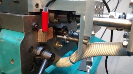

                              Xslide home switch. Permanentt connection from contact block to controller (black wire). Earth braid to contact screw, which has rounded contact end. You can just see the BeCu shim on the copper surface of the PCB.
                              Setup for setting tool offset using current sensing. Tool setter in MT4 taper has two reference diameters at the end. The larger one is ~20mm diameter, smaller ~6mm. Once side of supply via 4mm banana plug to tool setter, the other via big clip on the tool holder jack screw. The 20mm is used for external tools, the 6mm for boring tools (entered as -6 mm as the tool approaches it in the + X direction. You can see the black resin block in which the current transformer toroid is potted with a hole in the so it slips over the work of the setter.
                              This is the sensor. Started as an RS components current transformer with a core in a plastic surround. I removed that case, made a little cardboard box lined with Mylar tape with a slightly greased mandrel in the middle, set the core with a screened lead soldered to the wires in the box, and poured in potting resin. Then removed the cardboard when set and pressed out the mandrel.

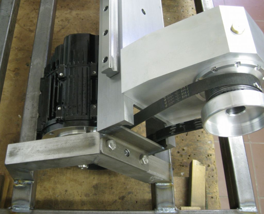

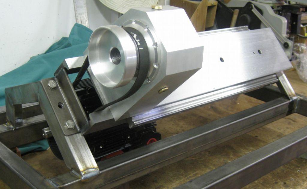

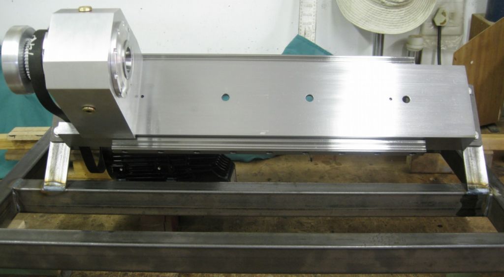

                                          Some Progress on the lathe – Headstock is mostly done. Oil plug and breather hole still to do, and then pulley and collet closer..
                                          The Lathe Concept slowly solidifying as well:

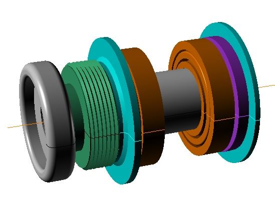

                                          Exploded spindle with oil flinger rings and face flanges

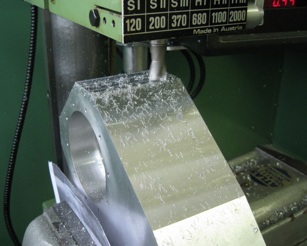

                                          Milling the headstock:
                                          Drilling / Milling out the Face Flanges on the Automated Rotary table

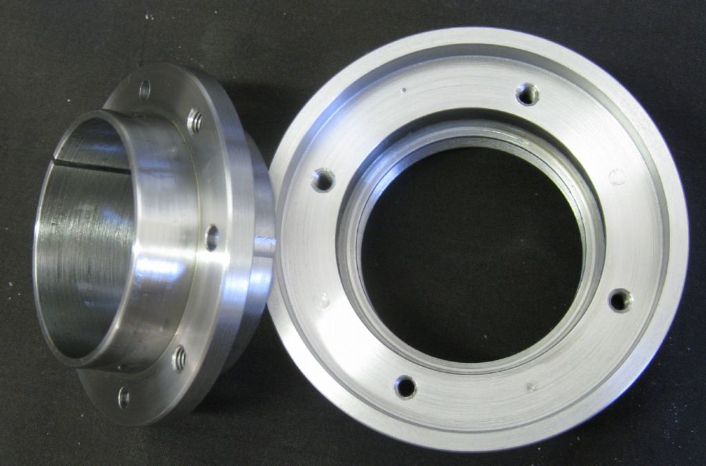

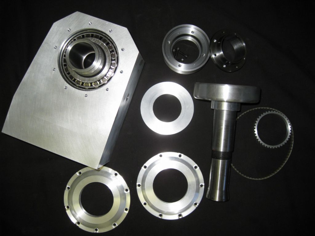

                                          Headstock parts ; Spindle, flingers and face flange ( seen from O ring oil seal side, below)

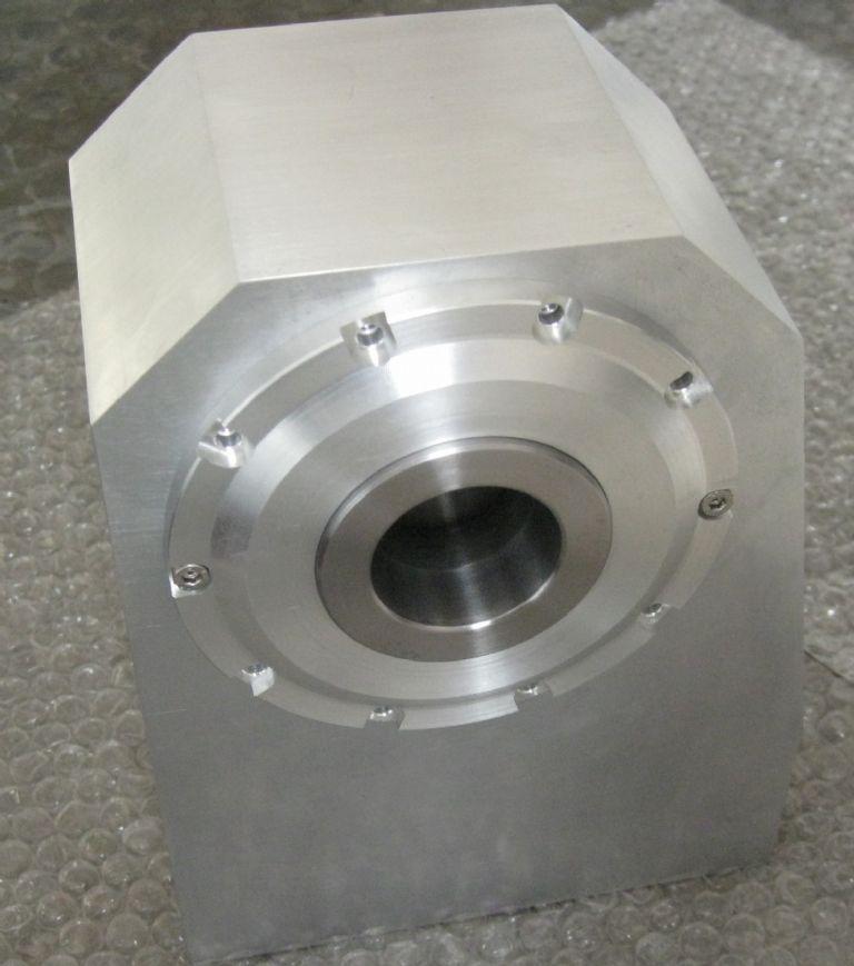

                                          Assembled Headstock, collet end.
                                          Test assembly Headstock, drive end.
                                          More in a few weeks..
                                          Joe

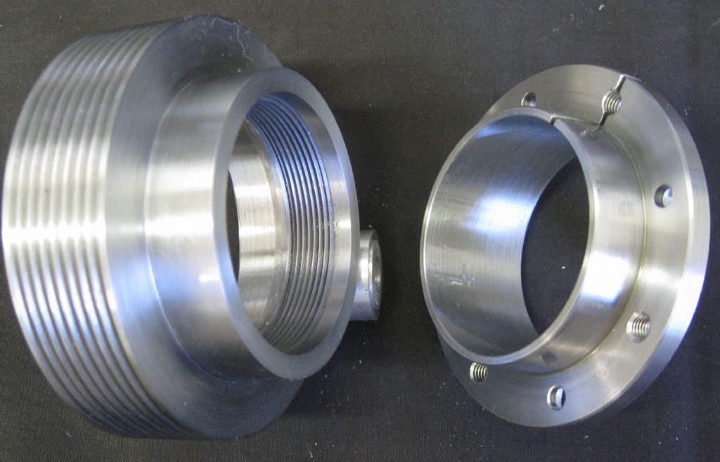

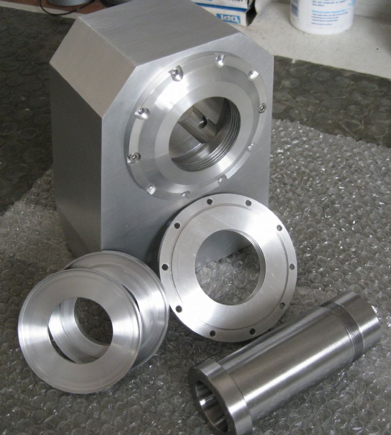

                                            Mostly focusing on the Headstock at the moment – It defines a number of downstream dimensions and implementation choices, so better get it done…
                                            Here is the Headstock model: ( I have not shown all threads, holes, screws, etc – they are turned off)exploded headstock model.jpg
                                            1 and 6 – End labyrinth oil seal covers.
                                            3 Headstock body, with spindle (4) inside.
                                            2 and 5 – end oil spinners.
                                            7 – Spindle/ Bearing preload 'nut', combined with 20mm Sheave pulley
                                            8 – Taperlock for item 7
                                            9 – Toothed pulley for spindle encoder drive belt
                                            10 – 5C Collet closer.
                                            And here are photos as made.
                                            Business end of Headstock, with a crappy collet in place..Center height is 150mm
                                            The Pre-load 'nut' / Drive pulley with taper lock. Matl – Mild Steel
                                            Where the pulley goes…
                                            Pulley fitted with taperlock and encoder drive pulley in place. Sheave Pulley is 80mm diameter.
                                            Drive belt fitting

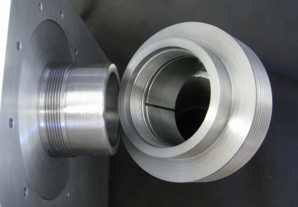

                                            Collet and Closer ( Handwheel is 102mm diameter, Through hole is 28mm) Closer Matl – mild steel, handwheel Al
                                            Next is to start on the bed – That is a big problem – the bed is 700mm long ( 'active length' = 580mm) and cannot be flattened on my mill – the mill is too small. Likewise, too long for my 14" shaper….Maybe a nail file…
                                            Joe

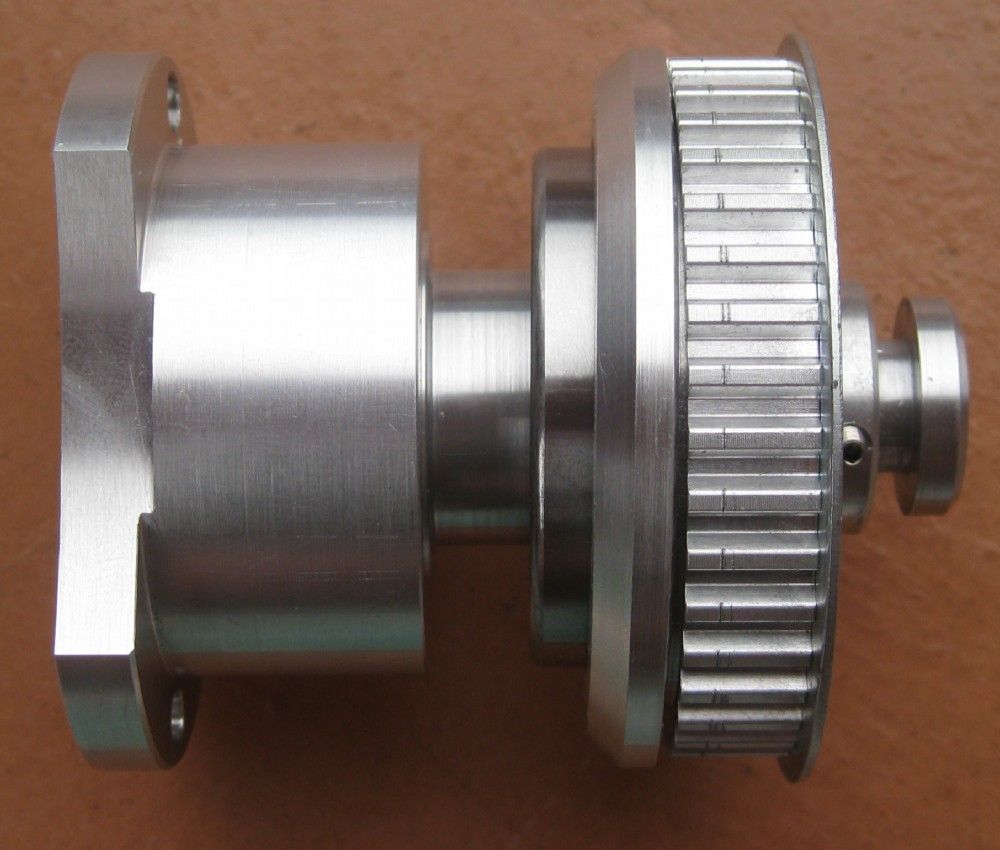

                                              Completed the ABZ Spindle Encoder assembly – using a magnetic encoder chip. The encoder is sat between the spindle drive belt, below the spindle assy in the above render.
                                              Below the encoder parts – the toothed pully is 60mm diameter for scale reference.
                                              Encoder partly assembled to test for fit before locktite of bearing.
                                              Assembled Encoder – magnet shaft held in place with 3xM3 grub screws.
                                              A similar pulley on the spindle shaft drives the pulley on the encoder in a 1:1 ratio.
                                              Encoder chip on PCB, sits flipped in the cavity shown, chip over the magnet seen in the cavity.
                                              Encoder gives 1024PPR, or 4096 edges, with an index.
                                              Next up, the actual Lathe bed – bed is quite long, too long for my small Emco mill, and longer than the shaper stroke, so it was done in 2 halves on the shaper – that was interesting, to ensure ram alignment to the 1st half done…Judicious use of the dial gauge on the shaper Ram over its full stroke paid off – the finished bed has just been checked by a local Line-Boring company, on a granite table, and it would seem we are better than 0.01mm in width across the bed, and the sides are parallel to better than 0.01mm ! Blueing the bed flat top on the granite table showed contact over what looks like more than 95% of the flat surface. Some photos of the bed to follow in the next installment!
                                              Flattening the bed top:
                                              And then the sides:
                                              Next up, the finished bed, and the bed base and mounting starts..
                                              Joe

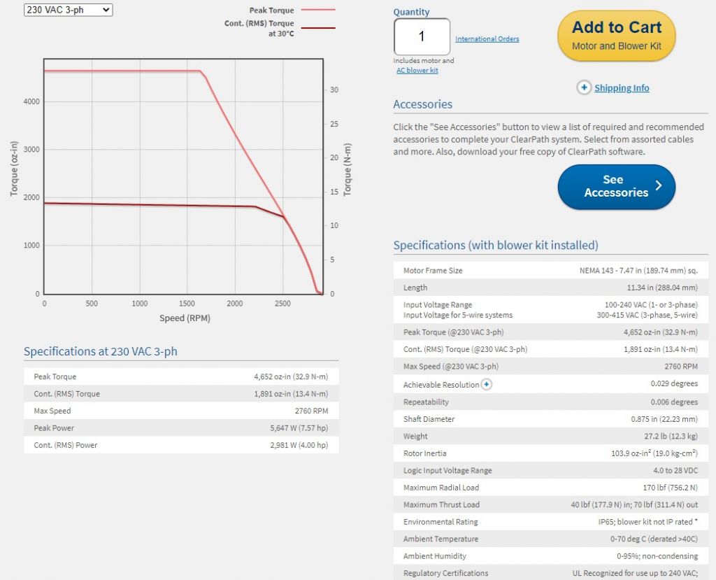

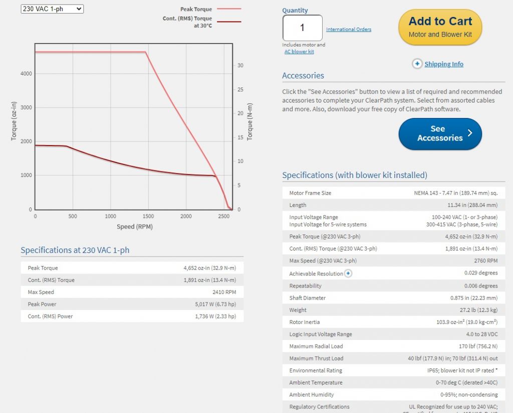

                                                  The Lathe bed turned out well, and the base framework is also started – The exercise now being to get the spindle motor positioned with regard to the drive belt, spindle, and motor tilt mechanism. The latter required as the motor will be fitted with a dual sheave pulley, one of 120mm OD and the step below , 80mm OD, giving max spindle RPM of 4000RPM and 2700RPM resp. I am hoping ( torque calcs indicate it is possible) that I will get away with just the 120mm pulley, and still have enough torque at low RPM's – sort of around 20RPM for some 'heavy' cuts.
                                                  the Motor specs 1PH and 3PH:
                                                  In the event that the smaller pulley is needed, the motor needs to be able to pivot to take up the belt slack, and the motor must slide back 20mm, to line the 80mm pulley up with the spindle pulley – this all to be a one lever movement exercise…
                                                  The motor is big for the lathe – 1.7KW @ 220VAC 1PH, and 2.9KW @ 230VAC 3PH.
                                                  It is a rather special motor – permanent Magnet rotor, and is actually a very high power closed loop 'stepper motor' dead silent in operation, no noise, no step feeling, etc. It is in essence a AC servo motor, driven by step and direction input. It is a closed loop control, with a 32000 count encoder.
                                                  The reason for using this motor is that it has full torque from 0 RPM and maintains the torque well up the RPM curve, esp if fed with 3Phase. In addition to driving the spindle for conventional turning, it serves as the lathe's C axis, with rotational position control capability to within 0.08 degrees, allowing use of live-tooling in the lathe to 'mill' the workpiece in the chuck ( Hex heads, High pitch 'threads' and anything else…) Holding torque is very high, so medium milling should be possible, and low speed toque is high, allowing full 'power' at low rpm's.
                                                  Below – The bed trial fitted to the base framework –
                                                  lots of effort went into straightening out the base frame after welding, all checked on a granite table..
                                                  The Lathe bed is as flat as the proverbial pancake, and once the base frame was straight, the lathe bed side supports were bolted to the bed, and then the side supports tacked onto the base frame. The welds were then tackled in short steps, alternating left/right and obliquely to help prevent the base frame from distorting. It Worked!
                                                  See how nice the bed shaped up!
                                                  The slides are 25mm square – nice and beefy..
                                                  Lots to do before the next post, so that may be in a good few weeks time!
