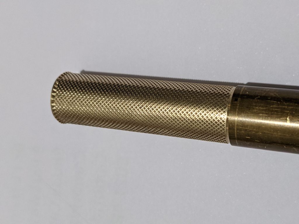

      The recent thread on knurling tools triggered me to go back to a project I had in mind to try knurling on my CNC mill using the rotary axis.
      I wrote a little spreadsheet to generate the g-code. Basically it uses an engraving cutter to mill a spiral groove along the workpiece whilst rotating it – initially for simplicity I'm making it move for one full lead while rotating 1 turn. On a half inch bit of brass that's ~41mm lead The cutter has a 90 degree point with a small flat (basically a PCB engraver). Hare are some pics of the first trial.
      Came out quite well though it took a long time – just over an hour. I wound't want to do it much faster as the spindle speed is a bit low (~6000 rpm) for the cutter. Also the depth of cut is slightly too large as I forgot the flat on the end of the cutter, and the number of "teeth" could probably be reduced. Sufficiently good though that a better "wizard" that can generate shorter knurls is probably worth writing, though the calculations are more involved. I now have some knurled bar to make a small batch of thumb nuts!
      Mod edit: rotated photo.

        #561488
        Ian Johnson 1
          @ianjohnson1
          That turned out nice, the crests look sharp and well formed.

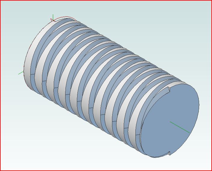

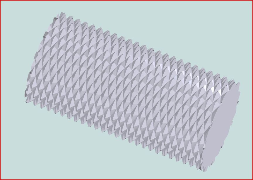

                        From a previous thread trying to do it on a lathe is not ideal a syou need a faster helix more like 0.25tpi for a 1/2" piece of stock.
                        These sketches were doen at the time, left and right hand cut at largest tpi on thelathe
                        Same thing but with multiple starts gives very long diamond shapes
                        But if you can increase the lead the single left and right cut looks more like thios
                        and with multiple starts you get the usual pattern from wheels with 45deg teeth
                        If you have CAD then it's quite easy to play about with the depth of the Vee cut, helix angle and number of starts so you get a pointed crest.

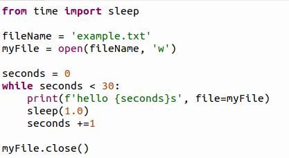

                                    Posted by DC31k on 06/09/2021 14:18:52:
                                    Could I bang the drum a little for learning a programming language (e.g. Python) for this task?
                                    I'm looking further into writing a wizard for this – not a true wizard since it won't run inside Mach3 since I don't want to lose it when my Mach3 PC finally collapses and I move to a different CNC package. Also don't want to tie the code to a superannuated visual basic (not even Microsoft's). So I think Python, I've done a little bit of Python programming and I like the language. So what I want to do is to write code that asks for input parameters such as diameter, knurl length, and number of teeth, plus a few other things, and generates the g code as a text file. I have written code that writes data to a csv file but don't have experience with text files in Python.
                                    I know there are Pythoneers here, could anyone point me at or otherwise give an example of code that writes to a text file? I'd rather have an example to "be inspired by" (= copy!) than links to tutorial stuff, since the latter in my experience assumes Python knowledge I don't have!
                                    Thanks in advance!
                                    #562038
                                    Dave S
                                      @daves59043
                                      This is microPython, rather than Python, but the file handling is the same IIRC.
                                      file writing on a pico
                                      The code snippet (culled from that link):
                                      #This writes whatever is passed to it to the file
                                      def WriteFile(passed):
                                          log = open(LogFileName,"a&quot #open in append - creates if not existing, will append if it exists
                                          log.write(passed)
                                          log.close()
                                      should help

                                            Posted by John Haine on 09/09/2021 11:01:29:
                                            Thanks in advance!
                                            Not that it matters for small files, but Dave's example is slow because the file is opened and closed for each append. As open and close are expensive operations involving the operating system in permission checks and resource management, it's usual to open files once at the beginning and close them only at the end.
                                            My example writes 30 'hello' lines to a file once per second. It uses print() rather than write(), which I pedantically reserve for binary output. Omitting file=myFile, or setting file=sys.stdout, writes to the screen, which is useful whilst debugging.

                                              Thanks Martin. The code I used from the spreadsheet, using a subroutine, is this.
                                              G00 X1 Y0 Z67.595 (Start position)
                                              G91 (Incremental)
                                              G00 A5 (Take out angular backlash)
                                              F100
                                              G01 Z-1.492 (Apply downfeed)
                                              G01 A360 (Cut groove)
                                              G00 Z1.492 (Lift tool)
                                              G00 X40.898 (Move for other groove)
                                              M98 p2000 L42 (Call helix sub)
                                              G00 X1 Y0 Z67.595 (Start)
                                              G90 (Absolute mode)
                                              o2000 (Helix sub)
                                              G91 (Enter incremental mode)
                                              G01 X-39.898 A360 (Cut helix at current depth)
                                              G01 X39.898 A360 (Cut back to start)
                                              G01 A8.571 (feed one tooth)
                                              M99 (Return)
                                              One thing to try to avoid in this is long positioning rotations of the A axis which take a long time. This is avoided in my code in this case by making 360 degree rotations as part of the cut but I am aking a long knurl for demo purposes. I've realised that if one slightly constrains the problem one can make shorter knurls with no re-positioning of the rotary axis at all. The subroutine though only works as long as the controller supports them – Mach 3 does but GRBL for example doesn't, so I'd like to produce in-line code as you have which has no looping or branching. Still I think one should need only twice as many G-code lines as there are "teeth" around the knurl except for a few extras at the start and end.

                                                Thanks Dave. Does "print" put a newline after each instance or should that be added? And I notice you are using a "w" method, would it be better to use "a"?
                                                #562074
                                                Dave S
                                                  @daves59043
                                                  w is write, and will trash an existing file of the same name, a is append – so open if the file is there and write to the end, otherwise create a new one.
                                                  It makes little difference if you are creating the whole file at once.
                                                  My earlier example was for a rolling log file, where you actually want to keep the existing data – just the handiest example I had around.
                                                  edited to say I think in Python there is an implicit newline in a print

                                                      By default print() terminates with end-of-line
                                                      It can be turned off, or changed to something else, by adding an end parameter:
                                                      print('hello', end = ""    )  # end-of line is nothing
                                                      pesky smiley!
