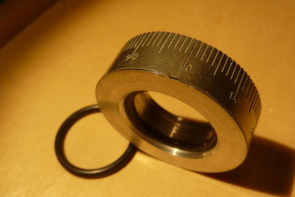

                  For small machine dials I've also had some success using photo etching (by PPD in Scotland) to make a 10 thou thick nickel silver dial which is then rolled and closed up using a simple lap joint. The core of the wheel is made to be a snug fit inside the dial with a groove to make room for jointing splint. In this case I was lazy and arranged the diameter so that the circumference was exactly 100mm. It's only really viable if you need some other stuff etched and have some spare space on the sheet though.

                      No probs. Do read the other threads about the MF70 if you are thinking of going down that route though – it is a small machine and will only take small cutters and do small sized work. CNC conversion is a project in itself.
                      If you want to do nice serifs like Jason then you need to eliminate any uncertainty in the 'Z' direction – that means dealing with backlash, making sure the job is held properly flat and also having smart enough software to drive it. I have not yet aspired to those levels – most of my work can cope with a a tenth or so of a millimetre of uncertainty in 'Z'.
