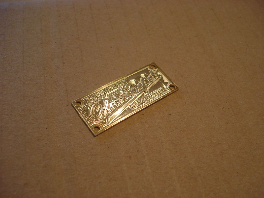

      I have been exploring CNC engraving on my Denford Easimill and have made myself a spring loaded tool holder. This is essentially a spring loaded mounting for the Axminster Power Tool centre heavy duty flexible drive which I found a recommendation for as a sounrce of a few tens of thousand rpm.
      I am using 1/8″ dia shank engraving tools sourced from Ebay and would like to get  an idea of how strong the spring should be. I read the MEW article on a spring loaded tool holder for engraving but it did not give an indication of the strength of the spring.
      Anyone got any ideas?
      I will put anexample of some engraving in amongst my photos…..
      Ian

              Thanks for your thoughts. The thin brass I used for the dash board badge was clamped down onto a piece of wood which gave a somewhat eneven surface – I had three passes at engraving it getting down to about 10 thou in total from memory. The first pass was a bit hit and miss as the brass was not completely flat, partly as a result of the clamping method and partly as a result of it being cut out of a bigger sheet with snips. Note that this was with a tool in the normal spindle. Going to a spring loaded tool was hopefully going to allow me to get the engraving done in one pass.
              Have a look here to see a commercial offering http://www.2linc.com/engraving.htm
              I had a go with my spring loaded tool on the end of a reproduction Best and Lloyd oil pump plunger – the “happy man” logo has to go onto a domed knob. I was not confident enough to set the cut depth to .1″ say and let the took find its own depth as it traversed across the domed surface.
              Have you any feel for whether the spring should be “strong” or whether I should be able to lift the tool with one finger for example? Perhpas I have to just risk an engraving tool and “suck it and see”.
              Ian

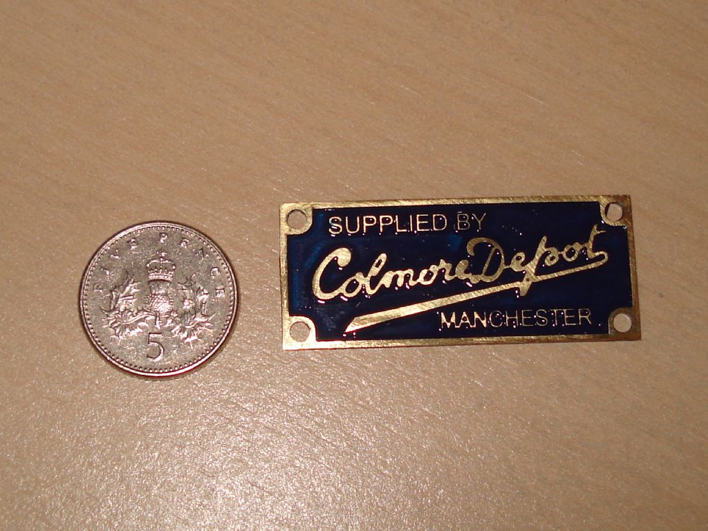

                    Just looking back at this post I thought it would add interest if I added a photo of an engraving project. This is a reproduction dash board badge made on the Denford that now adorns my Morgan.
                    This shows it after engraving (milling really) before painting.
                    Ian

                      I noted that you said that you “clamped” down the brass sheet.  Why not use double sided tape to stick it onto mdf and clamp that down?   It should be quite flat then.  Double sided tape will withstand the cutting forces easily for this kind of work.
                      Terry
                      #52935
                      IanH
                        @ianh
                        Well, no good reason for not using doube sided tape really – I have used double sided tape in the dim and distant past on something or other but found it was less than happy with coolant around so I have not used it since. There was no coolant on this job of course but I didn’t consider tape. I will remember this for next time.
