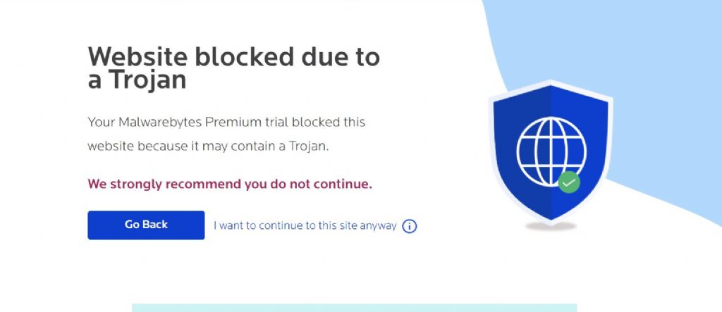

                        Anyone had a Malware TROJAN  Warning when using the Sieg CNC Catalogue thingy link an earlier reply ?

                          Emgee
                            @emgee
                            Malwarebytes screenshot when using the Sieg link in the above posts. Emgeemalwarebytes screen capture.jpg
                            #485527
                              Posted by Emgee on 13/07/2020 23:04:13:
                              Emgee
                              Not I

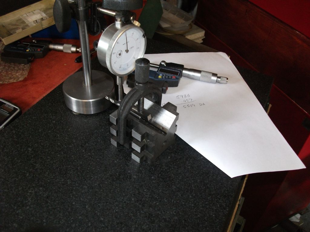

                                          Posted by Andrew Johnston 13/07/2020 22:13:49
                                          Quite so, but even measuring a cutter diameter is non-trivial. In theory
                                          an even number of flutes can be measured with a standard micrometer.
                                          But it's not easy to determine if the flutes being measured are precisely
                                          in line with the measurement axis. An odd number of flutes is more
                                          of a problem. Of course one can buy flute micrometers for 3
                                          and 5-flute cutters. A quick search found a Mitutoyo 3-flute
                                          micrometer on sale at the bargain price of £224, plus VAT of course!
                                          Hi Andrew
                                          I use much simpler methods for doing this as seen here in the photo.
                                          With the cutter mounted in a vee block the relative height of the shank
                                          and the highest point of any cutting edge enables the cutter diameter
                                          to be calculated.
                                          I would normally do this at the time the cutter is sharpened as the
                                          cutter can be rotated on the machine about its center and measured in
                                          this way , if a specific size is required since the diameter is known it
                                          is a simple matter to regrind to the required size.

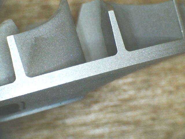

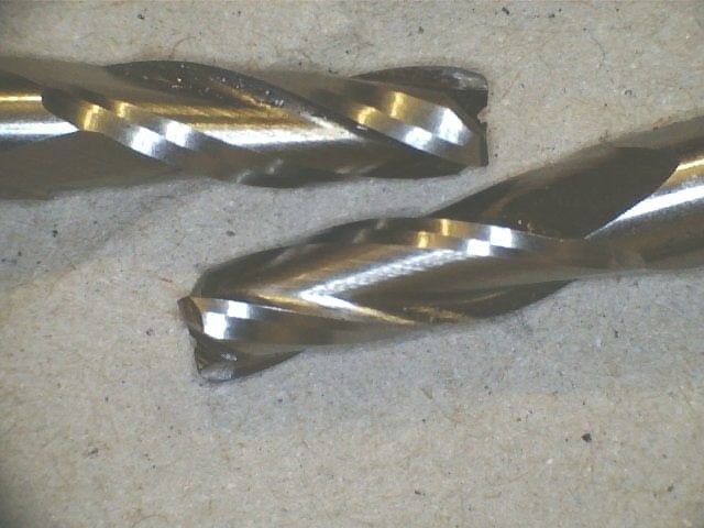

                                          The real fun starts if a tapered cutter is ground since there is no reference
                                          diameter, a small test piece is cut to work out the relative center distance
                                          at the full cutter depth.This pair of 6 mm cutters were reground at approx
                                          3 deg taper and 1 mm radius edge to cut the vanes on this turbine
                                          compressor wheel.
                                          Tapered cutters
                                          Compressor wheel
