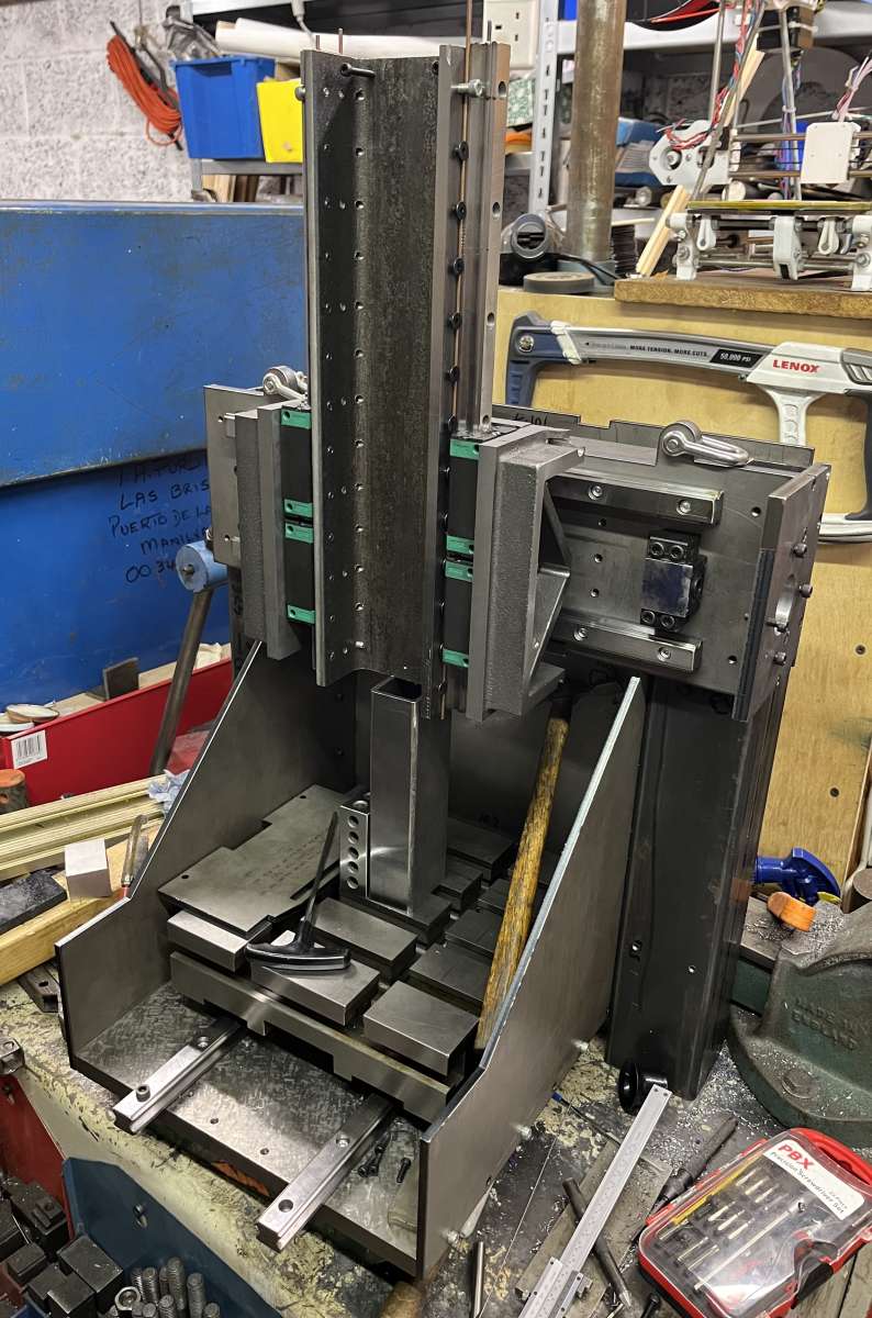

      Evening All,
      Some time ago I started to build a CNC mill.
      Initial discussions are here:
      https://www.model-engineer.co.uk/forums/topic/xy-table-or-xz-gantry/
      I’m approaching the end of the mechanics finally (it’s been a bit on and off work):
      IMG_4779
      I have closed loop steppers, drivers and a controller based on GRBL which I don’t now have the manual for… I’ll contact the supplier (they are still in existence, but have discontinued it), however I’m now wondering what to use as the User interface – I was planning on a Pi as the sender to the motion controller.
      I have seen controllers with touch screen and buttons in a nice case on eBay (for instance) which seem like they would work nicely and remove some of the effort of boxing a pi and providing a screen etc.
      Does anyone have experience of them, and what should I be looking out for?
