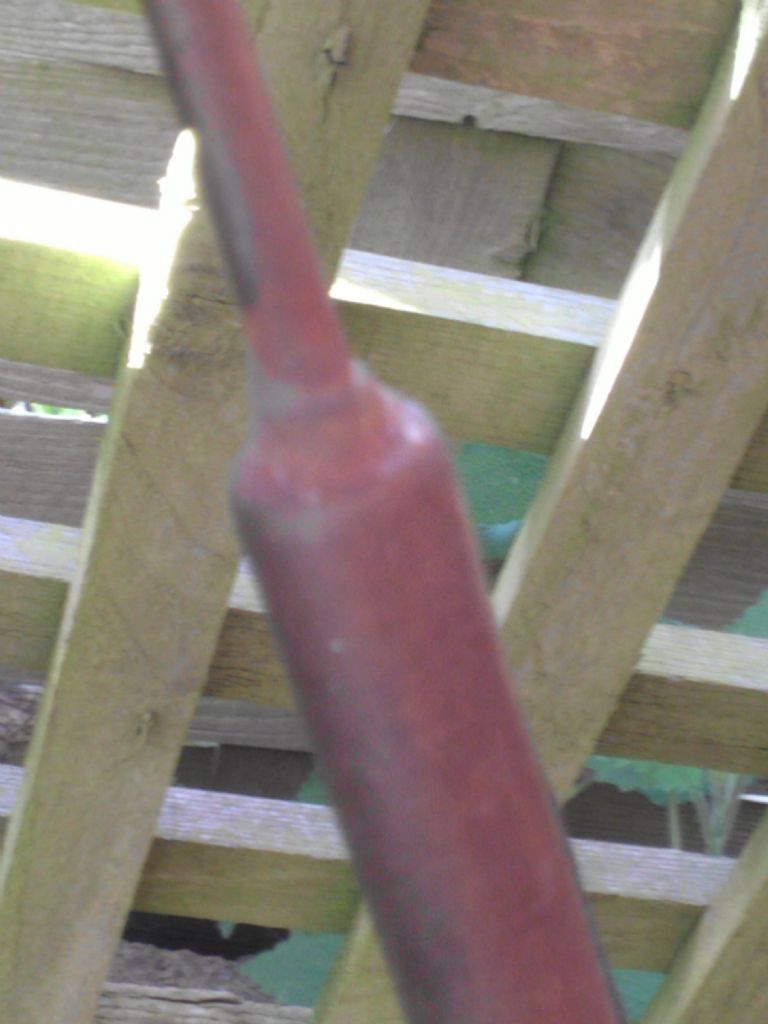

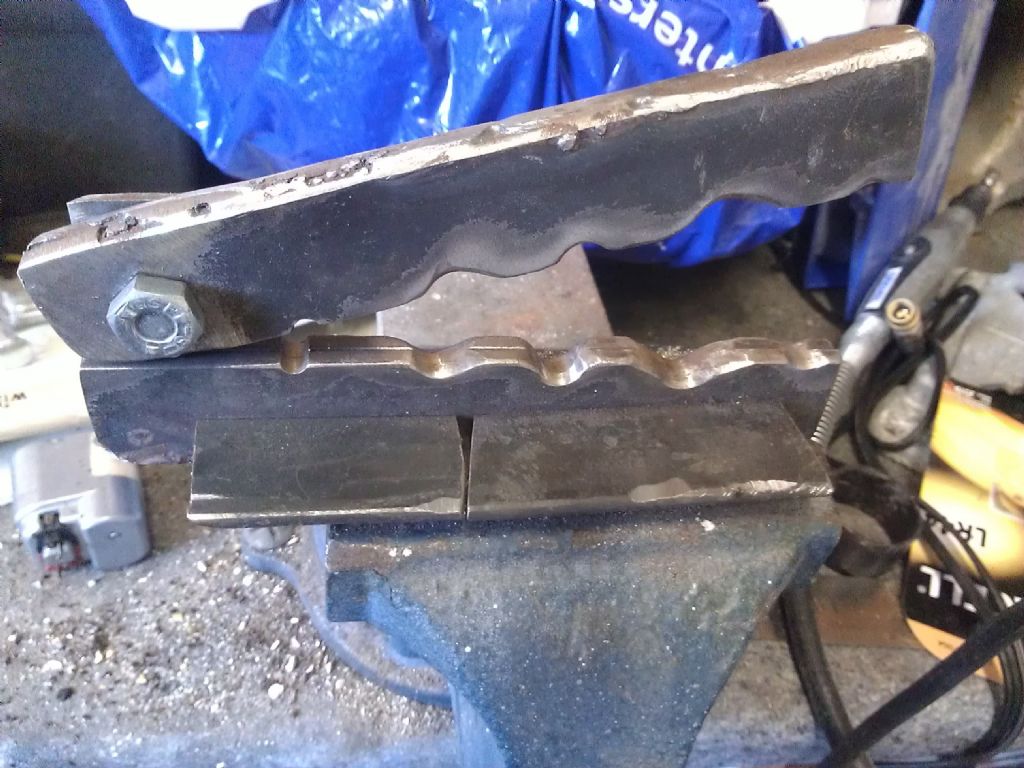

                            Does the dome need to be solid copper or can the end have a small fill of braze in it? I made a simple set of jaws to form the domed ends on some pipe to make some bull rushes. I will post some pictures of the tool later this evening.along with a picture of the shape formed.

                                    Following on from my earlier post, here are the pictures of the swaging tool and the resulting shapes. The tool was made from scrap, beig shaped with a dremel. The copper was repeatedly annealed, inserted into the jaws and the tool hammered shut whilst rotating the pipe. Working down through the holes allows fine control over the shape, leaving just a fine hole to braze shut. The bull rush shown flares back up at the end, but this can be avoided by simply going down through the sizes further.

                                    Doming Tool
                                    Domed Copper Pipe
