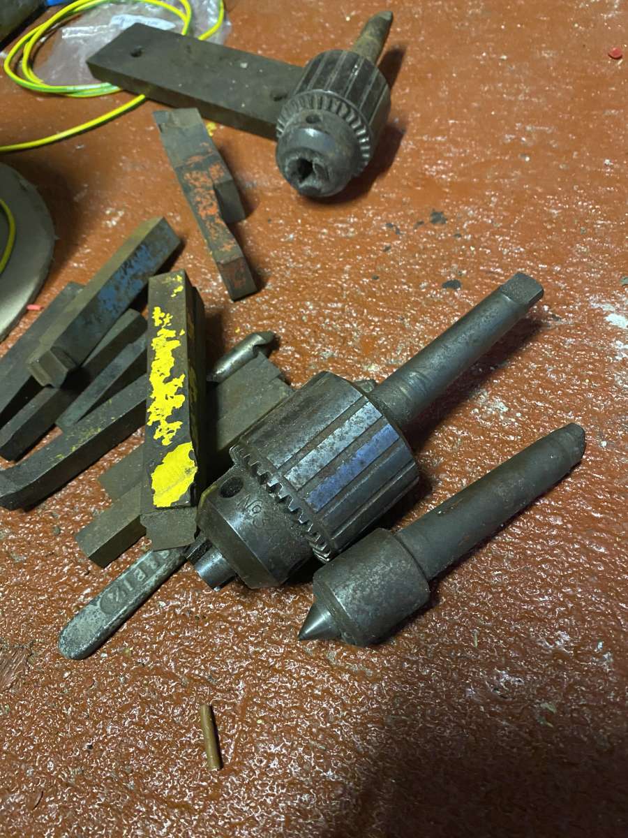

      Hi,
      I got a “new to me” old lathe and need to get these parts deep cleaned, remove the rust and then stop them rusting again. Any ideas how to go about this ?

        There have been dozens of threads on this if you can manage to search the old forum posts.
        Otherwise, for anything except the delicate sliding surfaces :
        Degrease with white spirit or kitchen cleaner of choice,
        Wire brush (machine not just hand),
        brush on phosphoric acid (get a gallon off ebay not the expensive proprietary brews)
        Wash off after a while (5 mins to 1 hour as you get experienced),
        dry quickly to avoid flash rust, inspect and repeat,
        coat asap with diluted clear Waxoyle or equivalent car treatment. Don’t use car polish or anything containing silicone. This will protect things until reassembled and will dissolve away in oil.
        If painting you will of course have to thoroughly dewax again.

          And, electrolysis in Caustic Soda solution is very effective on larger lumps of steel.
          For delicate items more than one approach may be needed.   Take the Jacobs chuck as an example.  Outside it’s robust, but inside there are somewhat delicate sliding parts and springs.   Rough treatment could ruin it, assuming it’s not beyond repair already.   Items like that often have to be stripped down, which may require a long soak in penetrating oil, and strong heat just to get them apart.
          May not be worth it.  The tapers have physical damage, which is bad.  Tapers rely being in good condition to get a tight grip, so I’d rather replace a battered one than take the risk.   If a manky male taper lets go and spins it’s likely to damage the socket.   Also, if the teeth are  damaged, the key will slip, which is a nuisance.
          The rust on the HSS tools is cosmetic, so a quick swipe with a wire brush would be more than enough for me.
          Unless you want the practice – a very valid reason – look carefully at old tools before spending time on them.  For example, the centre-drill has a broken end, and a new one is only a few pounds.
          The idea that old tools are marvellous compared with modern rubbish is common on the forum, but I have my doubts.  Those chucks were good when they were new, but have obviously been neglected, possibly because they were worn out in 1958 and put in a box.   What happens to tools in the decades after they were sold makes all the difference, and many old tools, no matter how well-made originally, are in poor condition.
          The way to find out how good those chucks are is to strip them down, clean, reassemble and test in a drill.  It’s very educational.   If they’re OK, then de-rust the outside and make them beautiful again.  Otherwise you may start by polishing a turd!
          I prefer making things, and would rather buy new than spend a lot of time refurbishing.   That’s just me though, for many others the hobby is all about making good and there’s huge satisfaction in bringing old gear back to life.

                          Those turning tools are recoverable, so might the revolving-centre be; but I’d be wary of the two drill-chucks.
                          The teeth on the foreground one look still all right but the shank is badly damaged. The background chuck seems clogged with some powder or granular material that ought not be there; but if the gear-teeth and shank is undamaged it will be worth trying to clean it out and lubricate it properly.
                          On both, examine the jaws to ensure they close properly and are not bell-mouthed. Usually the drills suffer rather then the jaws.
                          Neither will look beautiful again as they look quite badly pitted, though that is a cosmetic rather than mechanical problem.
                          My approach I think would be to wire-brush the worst rust off, clean them out, then assess their mechanical conditions before deciding to spend time and materials trying to remove all the rust from the exterior.

                                          I’d say that was closer to ‘tarnish’ than rust. I would just degrease, then rub over lightly with wire wool. It’s easy to overdo derusting on parts that have little more than patina and dirt on them.
