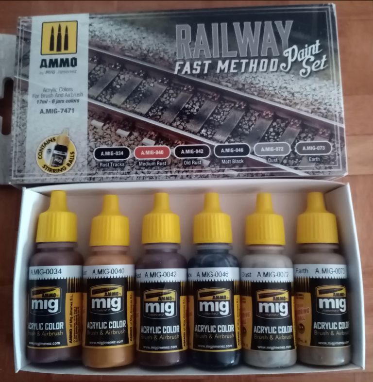

              Should anyone be interested something else I came across in the paint line is some weathering paint at a very good price. I found a MIG Ammo railway set of 6 colours in water based acrylic, it is actually a track weathering set but I thought it would also serve for some of the loco weathering.
              Priced at £14.95 and free postage makes each of the 17ml bottles £2.50 each which is half the price of most of the weathering paints of a similar size. I got it via ebay but the supplier is Jadlam Models UK. MIG do a large range including sets for military vehicles and aircraft as well as 160 colours and other items.
              The railway set is Track Rust, Old Rust, Medium Rust, Matt Black, Dust and Earth
              May be of interest.

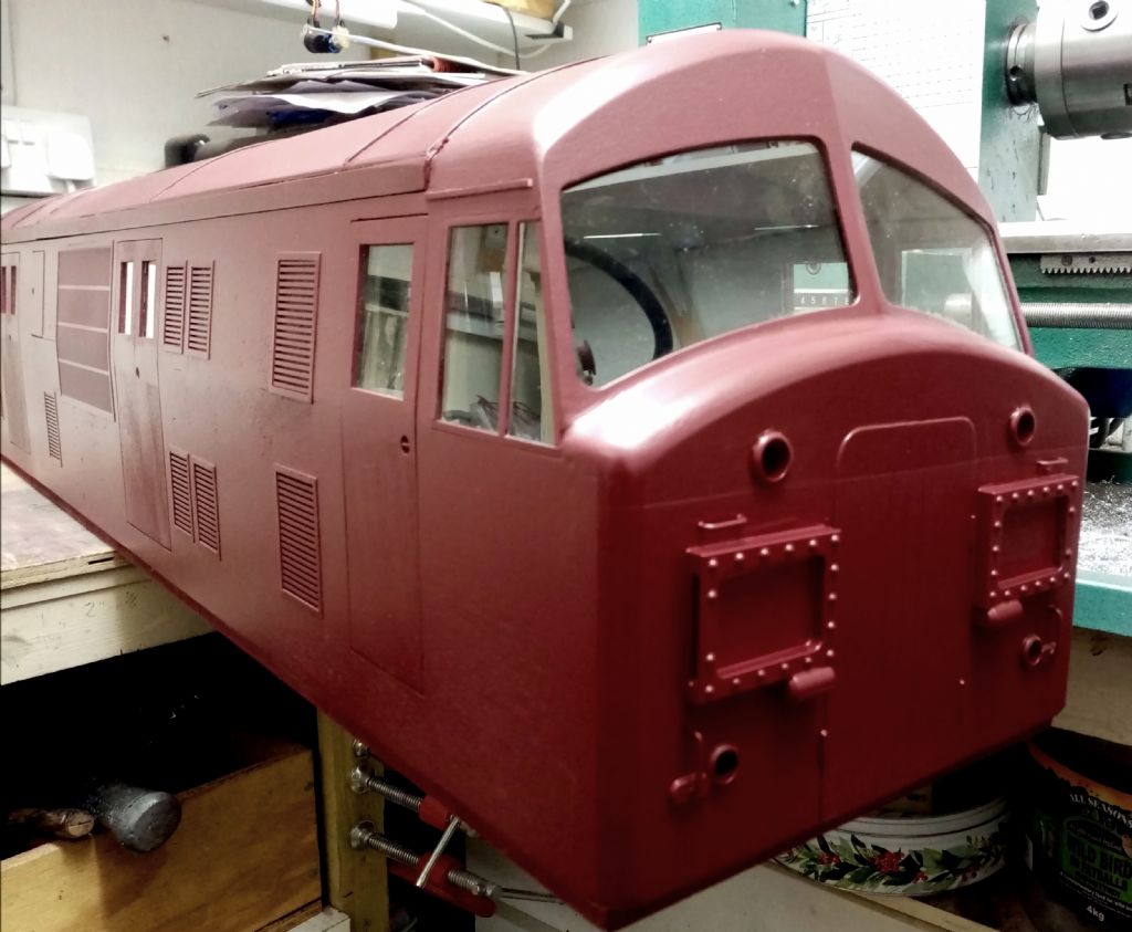

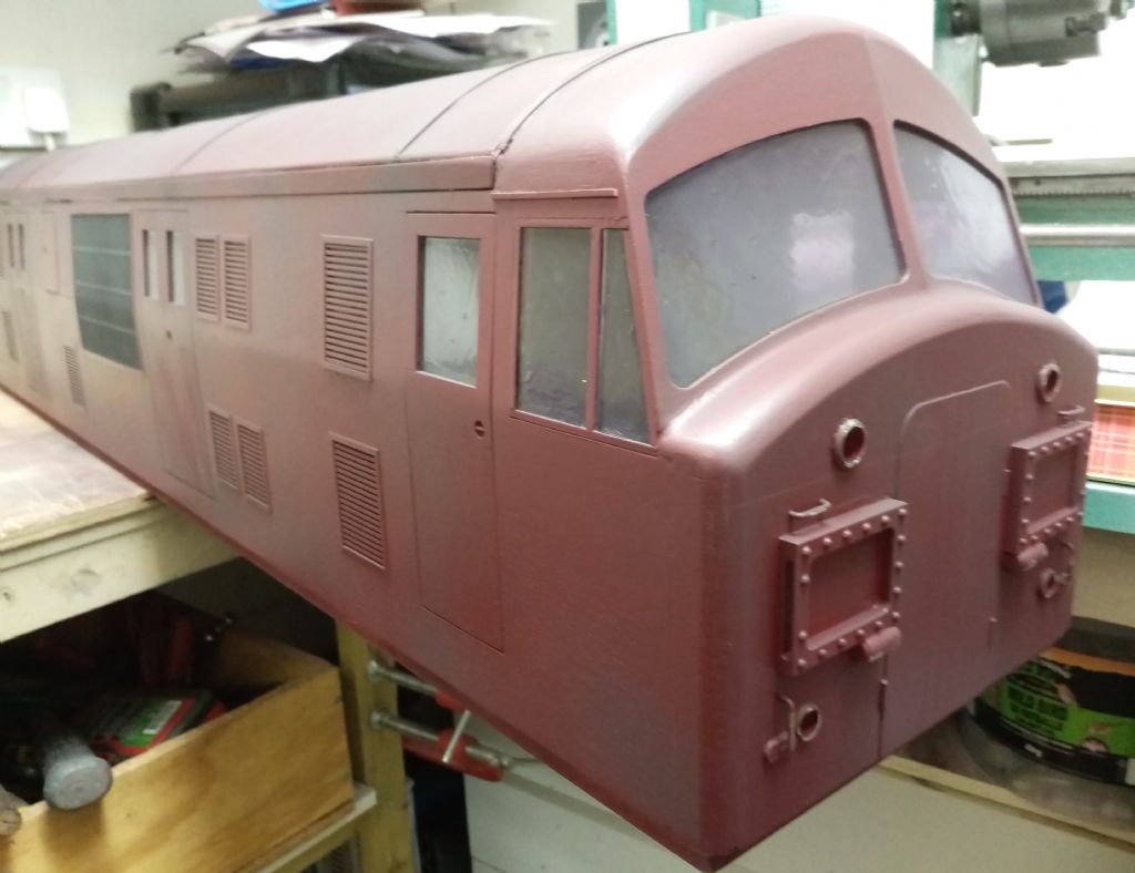

              #529094
              Ron Laden
                @ronladen17547

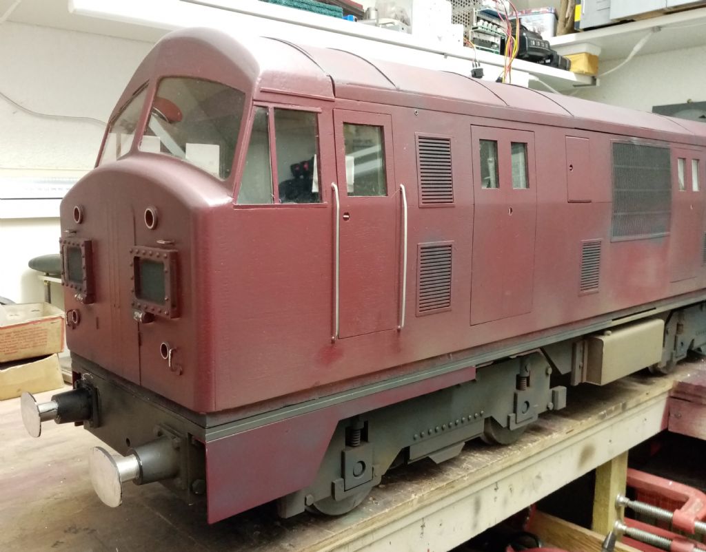

                Al the windows and screens fitted I used 2mm acrylic which I glued in with R/C Modellers Canopy Adhesive, first time I have used it but it's very good. Grabs hold in 3-4 minutes and dries crystal clear, should you have any that needs removing then a damp cloth shifts it completely with no residue. Another new to me product I, m about to use is Humbrol Maskol (liquid rubber like solution) for masking off the windows, apparently its very good.
                So about to start weathering the body working from the roof down, airbrushing using some roof dirt paint and others then with the body on the chassis working the frame and bogie finishes into the lower body and blending in.
                #529106
                Dave Smith 14
                  @davesmith14
                  Ron
                  Sorry if this is teaching you to suck eggs then disregard, but with weathering make sure you use a photograph of the prototype as a guide. It is the only way to get realistic weathering.

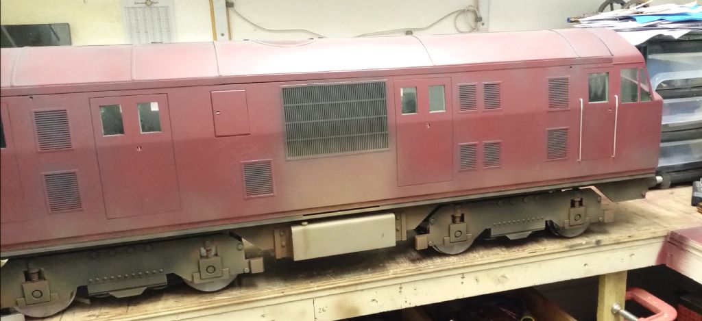

                  #530601
                  Ron Laden
                    @ronladen17547
                    I,ve had a change of mind re the weathering, I was going to go with a light scheme but I have decided to go with something heavier. I have a model of a quite heavily weathered Class 52 which is also in a Maroon scheme. Using some diluted roof dirt enamel I have given all the body a wash as a base, it has toned down the colour quite a bit which I can now add to.
                    Edited By Ron Laden on 27/02/2021 19:24:04
                    #532284
                    Ron Laden
                      @ronladen17547
                      Getting there, quite pleased with how it's starting to look.

                        #532332
                        Ron Laden
                          @ronladen17547
                          Funny you should say that Jason as someone else told me not to weather it. I am a fan of weathered loco,s though they are not to everyone's taste. In fact I could count on one hand the number I have seen on club tracks and only one of those was fully weathered.
                          I could also be a fan of weathered/aged stationary engines smileyhaving seen you Heinrici I thought that was excellent how you achieved that.
                          #532334
                          Jon Lawes
                            @jonlawes51698
                            I think with all weathering less is more. You seem to have a really good balance.

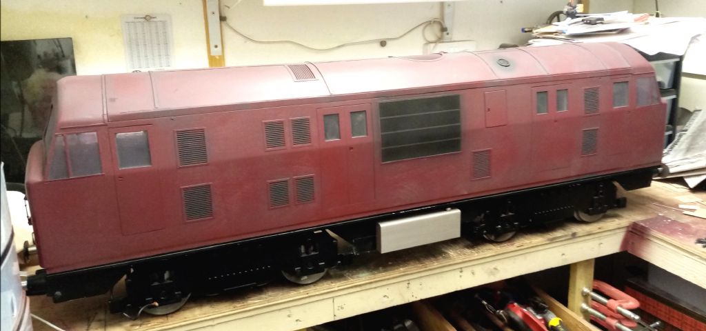

                                Ron Laden
                                  @ronladen17547
                                  Not to everyone's taste but it is to mine. smiley​​​​​​
                                  Not too much more detail to add but the build is complete enough for a track test once the club opens up again. Electrics next and I had forgotten the front and rear side valances so some alu angle is on order.
                                  Not too far away now and then onto other things, I am in need of a machining fix.
                                  #536229
                                  Ron Laden
                                    @ronladen17547
                                    That will do for now, side valances have been added and there is still some small details to add but they can wait until after the track test. I have electrics on order and decided to go with a plug in hand control which I will make up myself.
                                    I now have the AUW which is as near as matters 61kgs so a bit of a lump but it breaks down for handling and assy into the chassis 26kgs, the body 7 kgs and the pair of 12 volt batteries 14kgs each. Hopefully traction should be good, I cant see why not as there is a battery sitting immediately above each of the two bogies, well thats the plan at least.

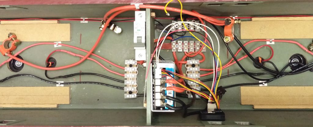

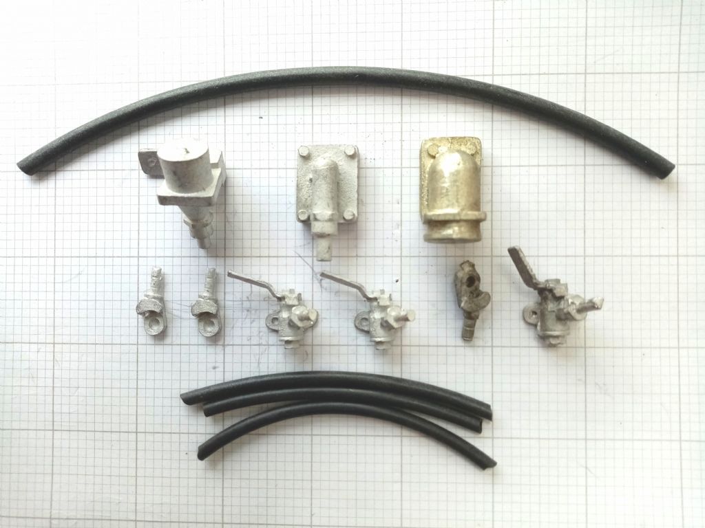

                                                #557023
                                                Ron Laden
                                                  @ronladen17547
                                                  Still no track test I,m afraid I haven't been too well recently in fact I haven't been in the shop for over 6 weeks but on the mend now. I was hoping for this Saturday but the forecast is wet sad just my luck.
                                                  Anyway I found a nice set of cast beam furniture which will save a lot of work, an hour with some needle files should see them ready to fit as they are quite clean, the hook and links I will make myself.
                                                  #557031
                                                  Jeff Dayman
                                                    @jeffdayman43397
                                                    Great looking casting set Ron. Hope you are better and able to get out on the track soon. Cheers!
                                                    #558634
                                                    Ron Laden
                                                      @ronladen17547
                                                      Hi guys,
                                                      I decided to get another diesel sound card for the loco (wiring diagram below), its a different type to the old one I had which went pop.
                                                      I think I have said before I am ok with basic wiring but when it comes to electronics I am a bit dull to say the least. The motors, batteries, speed controller and isolator are fine thats how I have them wired already. I understand that the pair of 10K resistors to the motor control prevent the voltage from exceeding 24 volts and the sound card is fed with 12 volts. I,m ok with the rest of the wiring but what I dont understand is how the 16v capacitor, 1K ohm and 100 ohm resistors and the way they are connected to the amplifier stereo jack are working. It would great if one of you guys can explain what is happening there, it would just be good to know.
                                                      Thanks
                                                      Ron
