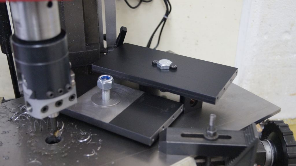

      Boring a clearance hole in the two chassis top plates (3mm steel) to allow a 17mm socket access for adjusting the bogie pivot bolt, the plates only just fitted mounted diagonally across the table which allowed a clamp on each corner.
      The picture also shows the bogie plates and the pivot bolt, I just kept it simple and shortened a M10 bolt leaving enough plain shoulder to run through both the bogie and chassis plate, the chassis plate is a copy of the bogie plate. I have also produced a 2mm thick x 35mm dia thrust washer but I am going to remake those increasing to 55mm diameter. I have also gone simple by using a nyloc nut to hold the pivot in place, once adjusted and at the moment I am thinking 0.50mm end float the nyloc should hold that position and not work loose.
      On one of the plates you may be able to make out a pair of M5 hex heads either side of the M10 head, these are to prevent the bolt from rotating when adjusting the nyloc. When the motors are assembled into the bogie frame there is no access to the bolt head with a spanner or socket as the head is almost hidden. I did think about having the head tack welded or thread the plate and fix with 638 but that would mean losing the plain shoulder and having to make a sleeve/bush. So again I went simple and fitted the M5 Hex heads, when the bogie is assembled I can just get a thin screwdriver between the motors to push the bolt head up between the M5,s until the nyloc pulls it up to the plate.
      Not too far away from having a rolling chassis.
      Edited By Ron Laden on 28/11/2019 10:09:04

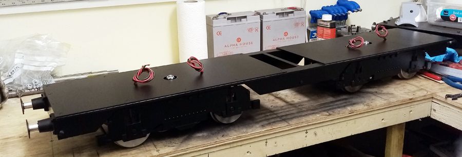

        At long last I have a rolling chassis, more detail to add to the sides and ends but that can come later as I want to make a start on the body.
        Still thinking about the best approach for the build of the body, I have considered carving a blue foam plug and laying up a glass shell with laminating epoxy. I have used the method a few times in the past on R/C aircraft but in a small workshop the thought of being knee deep in foam shavings doesnt appeal much.
        I built the shunter body from a mix of 6mm MDF, 1mm, 2mm and 3mm ply, ABS and alu sheet and it worked quite well so that is an option but the class 22 body is twice the length so it would mean more in the way of framing.
        Anyway pleased the main chassis and bogies are complete.

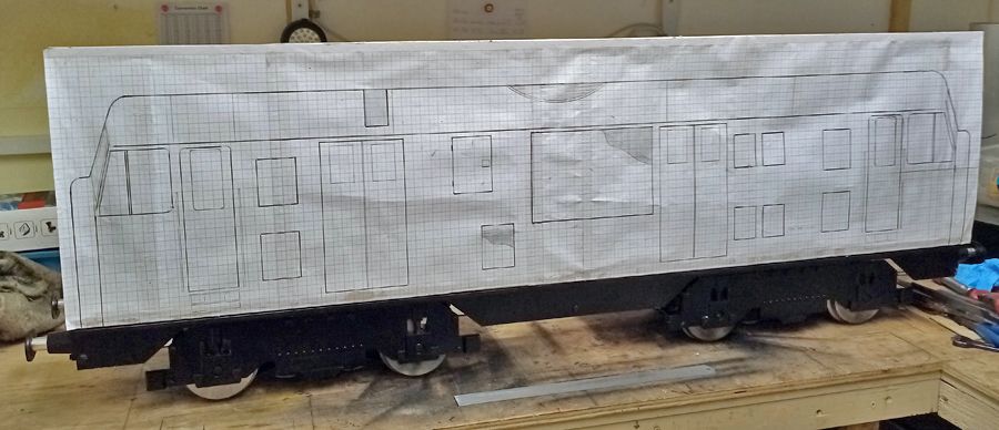

          I have the loco body, well not really but I have my original sketch which I offered up for an idea of sizes and how it looks, the sketch is short lengthways by 35mm so needs to grow a tad.
          I have decided to go with the MDF, PLY, ABS etc as I did with the 0-4-0 shunter, I,m quite happy working with those materials, the loco length is 48 inches buffer to buffer.
          The body main side panels will be 6mm MDF and you can see from the sketch there are a good number of doors and vent panels. I dont fancy cutting all those out and weakening the panels so I am thinking of facing the MDF with 1.5 mm Birch ply and cutting the apertures out of the ply, it will cut well with a good Stanley blade and a steel rule. I can then make and fit the doors/vents into the recesses and only cut through the MDF for the windows. Also a bonus with the Birch ply is that it is easier to achieve a good surface finish plus its a tougher skin and doesnt suffer dings as easily as MDF.
          The curved roof will be a skin of 1 mm Birch ply built on a framework, at the moment I plan on having the roof lift off for access.
          Anyway thats the plan so will see how I get on with it.

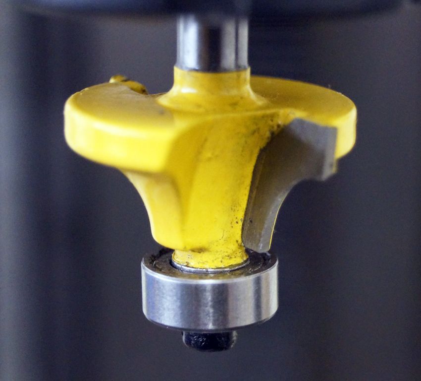

                                                  I took a gamble and bought a cheap Chinese set of 4 radius edge cutters, cost £8 for the set 1/8, 1/4, 3/8 and 1/2 inch rads.
                                                  The 20mm thick loco body cab/end plates have radiused edges which I was planning to cut and shape by hand but then thought it better and more accurate if I could machine to the basic shape and then hand finish. I didnt want anything expensive as the cutters will be seldom used if at all.
                                                  I know router cutters are run at high speed and I only have a top speed on the mill of 2500 so that was the main worry, would they work at the lower speed..? Need not have worried as they work and cut just fine, tried some test cuts on a piece of Pine, unknown hardwood and MDF and they left a very clean finish even on the MDF which surprised me. So in this instance £8 well spent.
                                                  1/2 inch cutter below.

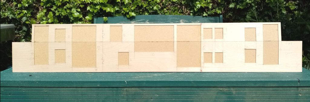

                                                    Our club track is open again (with restrictions and limited numbers) so I thought I would put a few hours in and make a start on the body. A picture below of one of the side panels in its early stages, base material 6mm MDF faced with 1.5mm birch ply. The top third of the panel is angled inboard by 5 degrees and the apertures cut for the numerous louvered vent panels and doors, 20 vent panels, 4 double engine bay doors and 4 cab doors on a class 22.
                                                    I considered fitting the 1.5mm facing as a one piece but went with cutting it into three and added one at a time, used 4 parts PVA / 1 part water to allow it to spread a bit easier when clamped and weighted down.
                                                    I found an old tin of cellulose sanding sealer which I tried on some MDF off cuts, 2 or 3 coats with a light sanding in between seems to work really well especially on the edges it soaks well in and seals the surface.

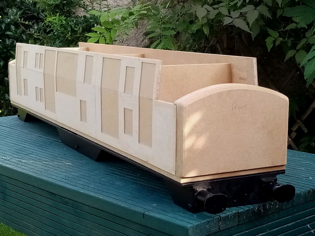

                                                      The body slowly coming together, the sides, base plate, bulkheads and cab end plates all connected and aligned.
                                                      Click twice to enlarge.
