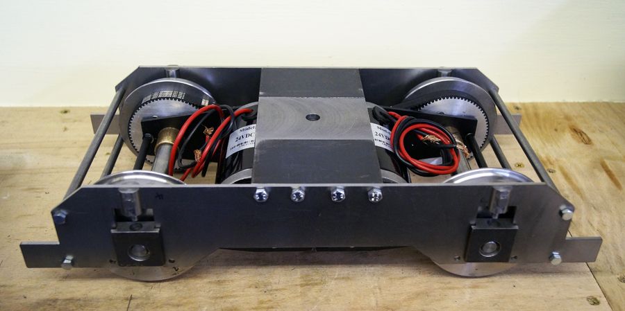

      The main metal work is finished on the bogies, waiting for some axle springs plus I have to add detail parts to the side plates but will probably leave that until just before starting on the body.

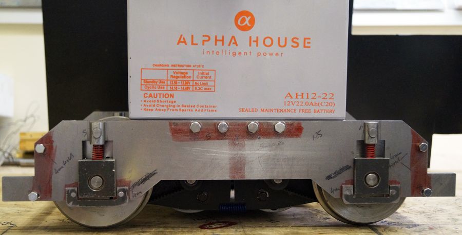

        The axle die springs arrived which I have fitted to the bogies, I went for the red ones which I consider to be medium/heavy and it looks as if they are just about right. Each pair of batteries (14kg) will sit directly over the centre of the bogie plus I estimate a further 4 kgs at each bogie from chassis/body. The piccie below shows one of the bogies with a pair of batteries plus some ballast which I added to make up the weight. The spring compressed approx 2.5 mm which leaves 6mm of travel in the suspension which I think should be ok.

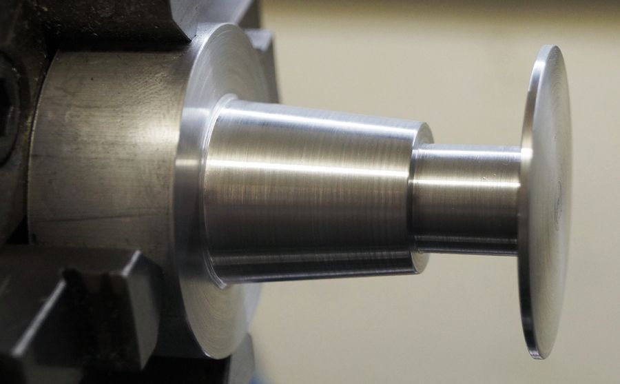

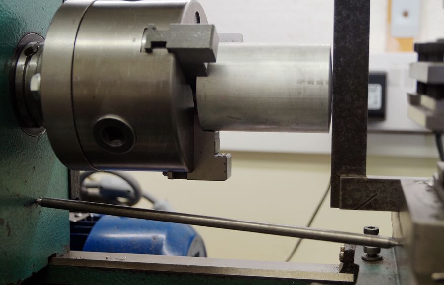

          Fancied some lathe work this morning so made a start on the buffers using the guide rod method for creating the convex face. I did the 0-4-0 buffers this way after some of you guys told me of it, it is so simple to do and works a treat. I put a square up to the face to show the convex, I went with a 220mm radius on 50mm diameter.
          Edited By Ron Laden on 31/08/2019 15:20:15

            Turned the first of the buffers to a shape and type I,m happy with. To the mill next as the base mounting plate is square plus I currently dont have a deep enough parting tool so I will cut it off with a slitting saw. The buffer face is the oval type and I think I will shape that by hand.

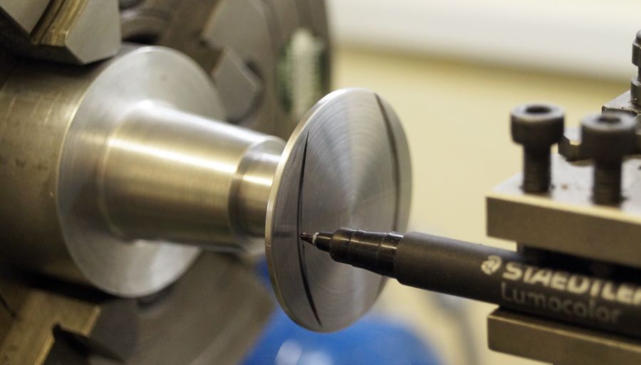

              Posted by Ron Laden on 02/09/2019 09:19:29:
              Very nice!

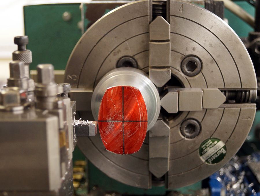

              As you seem to pick skills up quickly why not have a go at turning the oval as well? In theory, offsetting the job's centre in a 4-jaw will cut one side of an oval, then offset equally in the opposite direction to put the same curve on the other side. It won't be a perfect geometric oval, but could be finished to look good by hand as necessary. The advantage of turning is producing four identical buffers without lots of manual work. This assumes there's enough swing on your lathe; check with a dimensioned drawing.
              Be warned – I've never tried it myself and would practice on lots of scrap first!

                Thanks Dave, thats a good idea so I did a quick rough and ready check with the buffer offset in the 4 jaw and a marker pen in the tool holder. I will obviously need to calculate the offset and the tool position more accurately to bring me close to the finished shape but as you suggest it should reduce the hand work and will be repeatable on all four buffers.
                Thanks again, Ron.

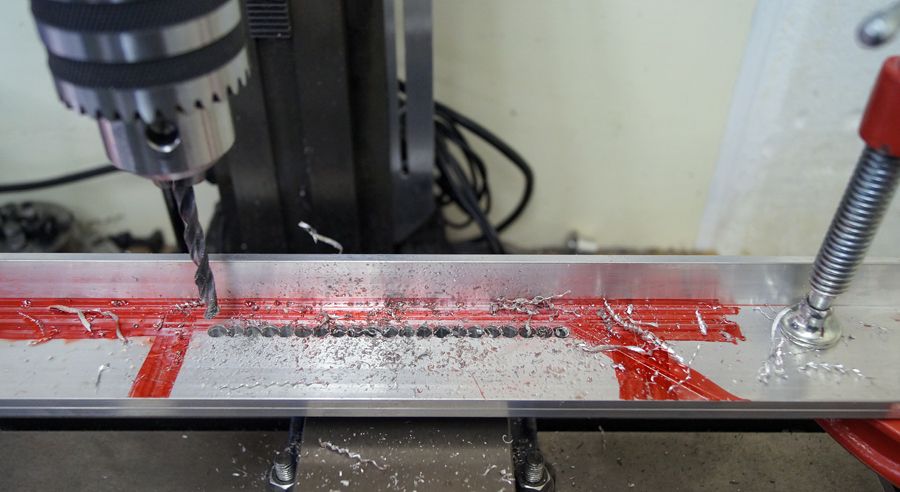

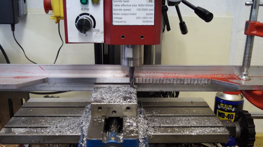

                    Chain drilling the chassis rail side walls for clearance at the bogie positions, 2" x 1" x 3/16" alu angle back to back to get a matched pair. I did remember (just) to set the depth stop to prevent drilling the vice..smiley
                    #428901
                    Ron Laden
                      @ronladen17547
                      You cant beat some early morning (5am) smiley machining to get the day off to a good start.
                      Anyway, 2 x 46 holes later, waste pieces removed and the angled ends cut and filed to shape it was back on the mill to clean back the drilled edges. Its a case of sliding the work along so as not to get too far away from the vice but it works well enough.
                      I would have used a 10mm 2 flute carbide alu cutter but its past its best so need to get another one. So it was a case of having to use a 8mm 3 flute coated HSS cutter from ARC,s premium range. I am really impressed with this cutter I have used it on both steel and alu with great results, think I will get a 10mm version also.

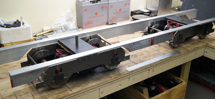

                        Today I machined and fitted the bogie mounting plates to the chassis rails so obviously I just had to offer up the bogies to see how it looks, something must be wrong….it all fits..smiley
                        A lot more to add to the chassis but awaiting some material to continue, also material for the traction engine. I must admit I thought I was mad and biting off more than I could chew running the engine and loco builds side by side but it seems to work. I,m enjoying both of them and its good fun which is what its all about I guess.

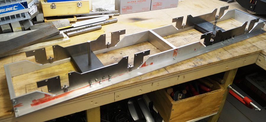

                          I made up and fitted 3 frame spreaders, of which the 2 end ones also serve as buffer plates. The chassis is very simple 2 x alu angle side beams 2" x 1" x 3/16", 2 x steel bogie mount/swivel plates 3" x 1/2", 3 spreaders 2" x 1,2" alu bar. The top of the chassis beams will have 3mm steel plates connecting it all together, simple but strong.
                          Just started making up some detail parts for the bogie side plates plus the sides of the chassis beams.

                                                Back to the buffers I went with setting up in the 4 jaw to get the basic shape (Daves idea, thanks Dave) and it worked well. I did start out using the parting tool which would probably have been ok but I chickened out worrying about a grab which would wreck the buffer. I went with a standard tool and 10 thou cuts, didnt take long as it is only a thin face to machine. The secret was cutting one face and then turning the buffer through 180 and getting it pretty much spot on otherwise you would end up with a weird shape. Just some hand shaping now on the ends which is not too much.

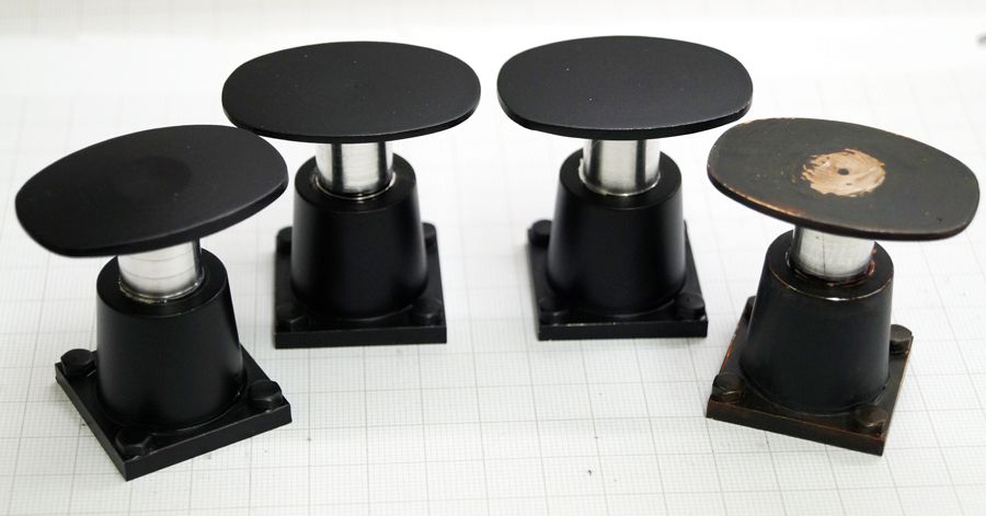

                                                      Still working away on the chassis so I thought I had better get the buffers finished. I was going to make them one piece but went for a separate base plate in the end. The fixing bolts are dummies (5BA) and not even threaded, I drilled a close fitting hole and fixed them with 638, the buffer assy is fitted to the chassis with a single M6 cap head.
                                                      I started a bit of light weathering on one of them and will do more when I weather the buffer plate. I am quite pleased with them though they are not perfect but the best I can make of them.
