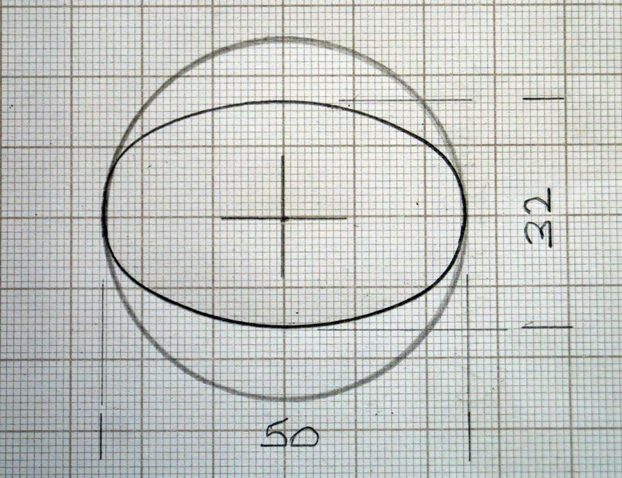

      As per the 0-4-0 I intend to machine the buffers in aluminium – all one piece not sprung. The 0-4-0 buffers turned out well but its not quite as simple with the class 22 as the buffer plates are not round but elliptical.
      I have thought of machining them round then scribe around a template and file them to shape but it would be nice to machine them if I can, but how..? I also thought of making them round and then mount them on the rotary table and cutting with a large radius machine the two horizontal edges and then with a smaller radius machine the ends. That would still mean blending in (I think) as the two mating radius would not generate the correct shape.
      So still thinking about it but if anyone cass pass on any tips or methods of manually machining an ellipse it would be appreciated.

        Google 4 centre ellipse, then make a jig to hold the stocks off centre on the faceplate, this will allow machining of 2 of the curves, but then you are into filing

          I sketched out the shape which is stretched a bit, I think machine it round and then cut and file to shape is going to be the easiest.

            Just a thought – is the oval buffer the same width as a round one or the same height or something in between??
            Also why turn it round as none of the round will remain in the finished buffer head? – why not plot some coordinates and rough it out standing on end in the mill, finishing with the file.

              Nick, actually I will not be machining it round the complete one piece buffer assy is coming out of 50mm bar so it starts off round.

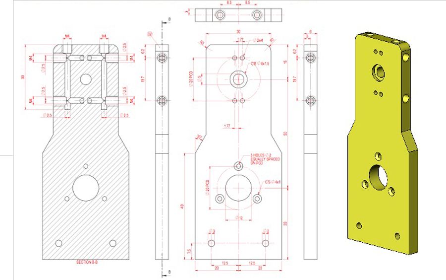

                Working on the design this morning I wondered if I was proficient in CAD would it make things much easier..?. I fear though I am too long in the tooth to start now and I dont have a leaning towards computers. So its paper and pencil which I understand and for me it seems to work, though I dont produce proper drawings (unless I put something out) but more in the way of working sketches.

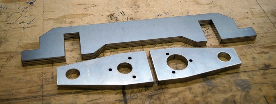

                    Hopefully things should speed up now as I have the bogie side plates and the motor mounting plates. Laser cut which I make no excuses for, my right arm will no longer allow me to carry out any serious hacksawing otherwise I would have cut them manually. I am very fortunate in that I have a friend who cut them for me FOC plus they were cut on a new machine that had only been commissioned 2 weeks ago, the edges are very clean indeed which is a bonus. I still have work to do on the plates so I do have to put some effort in.
                    #423133
                    Jeff Dayman
                      @jeffdayman43397
                      Looks like nice clean cutting work Ron. Good to have a friend in that biz!

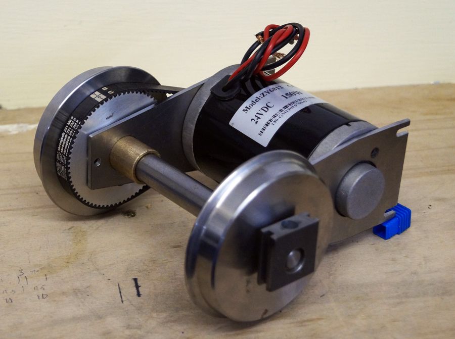

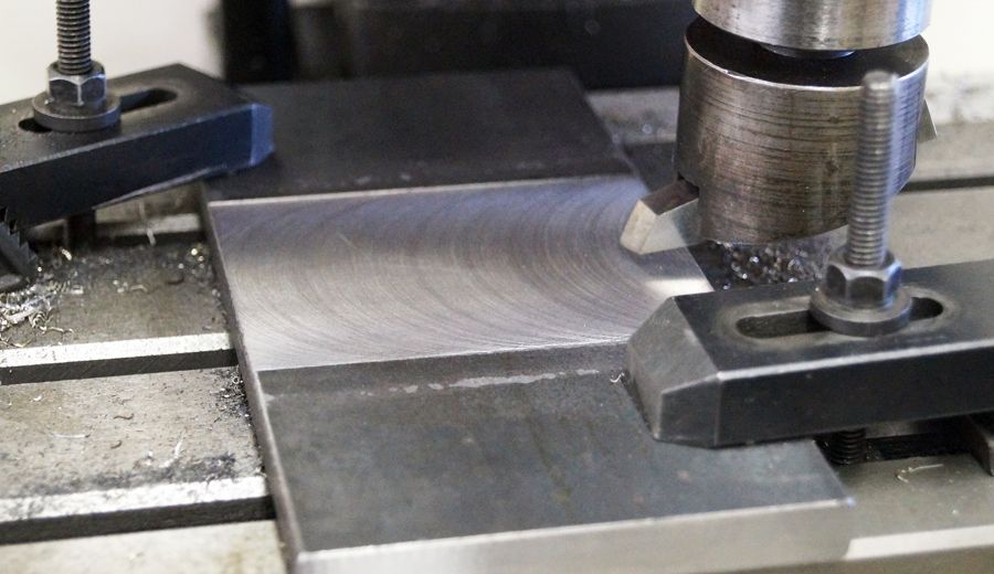

                        First job on the motor plates was to machine a 1.0 mm deep recess for the axle bearing shoulder. The motor body length makes things a little tight between the wheel back to back when the plates and bearings are added. The bearing shoulders I have reduce from 3.0 mm to 2.0 mm thick and with the recess I should gain a further 2.0 mm which will leave 1.0 mm end float when the motor assy,s are mounted on the axles.
                        The recess is 4.5 mm wide x 1.0 mm deep which I did as two 0.5 mm cuts using the rotary table, worked well using a 8mm 3 flute HSS end mill (ARC premium range) .
                        A bit of video below of the second cut and the finished result.

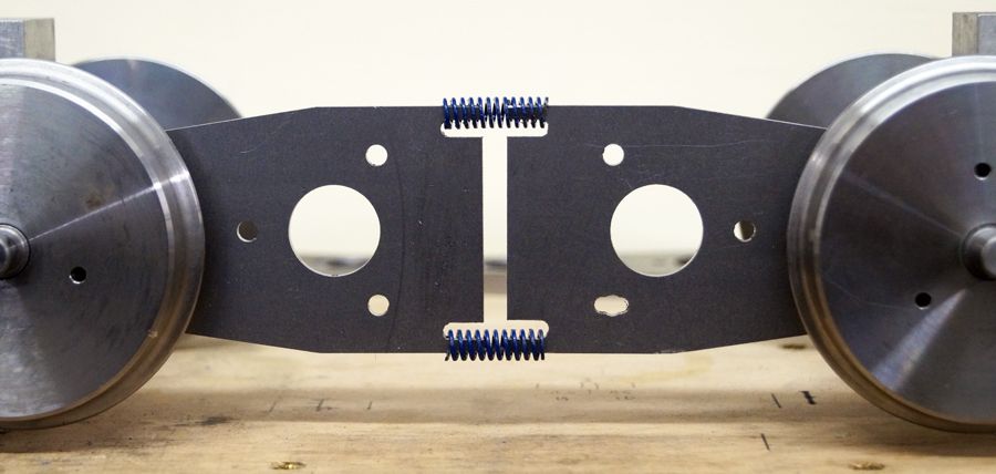

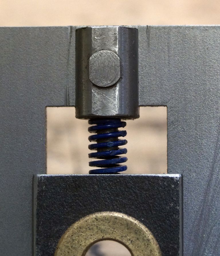

                          I put in the spring slots on a couple of the motor plates to see how it was looking, the gap between the plates will be 3mm when the axles are mounted in the bogie. The usual is to slot the plates and locate them onto a tie bar but I thought I would give the springs a try. I think it should work ok, I cant envisage any problems with it but if there is I still have space to add a tie bar.
                          p.s. The blue springs fitted here are what I consider medium strength but I will fit the green heavy springs on final assembly, picture of the different strength springs on a previous post.

                            Apart from slotting the motor fixing holes for belt adjustment (awaiting a 5mm end mill) the motor plates are finished with the bearings fitted. I loosely put an assy together to see how things were looking and it seems ok.
                            The only mistake I can see at the moment is the tie bar fixing holes at the end of the plates next to the bearing. I had it in mind to use hex head screws to mount the tie bar but as you can see there is no space for a hex head, dont know what I was thinking there. All is not lost though as I can csk the plates and use csk screws.
                            I also have to spot through the 3 holes from the plate to the motor rear end casting then drill and tap M5 for fixing, the motor front end comes with M5 mounting holes.
                            So its coming along and although I had it worked out on paper its always a relief when it comes together in the flesh.

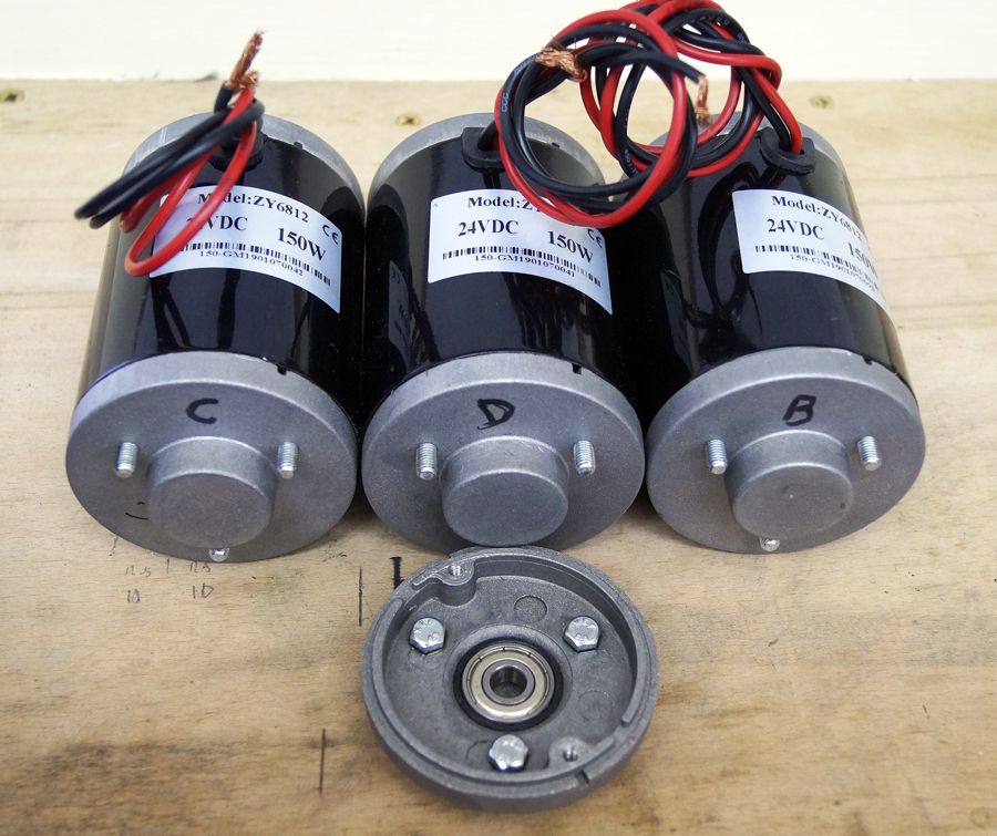

                                The motors have had the brush wires soldered, they were crimped but whilst I had the motors apart I thought belt and braces and soldered the connections. I have also added the M5 mounting studs to the rear cover, the covers are cast aluminium and quite soft. The front cover is 4mm thick and comes with 3 x M5 tapped holes, the rear though is only 2mm thick with no holes. With only 2mm of soft material I thought it stronger to fit the screws from the inside and use retainer to lock them in place. The front motor mount plate will be fixed with hex screws and the rear mount plate with nuts.
                                #423809
                                  Posted by Ron Laden on 12/08/2019 17:05:33:
                                  I doubt it will make a difference unless the motors are used lots but soldering isn't recommended for terminating flexible connections. The solder wicks up the braid and reduces it's ability to soak up vibration whilst also creating a stiff point where stress concentrates and causes fatigue failures.
                                  Can't say how much it matters in practice. I've never seen any figures comparing the reliability of solder vs crimped joints on flexible wires and have broken the rule myself many times fixing old cars.

                                    Thanks Dave but I,m not too concerned, I put just a small spot of solder on the crimp to make sure it didnt work loose and I couldnt see any sign that the solder had wicked up into the braid.

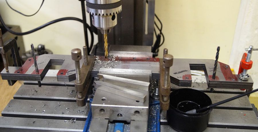

                                                Hooray for the DRO,s I fitted to the mill, first time I have really used them since adding them a couple of weeks back, what a boon they are.
                                                I sandwiched the bogie plates for putting in the various holes, the DRO,s made it a doddle for placing the holes, money well spent I think.

                                                  The spring mounts are a permanent fixture and I fitted them to the plates with M4 cap heads which I locked with 638 retainer. I then put them up on the mill and machined off the socket and filed two vertical edges, no big deal but I think they now look a lot better than cap heads.
