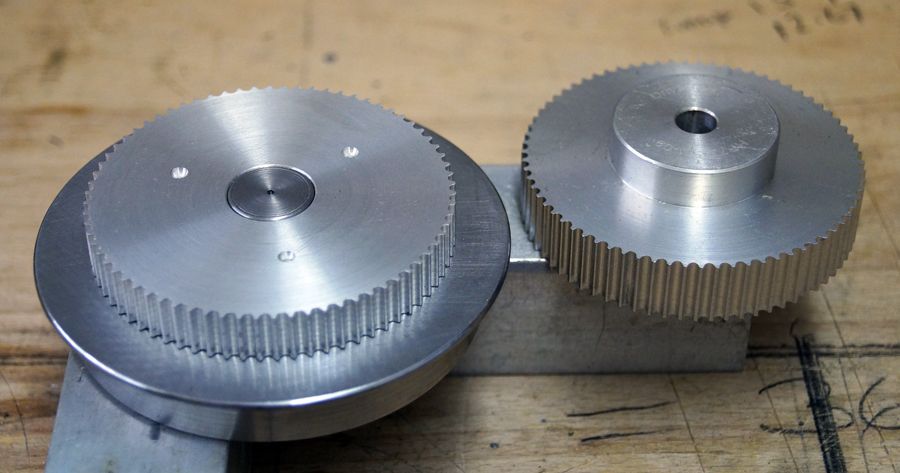

                              #414553
                              Ron Laden
                                @ronladen17547
                                Started machining the belt pulleys ready for fitting to the wheels, they need the boss removing, the width reduced to 10mm from 13mm and the bore increased from 8mm to 16mm. I turned up a stepped mandrel to centre the pulley to the wheel, the axle seat for the wheel is 1/2" dia and the main axle diameter where the pulley sits is 5/8" (16mm). I put a small hole in the centre of the mandrel which with a pair of dividers made scribing a PCD for the screw holes dead easy. The mandrel will also come in handy when I screw and fix the pulley to the wheel keeping all centered and aligned ready for fitting to the axle.
                                Edited By Ron Laden on 16/06/2019 16:06:36

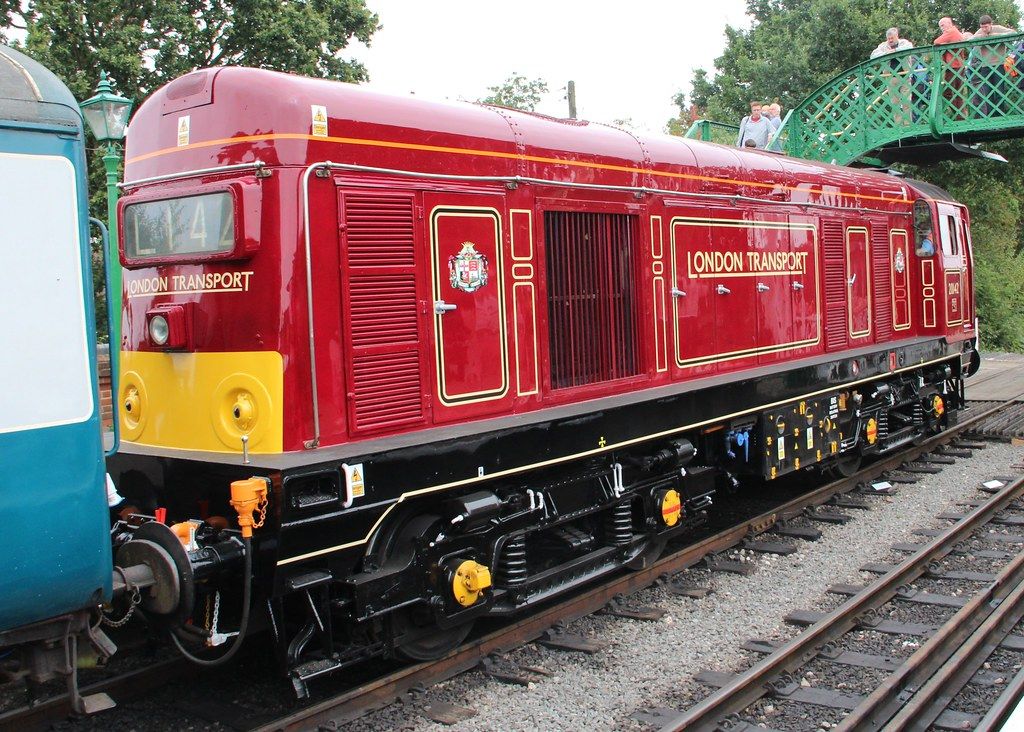

                                  There are a good number of Bo Bo British diesel locos and the class 22 is one of them and that is what I set out to build, but I am considering playing my "change my mind card" .
                                  I came across a couple of older Pullman locos which have a bit more interest in the detail and shape of the body and not so often modelled as far as I know but then I found the one below.
                                  Its a class 20 but surely a "showmans engine" in the world of diesel locomotives, not decided but seriously tempted. wink

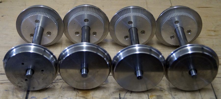

                                    The 4 axles/wheels are complete with drive pulleys fitted, the pulley wheels are not fixed to the axles yet as I have to slide on the motor mounting plates before fixing.

                                      Well the wife is not too impressed with the shiny red class 20 loco. Upon seeing the picture of it she said "oh no its far too ornate, looks like something from a fairground, way over the top" I said, I know thats what I like about it. She said, "stick with the baby warship"
                                      So there you go, thats what the wife thinks of it ….frown

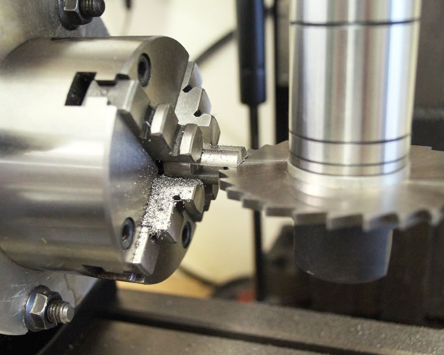

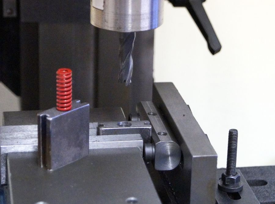

                                            The 1/8" slitting saw arrived, I was looking for a 3mm to fit my R8 / 22mm arbor but struggled to find one. Jason suggested that if I could get away with a 1/8" then ARC had them in stock though the mount hole was 1" and would need to knock up a stepped bush which I did.
                                            The saw is for slotting the axle box spring mounts (8 off) so I set them up this morning using the 4 jaw mounted on the RT. I thought it the best way to hold them with the blade running through between the jaws it worked fine, took no time to do all eight.
                                            Thanks Jason, I would probably still be searching for a 3mm saw at the right price.

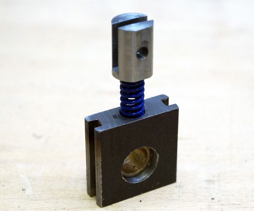

                                              The basic axlebox and spring mounts are done, they will need 25mm long springs which at their rating gives 3mm compression when all 8 boxes are loaded and a further 6mm of travel when running. I went with those dimensions/figures on the 0-4-0 and it works fine. The bearings are shouldered oilites, 10mm long which matches the length of the stub axles and conveniently leaves a recess for bearing caps which I will turn from aluminium.

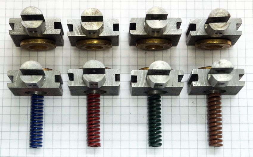

                                                  Just out of interest or for anyone looking for heavier type compression springs for axle boxes and the like I,ve put up a picture showing what I go with. I use die springs, always buy them from China via Ebay, they are good quality and there is a huge range of sizes. They are cheap as chips always come with free postage and they are usually delivered within 7 days or less.
                                                  I dont know if Chinese manufacturers/suppliers always use the same colour code for the different strengths but I,ve had the same colour springs from different suppliers and they were identical. For my use I have rated them as Blue=Medium, Red=Med/Heavy. Green=Heavy and Brown=V. Heavy.
                                                  I will probably go with red on the class 22 based on the 0-4-0 working well with 4 red springs and a AUW of 25kgs. The 22 should weigh around 50 kgs but with 8 springs.

                                                    What is the dimensions of the springs you are using?
                                                    #420068
                                                    Ron Laden
                                                      @ronladen17547
                                                      Posted by Thomas Staubo on 20/07/2019 20:55:44:
                                                      Nice work!
                                                      8mm diameter x 25mm long.
