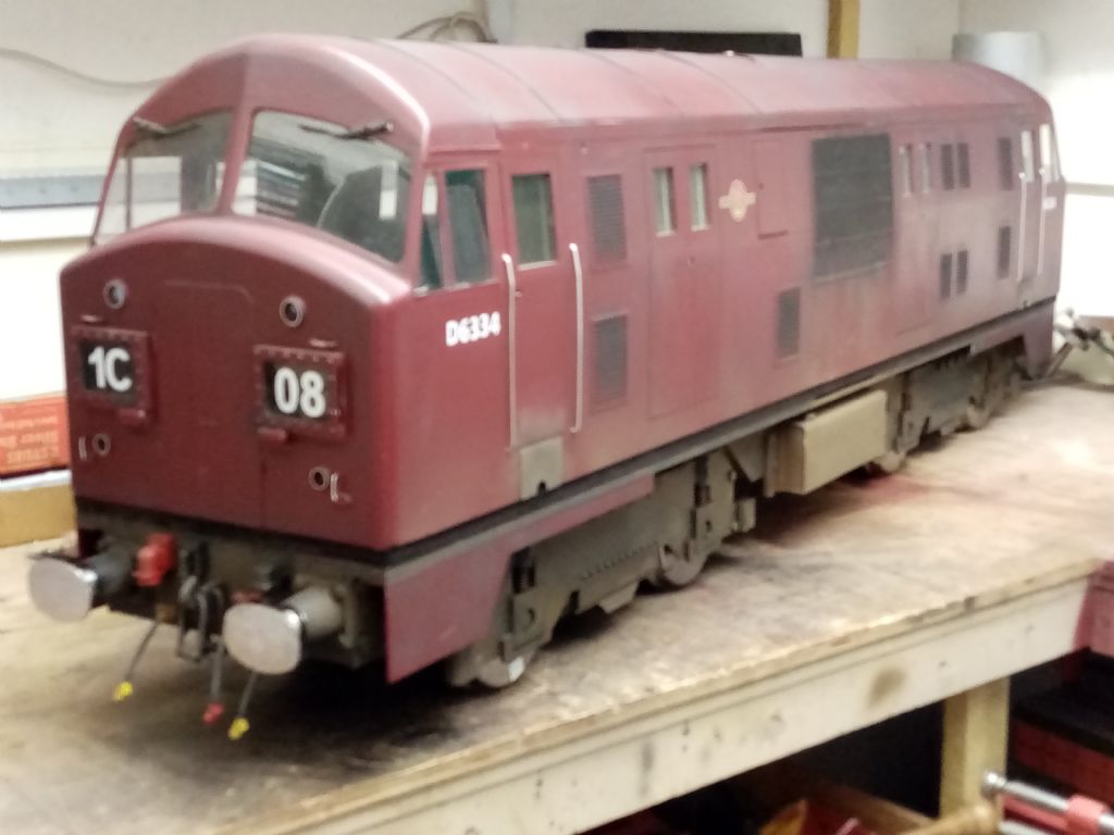

      Apologies for the thread dragging on but life and health (don't ask) just got in the way especially of late. However I did manage a few productive hours in the shop last week and the loco is as finished as its going to be. I still have the two cabs to fit out but they can wait.
      So all been well if I continue to improve the track test is not far away and I hope to get some video of how things go.
      Picture below of it desperate to be sitting on some rails.. smiley

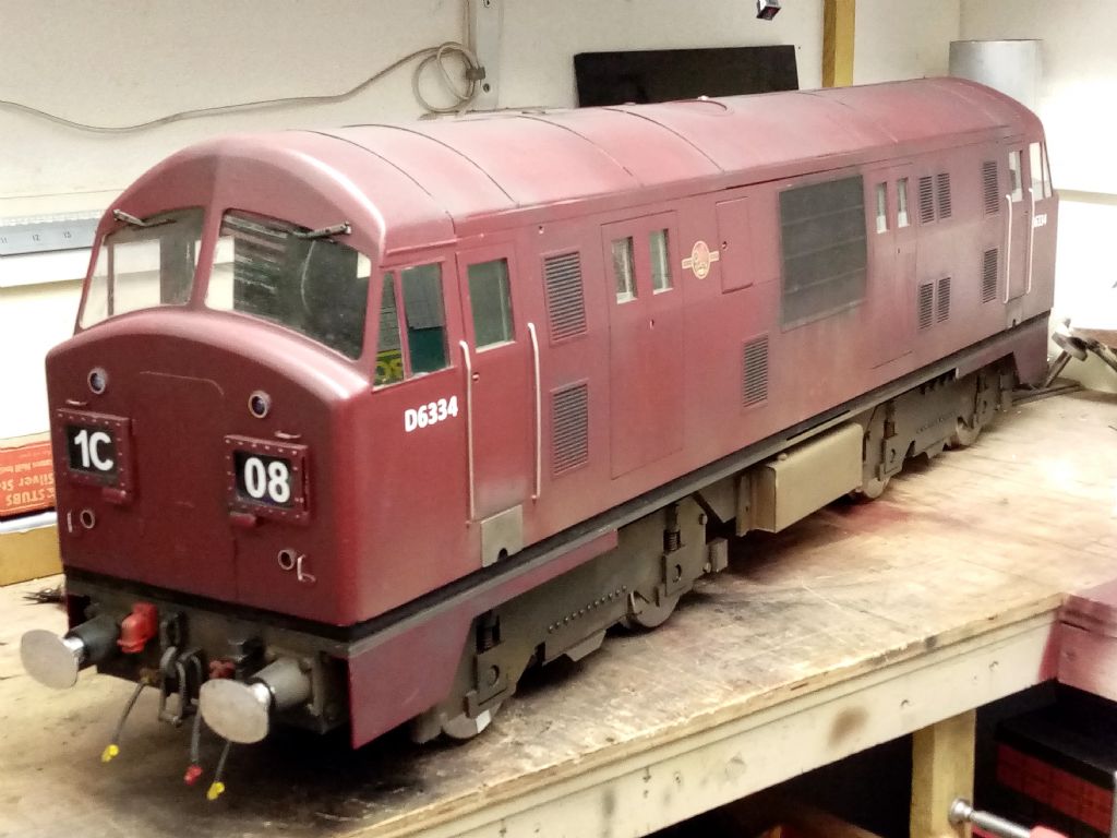

        A bit better focus I think.

          Awesome. Great job.
          I know most readers will be more interested in steam engines but having driven a similar-sized battery electric engine at Basingstoke &DMES I can fully appreciate both the modelling and the fun of operation that this model offers. laugh

            It's looking great Ron. Hope you get your rails wish soon! Cheers

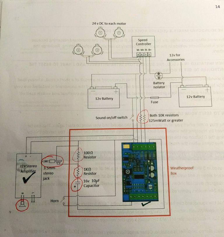

                                Posted by Ron Laden on 17/08/2021 16:06:37:
                                Hi guys,
                                … what I dont understand is how the 16v capacitor, 1K ohm and 100 ohm resistors and the way they are connected to the amplifier stereo jack are working. … it would just be good to know.
                                Late answer, but here goes.
                                The 100Ω and 1kΩ resistors form a potential divider. It's purpose is to match the output of the sound board to the level required to drive the amplifier. Most amplifiers are quite sensitive and if the input signal is excessive, the amplifier will clip and otherwise distort the audio sent to the loud speaker. The divider's ratio is 10:1, which would be right, for example, if the amplifier input expected 1mV and the sound board output a 1V signal. It's a fixed volume control.
                                A useful property of capacitors is they block DC current whilst allowing AC to flow. The 16µF capacitor is a isolating precaution: it stops any DC that might happen to be on the sound board output from confusing the amplifier.
                                The divider and capacitor ensure the right level and type of voltage are fed from the sound board to the amplifier. The combination will also act as a tone control, but like as not the effect has been ignored by the designer. If the output sounds a bit shrill, or lacks bass, try increasing the size of the capacitor. Anything up to 220µF should do.
                                Although the amplifier is stereo the Sound Card is mono. The Potential divider drives both Right and Left Channels, a mild bodge. Reason for this is likely cost. Small stereo amplifiers being common as muck are often cheaper and easier to source than their mono equivalents. It's nothing to worry about.

                                  Dave, thanks for the explanation on the amplifier circuit and what each component does.
                                  I learnt something today by chance whilst watching a video, although a lot of switched circuit breakers look the same there is AC and DC types and they are different animals not to be interchanged. Not knowing there is the two types I just ordered one at the time and I cant remember any reference to AC or DC unless I missed it. So I think it probable I have an AC type in the loco when of course it should be a DC so will have to get one on order.
                                  Goes to prove that too little knowledge can be dangerous.
