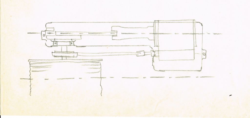

            I don't like the idea of four bearings inline on the crankshaft, I cannot say I have ever seen that in full size practice, so I may change that on my model if I can come up with something better.

              Very nicely done John, the light wood cleading goes well with the cream and makes a nice change to the usual darker combinations.
              Phil, If the eccentrics were moved inboard of the bearings then you would have less overhang of the cranks so the outer bearings could be done away with. Maybe even swap the base castings over so the ctr lines of the two engines come closer together. Should be easy to play about with the parts in CAD.

                            I am fairly sure the only reason the compound has four main bearings is the fact that is was also available as a single cylinder model, and then mirrored to make it into a twin or compound. Hence the need for two bearings on one bedplate.

                              Phil
                              This would be how I would arrange things if going for just two bearings, all it needs is the beds swapping over, lop off one bearing base and probably extend the pad that the cylinder mounts on. This is a quick and dirty tracing but you should be able to play about with your CAD parts easy enough to try it out.
