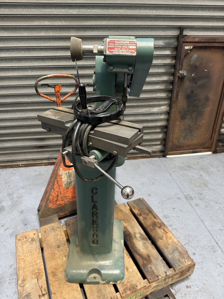

      I wasn't shopping for one but somehow managed to acquire on last week.
      It was delivered today and I took a bit more of a detailed look at the machine I'd stumbled into.
      It's missing a few bits, handle for the infeed and the handle for the elevation of the wheelhead, plus there aren't and electrics apart from the motor.
      Since it only has a set of centres I'm looking for some tooling for it, if anybody has some for sale or knows of any tooling for sale please let me know

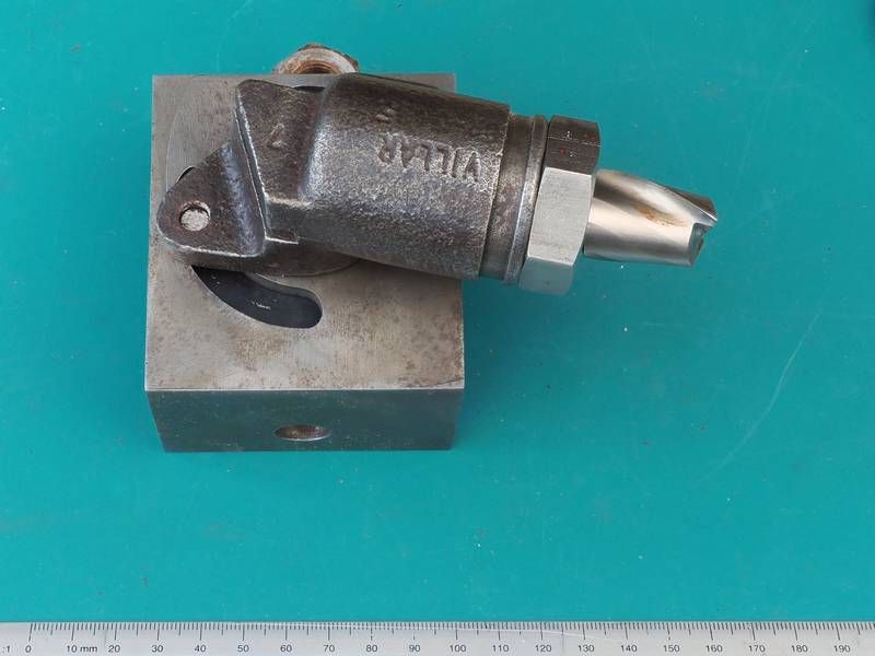

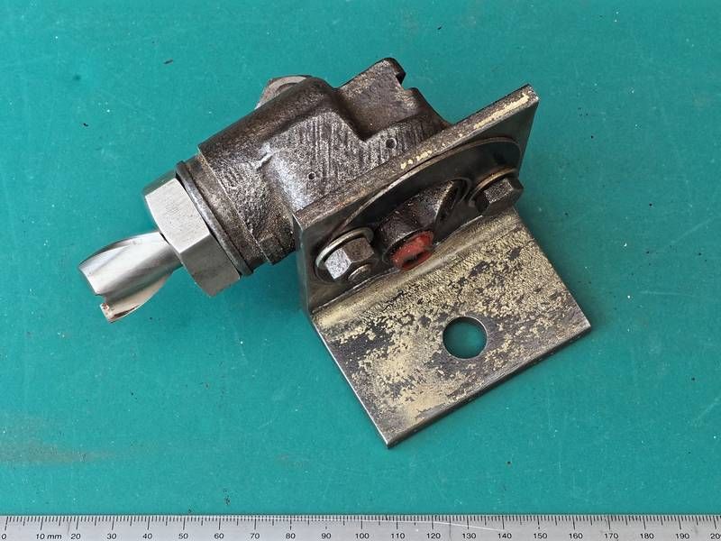

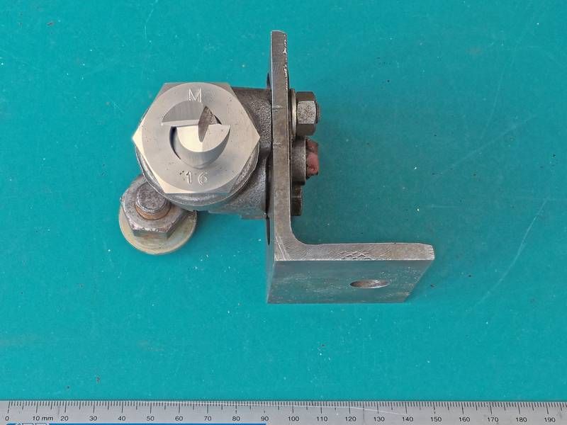

            As I mentioned elsewhere, but I'll add here for others, Bedroom Workshop is a useful resource, but the owner doesn't seem to respond to e-mails
            http://bedroom-workshop.com/
            When I got my machine, out of a skip, it was similarly equipped.
            I was lacking time so did a quick end mill lashup which worked for several years; If I was to reproduce it now, I'f use a single leading shoe brake cylinder with a through hole.
            It's not fancy, but worked fine, and I had everything in stock.
            Each end mill shank diameter has its own collet made out of hex bar.

              There is some work I will need to do to it before it is ready for use anyway. Fit an inverter and since the motor is single voltage the inverter will be 240v to 400v, saves changing the motor.
              The feedscrews are all threaded BSF, 5/8-14, and they all look original.
              The MkII had dials on the infeed and the head elevation can anyone tell me what the graduations on the MkII are?

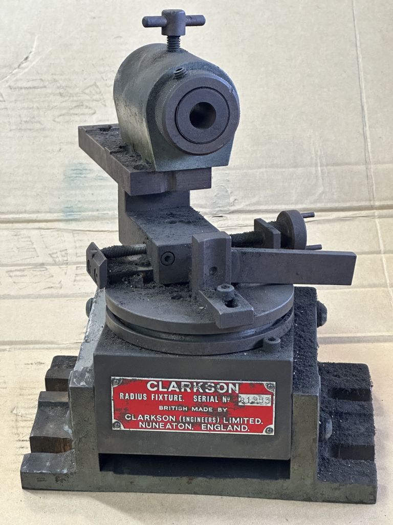

                I made an enquiry with a friend and managed to purchase a radius fixture for the Clarkson for the princely sum of 2 x 24 packs of Speights
                It's a bit dirty but should hopefully clean up ok with a bit of work

                              I have purchased an inverter that is suitable for a 1hp 3 phase motor, it steps up the voltage from 240v to 400v so will run the motor with no problems. The cost of the inverter was NZ$100 including shipping, so most likely less than the cost of a single phase motor to convert it to single phase.
                              Since I don't have the cover where the switches go I will have to make one, so I measured the existing hole and by extending the opening down I can fit the inverter to the back of the cover I make and fit a start and stop switch above it then fit the cover. This will hide the inverter inside the stand and enable me to use the existing 3 phase motor or fit a .75hp in place of the 1/2 hp motor if I want to in the future.
                              If I did that I would add a speed control to the inverter and adjust the rpm to give 6000rpm.
                              The universal head is one of the things I am looking for, then I will need to make some sleeves to hold the cutters, I'm assuming the same sleeves are used for the radius fixture as well. I'm also looking for the vise and any other accessories, they aren't very common here in NZ.
                              I would like to convert the table to run on rollers, and possibly convert the table movement to wire rope in place of the rack. I think the rack is binding as it feels very notchy when moving the table and you feel every tooth, it makes me wonder if the rack and rack drive gear are original.
                              From what I gather the grinder was part of a deceased estate and dismantled at that time, the person I got it off had reassembled it but didn't have the final bits to complete the job.
                              I have looked at many photos of the radius grinder online and see I am missing a few bits and the bracket the spindle housing attaches to looks like it has been fabricated but it obviously works.

                                  Nice chip out of that cup wheel. Needs replacing before use and a wheel guard would be nice. Not too sure about revving up to 6000 rpm on an overhung spindle like that – definitely check instructions first.

                                                    Well I have the radius attachment stripped down and cleaned up, even the original paint is in pretty good condition.
                                                    All the grease in the bearings had gravitated to the bottom bearing and the top bearing had grinding dust in it, very much like the dust the attachment was covered in.
                                                    I've repacked the bearings, they are unshielded, and refitted the spindle and bearings into the body. I need to make a couple of pieces before I refit the table and other parts.
                                                    Does anyone have the MkII radius attachment?
                                                    If someone does, would it be possible to send me the measurements of the adjustable Z bracket fitted to the dovetail slide and also the bracket that holds the flute support finger.
                                                    The spindle fitted to mine has the 1 1/4" hole, looking at the information online I see there is a spindle that takes 1"OD bushes, I am assuming these spindles aren't easy to come by so will probably have to make one.
                                                    Any information on the Z bracket for the radius attachment would be appreciated.
