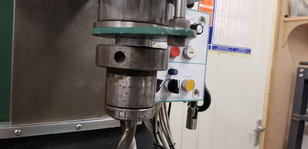

      When I bought the mill it came with a Clarkson Autolock collet type S chuck. I did nothing with it because it only came with 2 collets that were not the size I needed.
      I have been using a ER25 collet chuck up to press with reasonable success. I now have the correct collets for the Clarkson & cutters to suit. Just setting up for tomorrow's task & fitted the Clarkson to the mill.
      On using the supplied spanner to tighten & a suitable round bar in the neck of it, the neck unscrewed. It turned all the way up to the MT2 taper flange.
      Is this correct as it does seem logical that being like this it gives support to the MT2 taper on the end or nose of it. Just not sure this is how it goes having never used one. Any info appreciated.

          Steve, I'm not sure from your description exactly what's happened – but my Clarkson has a threaded nut that holds the collet in – plus it has a screwed outer sleeve that enables the chuck's MT2 taper shank to be withdrawn from the machine easily.
          Is it this sleeve that you are referring too perhaps?

            Yes sorry I was not sure if I wrote it correctly. I have a picture. Basically I fitted the chuck, inserted & tightened the draw bar. Then I fitted a 11/16" cutter to the collet, then screwed the collet in to the main body. The chuck came with a big cast spanner which I tightened the collet in with. But there was no way of stopping the whole thing rotating. I saw it had a collar above the chuck with 4 holes around it. Found a bar that fitted & continued to tighten the collet. But noticed the collar was screwing upwards towards the taper. When it was up to the taper it snugged up against it leaving no gap that my ER25 one does. Picture.

              Steve the chuck you have is made for use on light machines and has a spacial feature – the screw collar at the top of the chuck.
              To use insert into your spindle with the collar clear of the spindle nose, tighten the draw bolt on the top of the machine spindle then screw the collar up to the meekest the spindle nose and nip it up.
              Insert the correct collet for the cutter and screw the locking nut up by hand then insert the cutter and screw it to meet the location point inside the chuck, then back off the losing nut 1/8 of a turn and screw the cutter to meet the point again, now lock the chuck with the spanner. You can of course screw the cutter into the collet first BUT make sure it is not far enough in to meet the location point. Personally i never do this.
              I think i have an instruction leaflet in my workshop for this chuck – will look tomorrow

                John’s instruction might initially seem a bit of a faff, but as the collets are each for one specific size of cutter, you would generally only change the cutter position in the collet when setting it up first time.

                      I'm sure we have been here before but you should not back off the nut (not even an eighth of a turn) before screwing the cutter home against the centre point. There must not be a gap between the nut and the body. The cutter will self tighten depending on how high the cutting forces. The cutter will not screw into the body any further when it does this. All that happens is that when the cutter turns, it forces the collet downwards into the taper of the nut and this in turn increases the grip on the cutter. If you have a gap between the nut and the main body, you will most likely (especially on the 6mm or 1/4" shanks) break out the centre in the end of the cutter when the nut is tightened.
                        Been there, done that and broken the centre end on a 1/4" cutter. embarrassed
                        I'd also agree that there should be no gap between the nut and body. Instructions here:

                              Thank again for all the answers given. It seems the collar is unique for MT2 for stability. The only variation in comments is the technique for fitting the cutters. Some say leave a gap, some say snugged up to no gap. The link shows it been snugged up completely to it's shoulder. It then explains how the bit if it rotates will self tighten if needed.
                              The only downside I can see then is if you have set up to a accurate depth of cut & then the cutter tightens some more. You would then have the wrong depth of cut.
                              Not a problem for me with the bits I have been doing so far.
                              Does this mean if you were to do some exact work, 1st do a test pass on some scrap metal to ensure the bit is fully home.
                              Edit, having read those instructions again it only says that if the cutter tries to rotate is will just tighten the chuck more. The cutter cannot go up because it is already located in its pin.

                                Steamer & Andrew are absolutely correct according to Clarkson but as Nigel & IanT say I too was taught the same way and never had a problem. Another member messaged me and I replied thus below :—
                                I have made an album of the Clarkson instructions all in jpg format so you can read it there. It does in fact say as you do in 1. to just screw the cutter up to the location "point" in the chuck and tighten the lock nut — no backing off !
                                However when and apprentice back in the early '60's we were advised to back off a very small amount so can only assume it was practical experience that was passed on — always did it, still do and its never caused me a problem !
                                The principle of the Clarkson system is that the cutter is self tightening during use and it cannot be driven into or pulled out of the chuck by cutting forces it works extremely well.

                                    I was also told to back off the the nose piece on an Autolock chuck when I started work almost 40 years ago, but it is certainly not the correct method and is unnecessary and not what the designer and manufacturer intended, and I never do it.
                                    The nose piece with its collet should be screwed and nipped up fully up to the shoulder and left there. Then the cutters are screwed fully in until they tighten up, the collets will fully lock automatically when cutting, hence the name Autolock. The shoulder is also a register to square up the nose piece, and the radial register will centralise it to ensure that cutters run true.
                                    Posiloc milling chucks work on the same principle, but the nose piece is located by a taper at the bottom as well as a radial register. So when the nose piece on these is fully screwed up there is always a large gap below the unused shoulder.
                                    I think the upper threaded collar on Steve's Morse taper Autolock chuck can also be used to eject the chuck by screwing it up against the spindle after the draw bar is released.

                                          My impression is that the Posiloc type with the inherent large gap are more likely to split the back end of a small cutter than a "proper" Clarkson. Mine will split the back of a 1/4" cutter pretty much every time if you don't snug the nose piece down first. Firm finger tight should be OK but I always give mine a light bump with the spanner after screwing the cutter in.
                                          Got a nice 4 for 2 Brucie bonus when Paul "I used to be a toolmaker" borrowed my Bridgeport and promptly killed the tail end of two cutters. He was taught to use the back off to a tiny gap method on the Clarkson. Most surprised when I showed him a print out of the instructions.
                                          Issue probably arises because folk tend to think the screw on nose is for tightening the collet. Which you'd expect if it were a conventional collet system. Think ER for example. I blame the Clarkson instructions which never make it really clear that the nose piece unscrews so you can get the collet out to change it making it a structural part that has to be kept properly done up.
