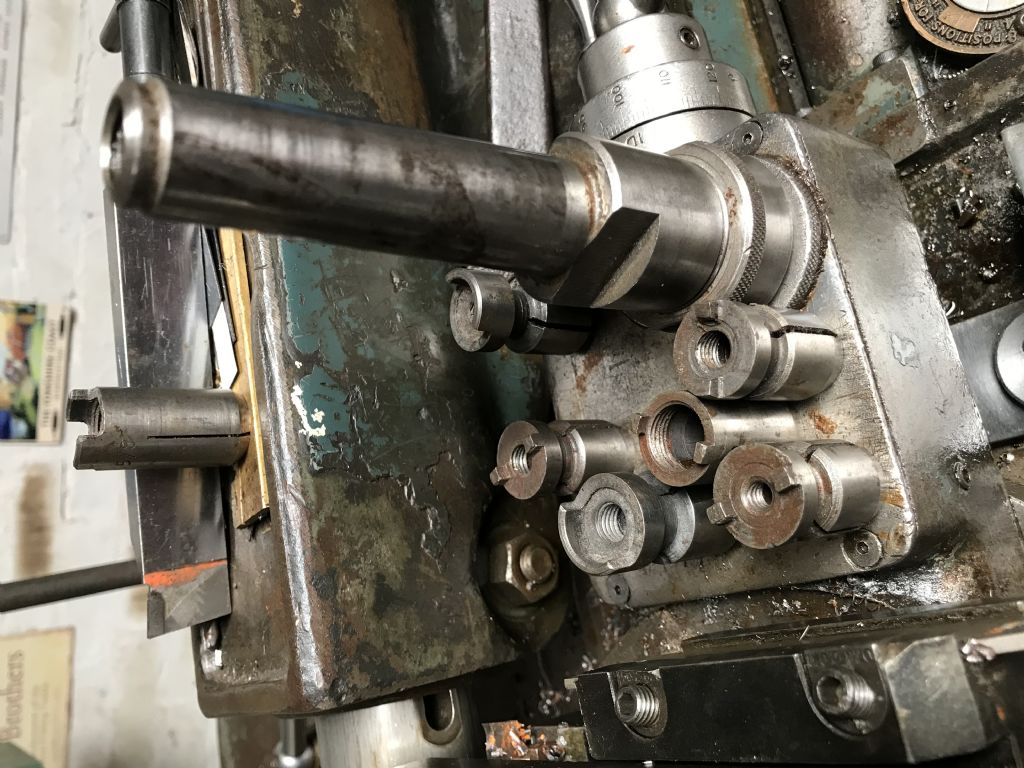

      I was given an old clarkson autolock MT3 that has stamped on the side of it type c c’. it came with the below
      the collets with nibs on are type c, can anyone tell me what the half crescent Collets are?
      i think this is what’s classed as miniature chuck; however I didn’t know they did them with c collets? Am I correct in my assumption?

                      The collets with crescents look similar to the collets from my Osborne Titanic chuck.

                        Agreed, I'll go along with that.
                        Clarkson C type, two drive dogs
                        Clarkson S type two flats
                        Titanic half round drive dog.

                          The half a circle if that is what you are calling the crescent is also Posilok and the unbranded versions sold by a number of our major ME suppliers from time to time.
