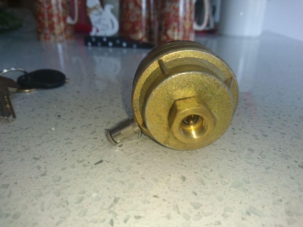

      I've been pulling my hair out trying to tig weld some stainless steel with my new tig welder I've used the welder successfully stick weld and this is the first time I've tried using Tig. I've coupled up with a flow meter and checked there is no leeks in the connector. I've screwed the regulator into the bottle opened the valve and the flow meter and there is no gas flowing the instruction on the bottle says " If the gas does not flow when the regulator is opened unscrew the regulator and screw down again until the gas flows. I've trued this countless times I've even bought a new bottle and this is the same.
      I've checked the regulator and the flow meter and they are working correctly so the fault must be from the bottle.
      What am I doing wrong or is there a fault with the bottle has any one else experienced this problem

          I hardly dare to suggest this, but … Have you checked the gross weight of the bottles ?
          It sounds suspiciously like you may have been sold a couple of empty ones !

            My first thought was that the fault is with the regulator opening the valve on the top of the bottle. Here's a picture of the interface between the bottle and the reg'
            You can see there is a small peg poking out of the middle of the female thread, this lifts a corresponding peg in the centre of the male thread on the top of the bottle. Without both pegs the valve will stay shut.
            That peg sticks out maybe 3 mm beyond the O ring mating surface. It's fixed in place – it's the one in the top of the bottle that moves.
            You can tell if the bottle has got anything in it by pressing the valve stem – the centre portion about 4 mm dia – with a suitable prodder. Onn the bottle I've just tried I had to push really hard to move the valve stem.
            HTH Simon

                  The simple regulators supplied with this type of welder don't have gauges & are not adjustable – the knob is just an on-off valve.

                      How did you check the regulator worked?

                              Here in NZ, both from the same supplier, I can get either a disposable bottle with 242 litres of gas for NZ$98, or a refill of 1000 litres on a refillable bottle for NZ$80. Obviously UK prices are likely to differ, but I suspect the savings will be of the same order, eg 4 times as much gas for much the same price.With the deal here, you do have to buy the bottle, which is then swapped every time you need to fill it. This does mean that you don't have to worry about testing the bottle eventually. The refillable bottle, which comes full, costs NZ$300, which means that it is cheaper than the disposable even if you bought a new one each time, eg the gas equal to 4 disposables for the price of three. But then when you swap it, you get the equivalent of four disposables for less than the price of one.

                              As to the original problem, I suspect that the bit on the regulator is not poking in far enough to open the valve on the bottle. If that is the case it should be possible to get a refund on the grounds of not fit for purpose.

                                Posted by Dave Halford on 15/05/2021 17:52:57:
                                Thanks for all your help and advice chaps.
                                Dave:- I checked it with compressed air but read on.
                                The bottles are full checked them by compressing the valve with a nail.
                                Just screwed on the regulator without the pipe connection and it worked screwed the pipe connector on and it didn't repeated the checked and it worked/failed each time. The pipe connector is one of those where you push the plastic pipe in and it self locks checked connector with compressed air and it was ok. The only thing I can think that is happening is that the hole in the connector is too small (Less than 1mm) so the back pressure is stopping the regulator doing its job.
                                From all the comments these regulator are a source of trouble so I've just ordered another type of regulator.
