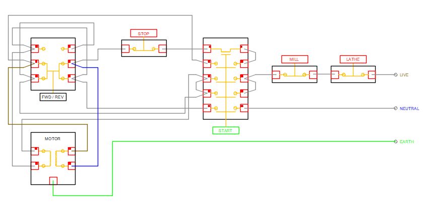

            #499812
            Adam Smith 13
              @adamsmith13
              Hi all,
              I originally started this thread and completely forgot about it. I did get my lathe running and made my own wiring diagram of how it was wired, I agree with the comments above, I am an Electrical & Control System engineer and read schematics all day long but the one provided lost me. I decided to create a very simplified one of how my Clarke CL500 is wired and hopefully this will help you with yours.
              Hope this helps.
              Adam

                William Beck
                  @williambeck
                  Hi guys, thanks for your responses.
                  Adam, that diagram is a great help and matches what I've found so far with my multimeter

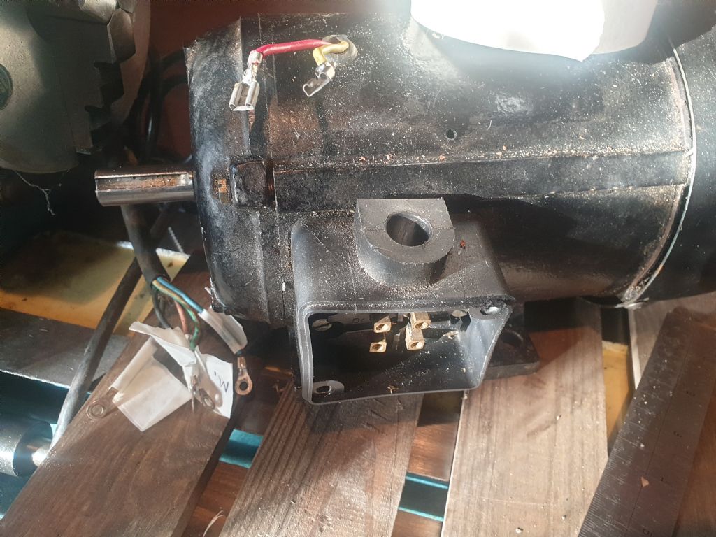

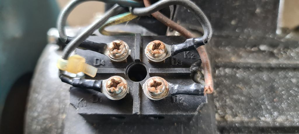

                          This is my control box and motor terminations

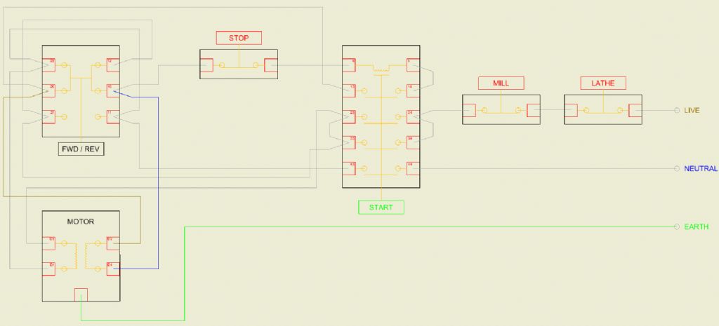

                          #499903
                          Adam Smith 13
                            @adamsmith13
                            I have also just realised there was no terminal numbers on the previous wiring diagram as we can only upload in .jpg format and the resolution was not high enough.
                            although this isn't a great quality version.
                            I would send / attach a .pdf but I am not sure how on this forum.
                            Edited By Adam Smith 13 on 06/10/2020 15:13:58

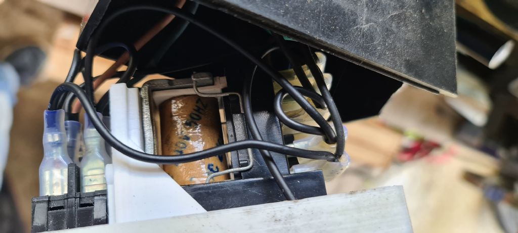

                            #642487
                            David Ball 6
                              @davidball6
                              Hi noob here, bit late to the show but I have just removed my switchbox and can tell you exactly how it was wired if you want?
                              two motor wires essentially go straight to switched mains, the other two appear to be field windings that can reverse polarity through the direction switch.
