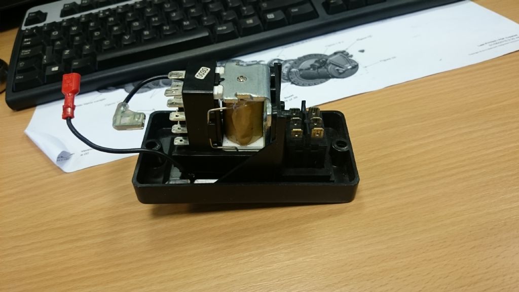

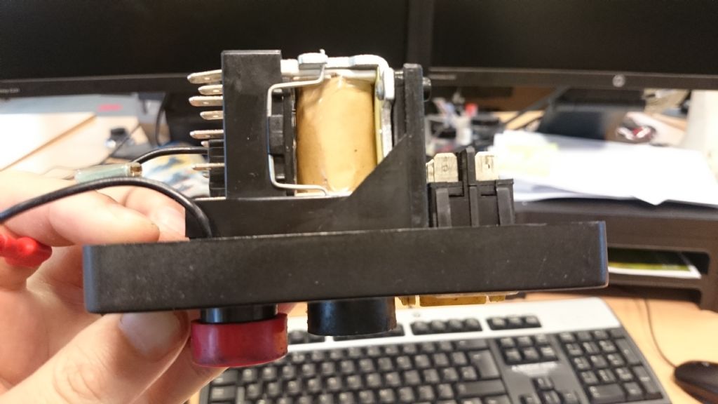

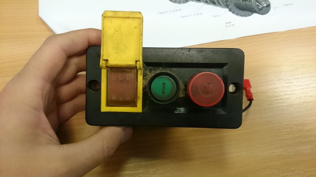

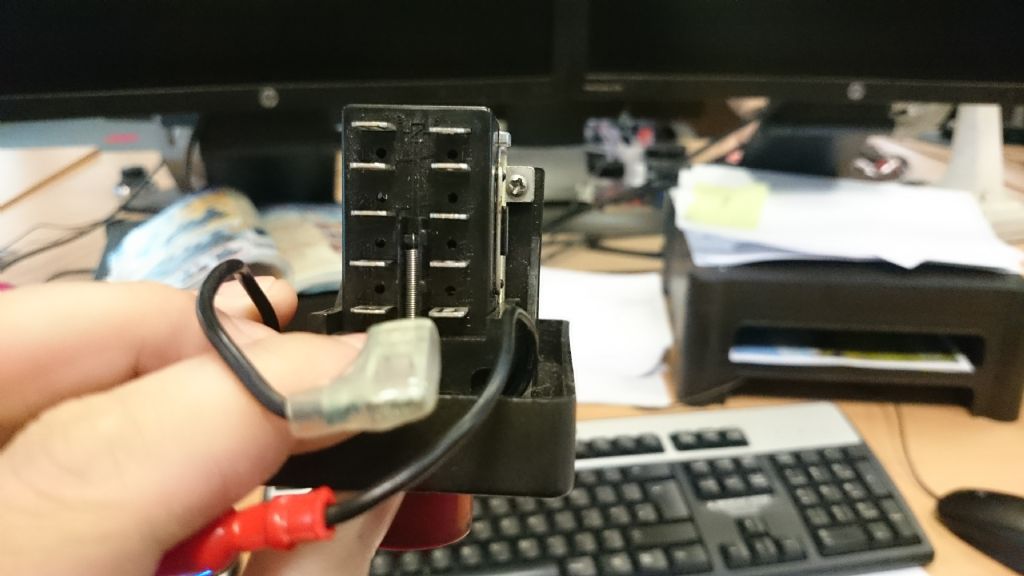

      I have recently acquired a clarke cl500m lathe. But the switch had been ripped off and the manual is as good as a chocolate tea pot for rewiring it.
      Can anybody give me detailed wiring instructions on what goes where or better pics of behind the switch panel.
      It is the standard setup. With revers switch and push start stop relay switch and 4 wires to the motor.
      Many thanks in advance.

        #193604
        Carl Wilson 4
          @carlwilson4
          Can you post a photo of the switch? it might help. By the way, I've got a fixed steady for your machine, if you are interested in it.

          #193646
          Simon Daniels
            @simondaniels16051
            Thanks for the reply. I have uploaded the pictures to an album in my profile if this helps.

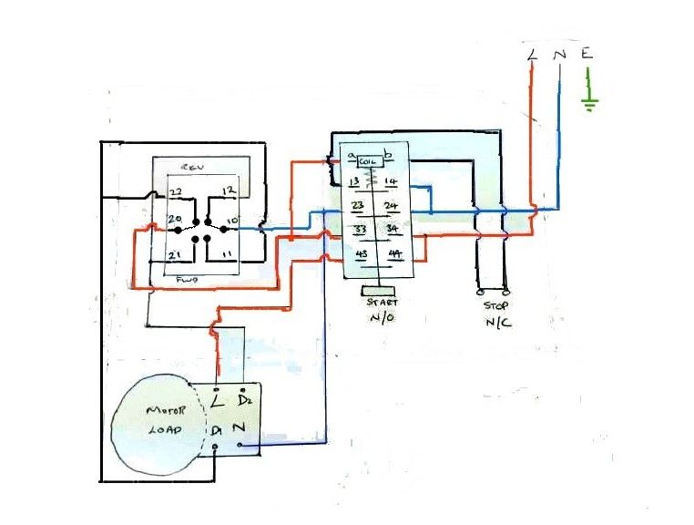

              Carl Wilson 4
                @carlwilson4
                Hello Simon,
                Right…if your switch is the one shown in Ady's pictures above, then it is similar to the one on my Chester Mill/Drill. I rewired this and drew a diagram. Unfortunately I am currently aboard a ship off the coast of Angola…and my diagram is in my workshop in the UK….not in the notebook I brought with me as I'd thought. Dreadfully sorry about that.
                I may be able to fathom it out and rest the details from my creaking memory, if I give the photos a damn good stare. So I'll try that….

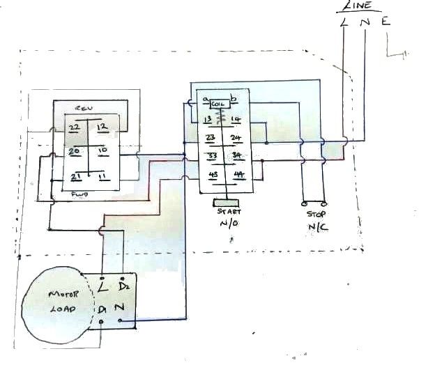

                #193679
                Simon Daniels
                  @simondaniels16051
                  Pm’d
                  I have also added what I think will work wiring wise if anyone is save let me know what you think, will it work.
                  Thanks.
                  #193686
                  Ajohnw
                    @ajohnw51620
                    I can explain the principle these work which might help.
                    If there is a rupture type emergency stop switch the mains goes in through that. Rupture as the force on the button is sent straight to the contacts so they may open even if slightly welded.
                    The general idea is that the whole lot defaults to off if the power fails so the on button energises the really coil and contacts on the relay latch the coil on. The stop switch is in the relay latch circuit to that when it's pushed it deactivates the relay. The machine is powered via other relay contacts. It should provide both live and neutral to the machine via the relay
                    2 arrangement are shown here less powering the machine but check what I have just said in case there is an error. Doesn't look like there is

                            john swift 1
                              @johnswift1
                              after looking at Simon's wiring diagram
                              I have revised the diagram after correcting the FWD/REV switch –
                              ( in the photo it looks like a 2 pole toggle switch)
                              Edited By john swift 1 on 12/01/2018 21:56:27

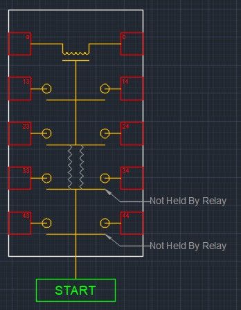

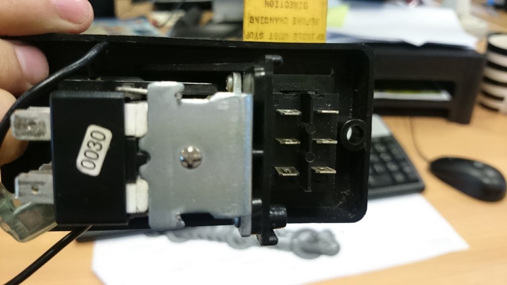

                                  #427460
                                  Adam Smith 13
                                    @adamsmith13
                                    Hi I am looking for some help and advice. I have recently been given a Clark CL500M Mill & Lathe. However I am having problems with the electrical side and there seems to be a complete lack of information other than on this forum.
                                    My current concern is with the Relay Start Switch. All the diagrams I have seen show the coil and 4 seperate contacts that are held closed by the coil. My coil (although looking like those above in ADY1's pictures) only holds contacts 13 & 14, 23 & 24 closed while the push start momenterily closes 33 & 34 and 43 & 44 on press.
                                    I am leaning towards my relay is faulty, however I dont want to spend the £50 with clarke if it isnt the relay and I have a different fault causing my lathe not to run. I guess I am wondering if anyone on here can confirm that when there coil is energised that all the contacts are definatly held closed?
                                    Thanks in Advance!
