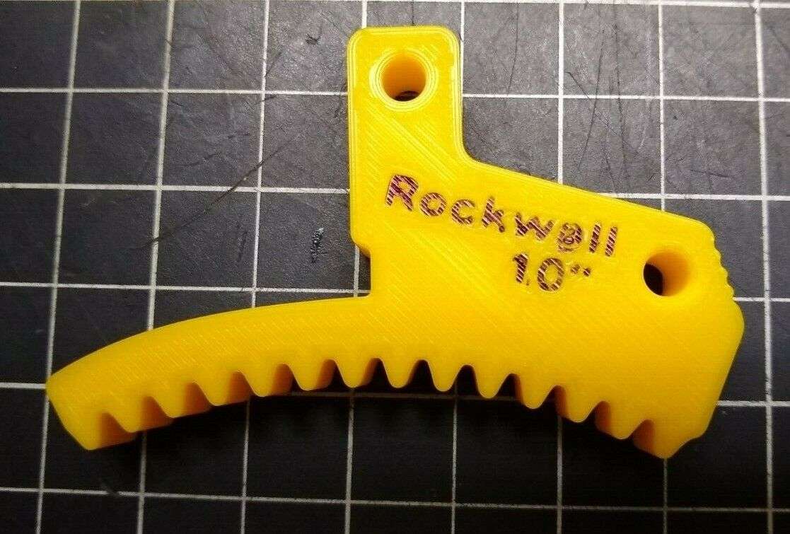

      Stopping the lathe chuck from rotating (for using hand tools e.g. Tapping) on this lathe is a pain.
      I’ve been using a bar in the chuck-key hole to stop it from rotating reverse (which falls out as soon as opposite movement, e.g. backing-off) and a piece of wood on the chuck jaw to stop forward movement, with the same annoying results.
      I see lots of gear chocks for Myfords, etc. (see similar below) but nothing for a Clarkem lathe.

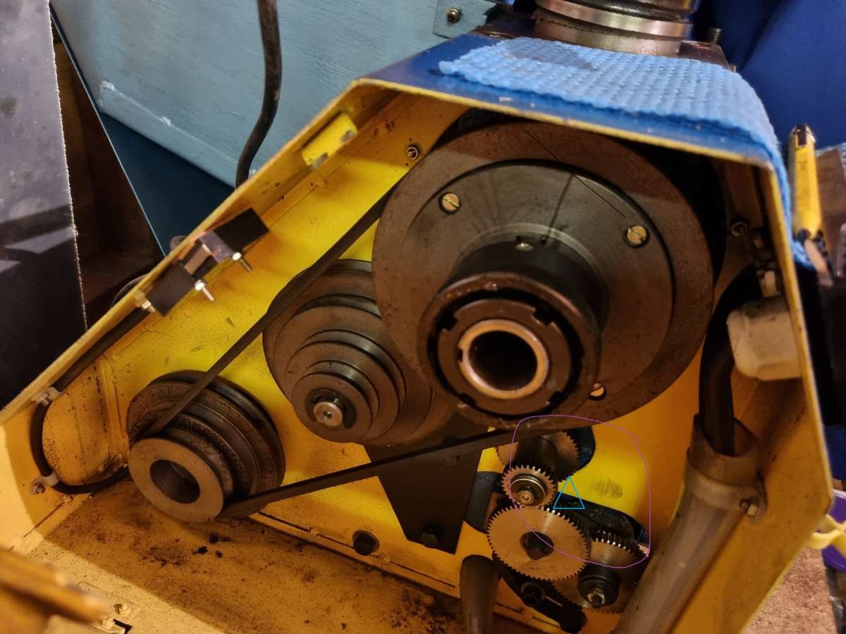

      The Clarke CM500M gears pic below.
      Does anyone have a simple solution (save me over-engineering something)?

                That plastic part is not for locking chucks, it is for holding threaded spindles whilt the chuck is being removed. You could probably use one in the reverse direction when replacing the chuck as long as you did not spin it up to the register. That would overtighten the chuck and make it very difficult to remove at a later date. The lock greatly reduces the danger of breaking off teeth by hamfisted force.
                On your lathe, I would remove the large pulley on the spindle and drill a couple of pin holes and make a large pin spanner to fit it, but I have access to mills and facilities to carry out such work. There might be a much simpler method, but I cannot see the right hand end of the spindle. Please add a photo.
