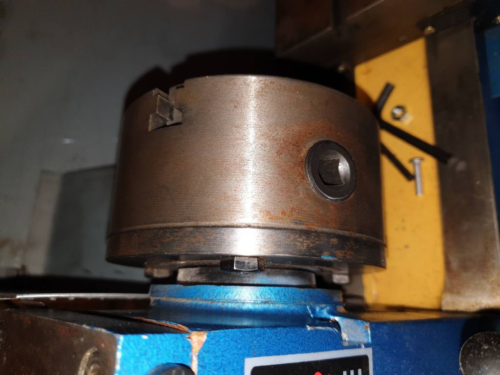

      Posted by Danni Burns on 15/05/2021 15:07:28:
      Thanks Stu
      Its not making perfect sense at the moment.
      I can see you've gone from 4 bolts in 4-Jaw chuck bolts to 3 for connecting to headstock
      What are the half threads for on the ID (is there 4 of them)? probably associated with the 4 bolts on new Chuck?
      Im sure it'll all make sense when I take the 3 jaw off.
      Thanks for sharing
      ..yes, they are the back end of the 4 bolt holes that hold the 4 jaw to the back plate
      Stu

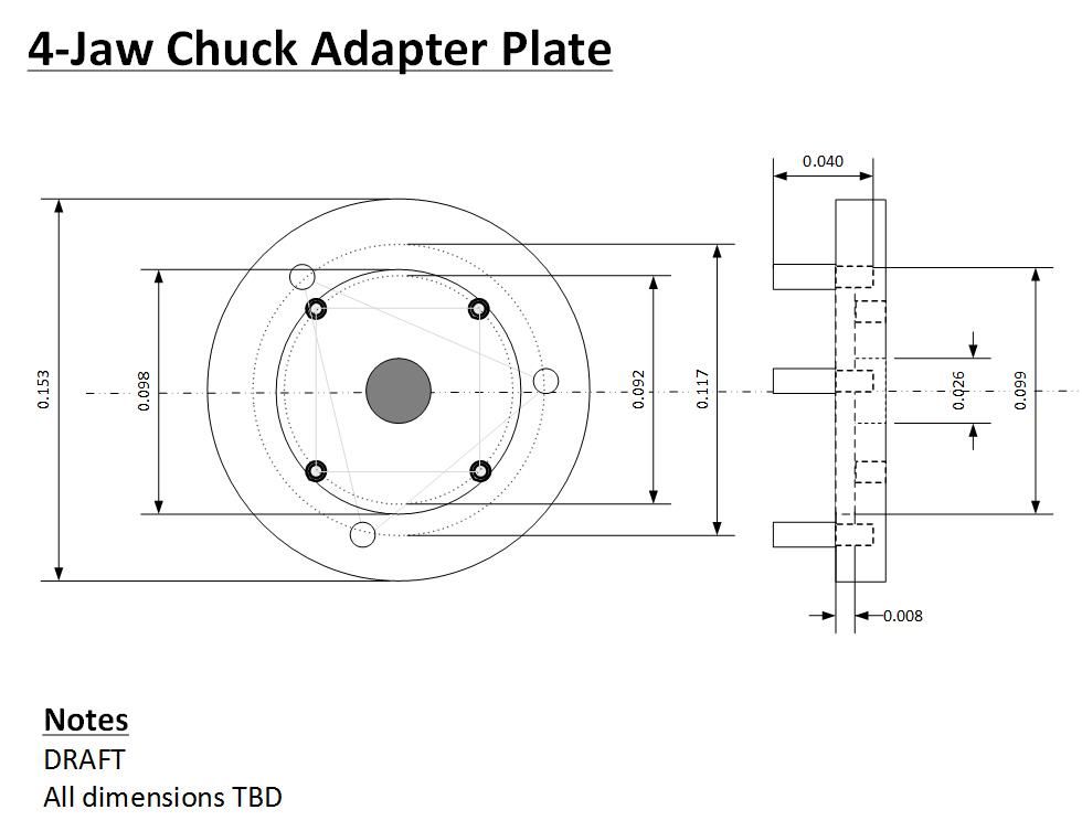

                    #546170
                    Danni Burns
                      @danniburns84841
                      Thanks Stu
                      Its beginning to make sense now. Are the 3 Threads in your photo studs?
                      I havent measured anything yet, but I this is my current understanding of the plate design.
                      Do let me know if you see anything glaringly incorrect.
                      Thanks

                          Looks fine to me! The only thing I can't see clearly on the cross section is the recesses for the lathe mount and chuck mount but I see they are marked on the front view. Yes I put studs in the back as its easier when you sit the 4 jaw in place then spin some nuts on than trying line up the bolts while supporting the weight of the chuck. It's a useful thing to do on the 3 jaw too if you haven't already.
                          Stu
                          #546180
                          Danni Burns
                            @danniburns84841
                            Hi Stu
                            That's the 0.099 and the 0.008mm on the side view
                            You cant see the top line as its covered by the top stud. It got a bit congested to add any further detail.
                            I feel now if I exchange all of the dimensions for actuals I will have it sorted.
                            BTW I have never taken the 3-Jaw chuck off. I will obviously to get the dimensions.
                            I'm guessing those studs should be High tensile steel as well? Probably buy some bolts and cut down.
                            thanks

                                  Danni, you will need about 20mm starting width from which to machine a 4mm recess and a 4mm boss, whilst leaving enough meat in the middle for the chuck attachment screws ( because the recess coincides with the attachment screw threaded holes). Full chuck dimensions are on some ebay listings.
                                  #546189
                                  Danni Burns
                                    @danniburns84841
                                    Thanks Martin – pubs are open as well
                                    John – Hi and Thanks again. So Recess on one side (where i have 8mm) and Boss on other side where I have flush. Is that correct?
                                    If all holes are coinciding with recess – best to drill those first.
                                    I have just looked on vevor where I bought and not enough details – to make a drawing anyway. It is definitely Cast Iron though. Will look on ebay and double check on actual before starting.

                                          Yes that's right. It's easier to slide the studs through the holes which will then help support the weight of the chuck while you fit the nuts on to the studs.
                                          Ref your drawing, as John mentioned it is important you have a boss on the front of the back plate you're going to make so that it centralises and supports the 4 jaw chuck, just like there is on the front of the lathe chuck mounting plate. That's what I couldn't see on the cross section in the drawing.
                                          Once you remove the 3 jaw chuck you will see the boss and the recess to take your measurements from for the rear of your new back plate. For the boss on the front of the back plate you need to measure the recess in the back of the 4 jaw chuck.
                                          Hope that makes sense, I'm not particularly great at explaining things!
                                          Stu

                                            Yes. Makes sense. I think doing the drawing was worth while now.
                                            I will measure all up and modify the drawing. I'll ask you and John to check then. Hopefully other will be able to use.
