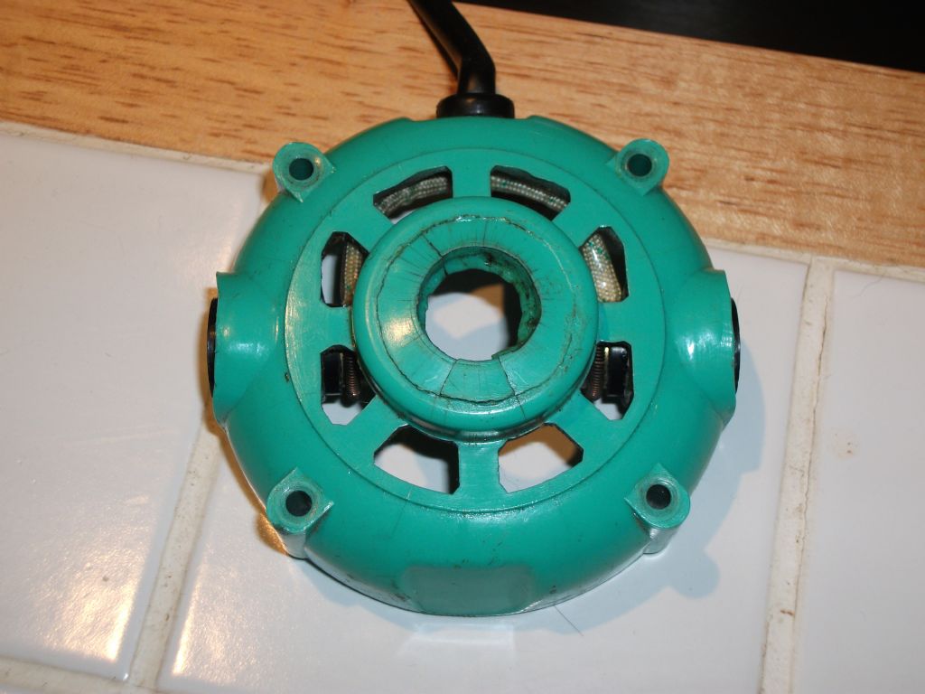

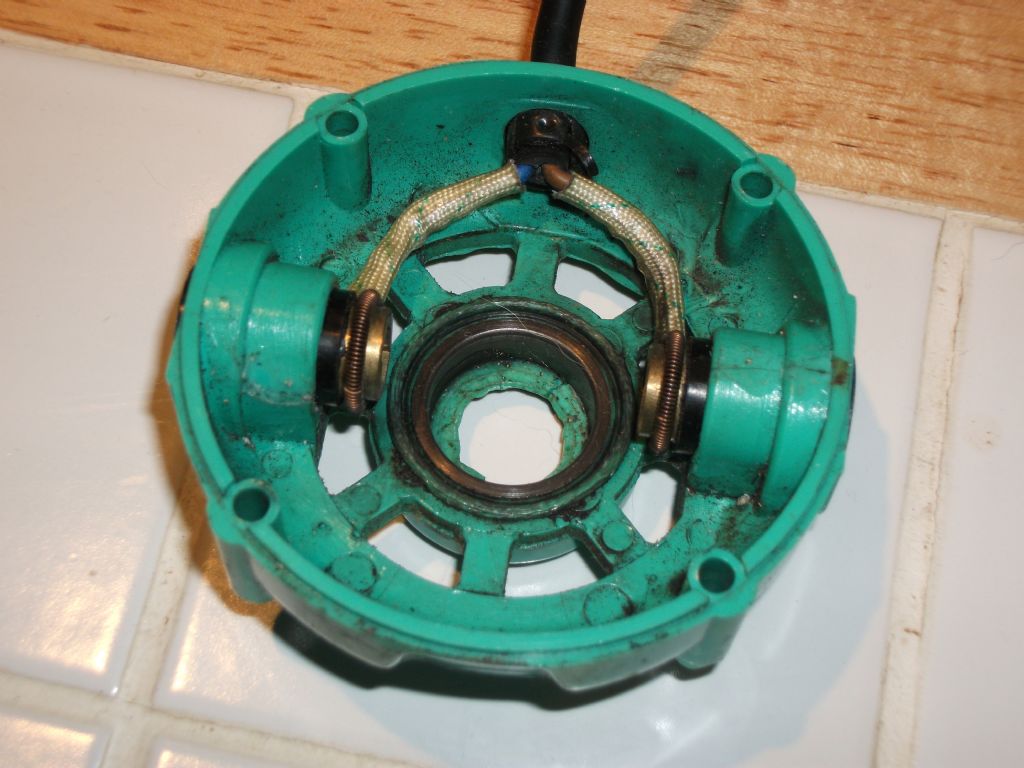

                                      #94500
                                      graham bartram
                                        @grahambartram66629
                                        lathe motor cover 002.jpgHi,
                                        Please see photos – I'm looking to buy a plastic end cover for the motor of the cl300m. If anyone out there has one they'd be willing to sell, could you please let me know? Cheers, Graham
                                        #94827
                                        Sub Mandrel
                                          @submandrel
                                          Hi Graham,
                                          I have converted my CL300M to use a 1/3 HP Hoover Fractional motor, so I have exactly what you need!
                                          Send me a personal message using the'message member' function and I will give you an address to post me a suitably large stamped jiffy bag, and you canm have it for free.
