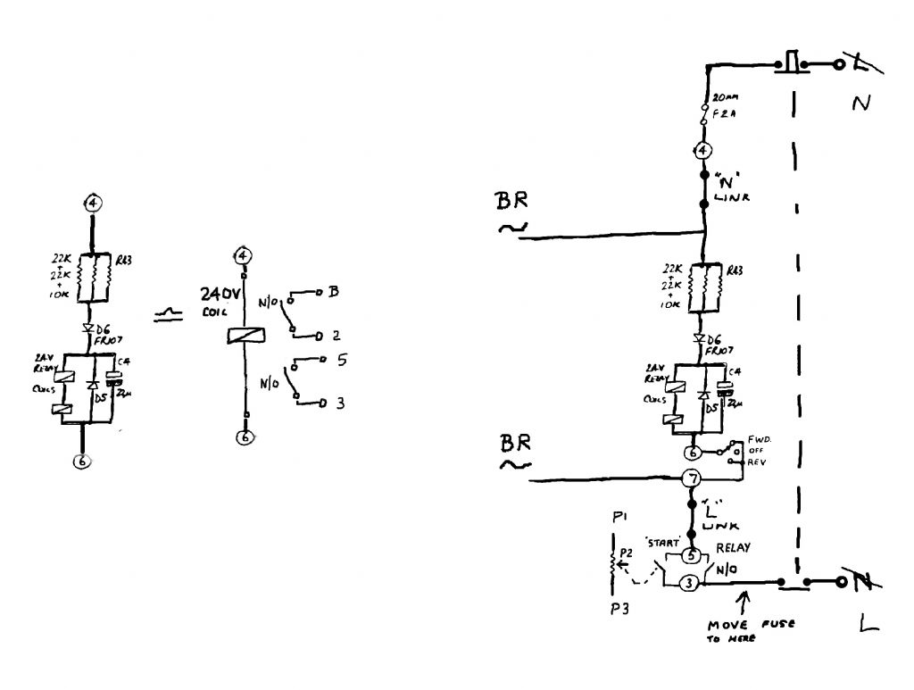

                                  #76119
                                  john swift 1
                                    @johnswift1
                                    Hi Kiaran ,
                                    with the switch closed and a direction selected
                                    the relays normally open contacts close
                                    one connects the positive supply to the motor
                                    and the other is in parallel with the switch on the speed control ( terminals 6 & 7)
                                    this maintains the circuit when the switch opens as you turn the speed up
                                    the resistors R43 and diode D6 enable two in expensive 24V dc relays
                                    to be used instead of a more expensive two pole main operated relay
                                    PS points BR are the DC supply to the controle circuit
                                    Edited By john swift 1 on 10/10/2011 20:03:01

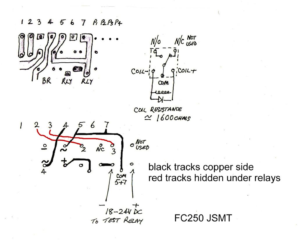

                                      #76124
                                      john swift 1
                                        @johnswift1
                                        Hi Kiaran
                                        it looks like one relay is faulty or the printed circuit is open circuit
                                        see if you can check the connection form terminals 3 and 5 to the relay
                                        in the diagram below
                                        the track ( in red) from AC3 to the relay is hidden
                                        you should be able to see terminals 5 and 7 to the relay common
                                        Edited By john swift 1 on 10/10/2011 22:34:00

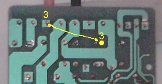

                                        #76132
                                        Kiaran Walker
                                          @kiaranwalker64939
                                          John,
                                          Connection from 3 and 5 to each test point is ok, one having a very slightly higher value, also got the same reading between 3 and 5 and the left RLY in the top pic. but nothing between 3 and 5 and the relay common.
                                          Kiaran
                                          #76133

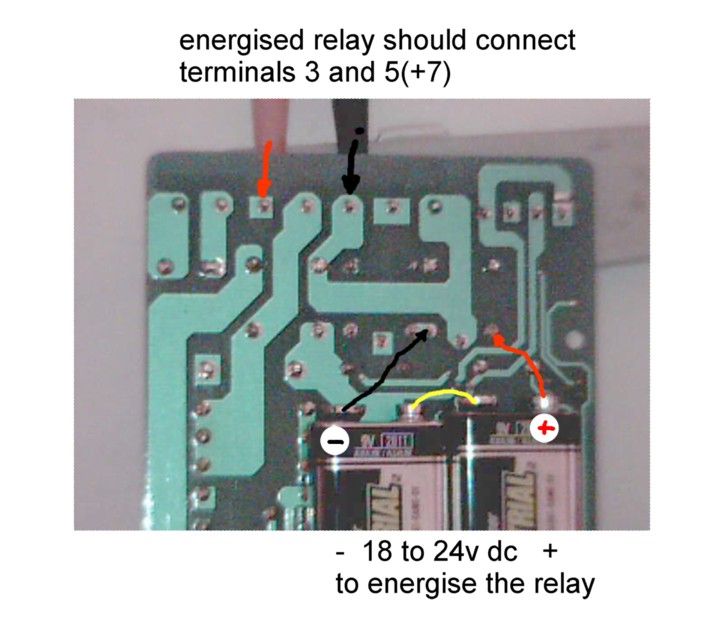

                                          john swift 1
                                            @johnswift1
                                            Hi Kiaran
                                            I have managed to get a picture of the board that shows how to test the relay
                                            #76136
                                            Kiaran Walker
                                              @kiaranwalker64939
                                              oops, thanks john,
                                              now I see a bit clearer, I can energise the relay and get a connection between the two 3’s on the yellow line, 3 + 5 show a connection with the relay energised or not, this is with the pot. switch off or closed contacts.
                                              Kiaran
                                              #76137
                                              john swift 1
                                                @johnswift1
                                                Hi Kiaran ,
                                                start with the board as in the second picture , you can connect your multimeter
                                                across terminals 3 and 5 , to test for continuity
                                                (I fitted the probes under the wire clamps)
                                                with an external DC supply , as shown across the relay coil ,( two PP3’s will do)
                                                the relay should connect terminals 3 and 5 together
                                                if this works ,when the board is reinstalled
                                                the relay contacts are connected in parallel with the switch on the back of the poentiometer
                                                when the relay is working correctly , it maintains the power when you move the control clockwise and away from the anticlockwise end stop
                                                the switch is now open but the relay connects terminals 3 and 5
                                                think of the speed control switch being like the green start button on a
                                                direct on line starter, its closed just to start the motor
                                                PS    the yellow line just shows the hidden printed circuit connection between
                                                         terminal 3 and the tag on the relay
                                                Edited By john swift 1 on 11/10/2011 16:57:15
