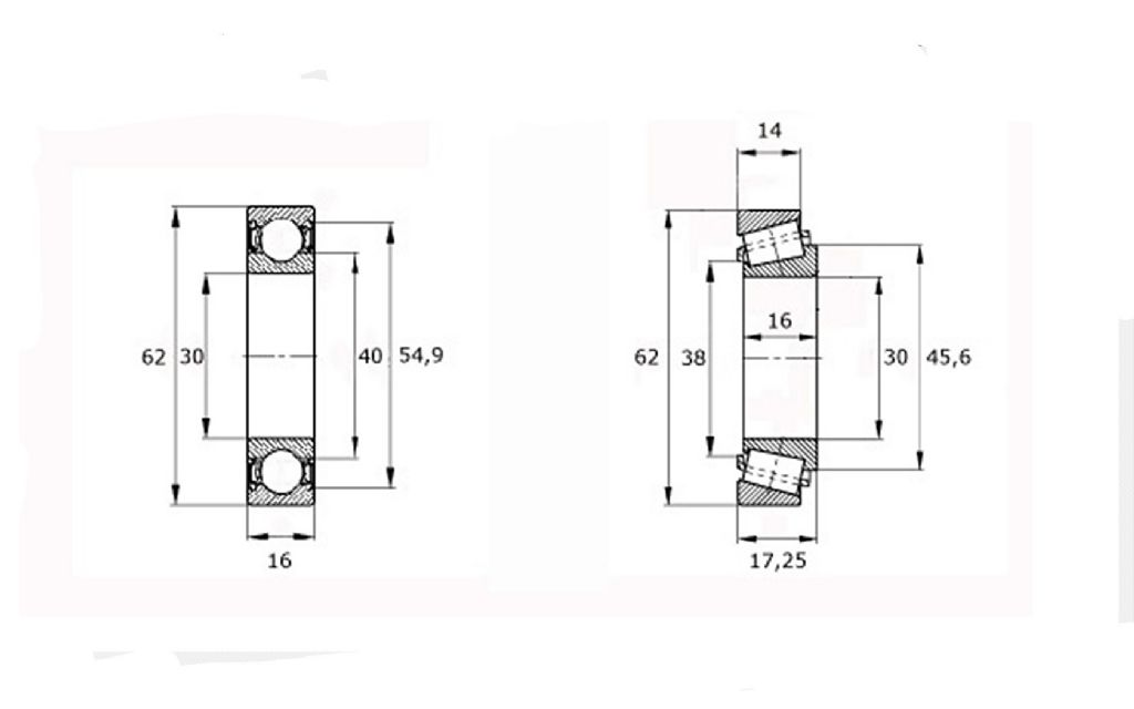

          the greatest improvement I've made is to replace the spindle bearings with taper roller bearings from Arc Euro Trade
          see arceurotrade.co.uk/projects.aspx
          unless you have another lathe , just ensure your make the new longer spacers before , you  remove the spindle ! ( the centre of the roller bearings are off set by about 1.25 mm
          the  new roller bearings and new gibs solved my problems with parting off and improved the finish (both being sold as spares for the C3 lathe

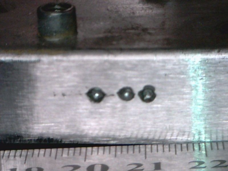

           PS        I'll take a picture of the three detents on my lathe
          the neutral position  is not half way between the others , its closer to the reverse position

            missing pictures
            the neutral detent is about 3.6 mm from the reverse detent and about 4.9 mm from the forward detent
