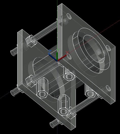

        I”m trying to come up with system to clamp these two plates onto the spindle carrier . I”ll be using a slitting saw to cut the slot so the plates (in theory will clamp tightly onto the spindle carrier) ,I”m going to be making spacers for between the plates ,the bottom plate will be threaded .I”m crap at describing lol .

          Hi Sean I would make an aluminium spacer with a split clamp through and then screw through the plates into the aluminium spacer to clamp the spacer between the two plates. The aluminium spacer would give bulk and carry away any heat from bearings as well. Make the aluminium spacer the same diameter as the square plates and use substantial cap screws to clamp spindle and fit a grub screw to Jack the gap open to help disembley .

              You could do it without splitting and put a large grub screw in each side at the narrowest point to bear against the tube.
              Or if you are going to split it then just drill a hole in from one edge to the saw cut, do the same from opposite sid eand tap then use a pinch bolt to tighten it up

                    Thanks for all the input,welding the plates is not an option I fear ,warpage would be an issue . Aliminium spacers might be an option but will they be ridgid enough . I’m liking the grub screw at the narrowest point . The plates are a really nice snug fit on the spindle holder .

                      I think the following sketch drawings may suggest an alternative that will give a very rigid result.
                      Just drill and tap the front plate 4 x M12, Drill the back plate with 4x12mm holes and use M12 rod and lock nuts to carefully set the position of the plates.
                      Now insert your spindle unit.
                      Finally clamp two sides and a bottom to the unit to make a mould they can be anything that comes to hand, but before you attach them coat the inside surfaces with wax to stop epoxy sticking to them. OOps I have given the secret away. The unit will be filled with epoxy resin and bone dry sand, about 15% epoxy by volume, not that much really. I used this process to build a small grinder a while back. I use it almost every day to grind my lathe tools.
                      **LINK**
                      You will notice in the second see through illustration below I have added 4 long nuts for a possible base mounting point. You can cast attachment points anywhere you choose, just screw them to your mould plates in the correct position when set just remove the screws.

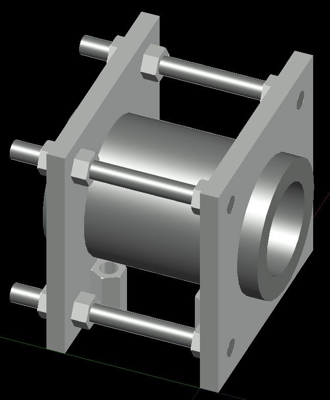

                          Made a bit more progress on the clamping for the spindle .
                          Spacers
                          Cutouts for the bolts . I don't have a tap long enough to get in to thread ,so I'm going with a through nut and bolt .
                          Used the 3" slitting saw for the cut out and an end mill to clean up the corners .Have to say that the slitting saw blade was no where near round (new blade) ,the 2" smaller blade I have is spot on .
