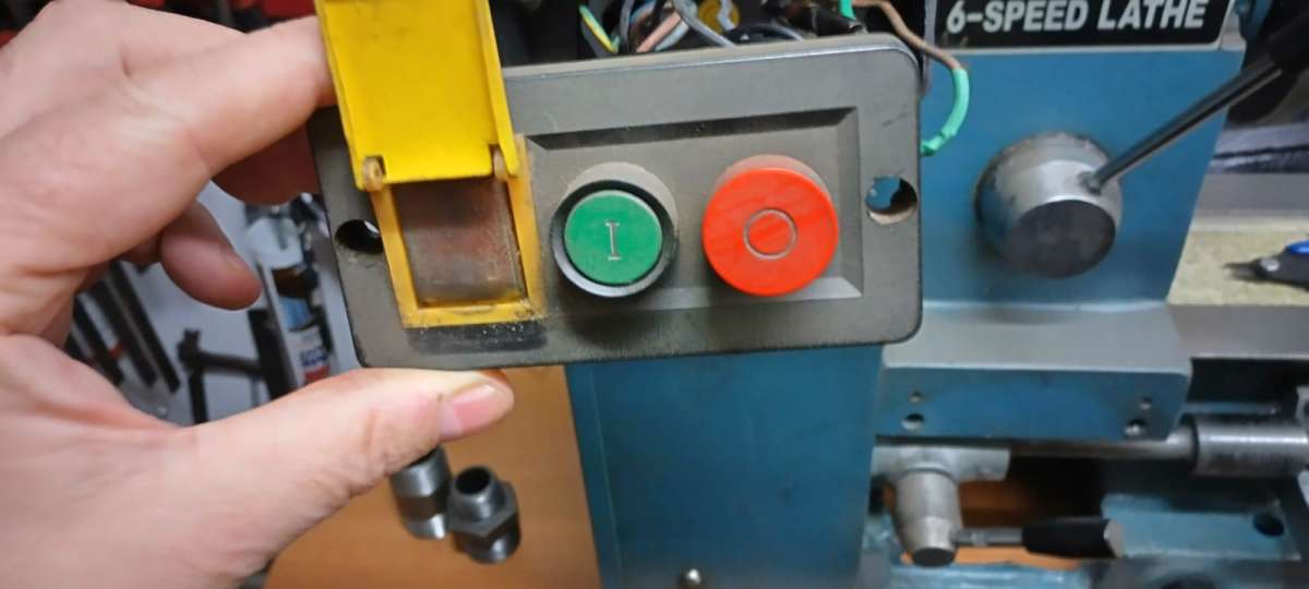

      Hi everyone
      I’m going out on a limb here!
      I am trying to get a new switch block for the (lathe that shall not be named!) but incase I can’t buy one has anyone done a manual wiring setup?
      I have the wiring diagram from an amazing person on Youtube but am hesitant to try as it appears to have a big capacitor/resistor in the switch mech
      Thank you for any help
      Gary

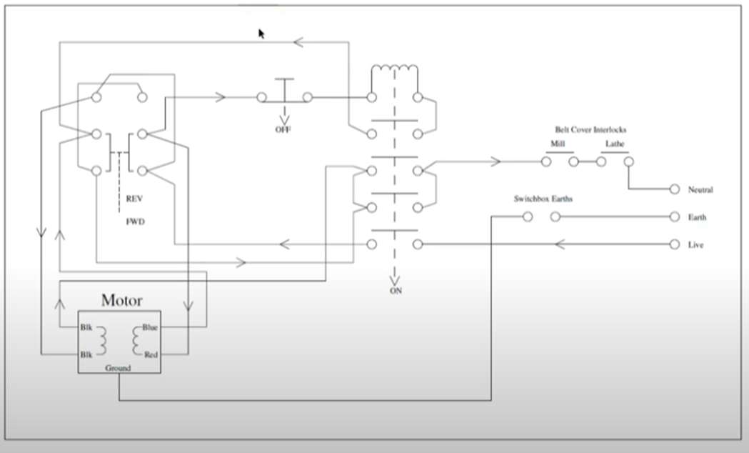

        Gary Lynch
          @garylynch39491
          PS just in case it helps someone else.
          Does a Warco WMT300 have the same switch?
          Here is the wiring diagram
          CL500mWiring
          #768483

                #768493
                noel shelley
                  @noelshelley55608
                  Forgive me but I see No resistor or capacitor in the diagram which seems simple enough. Noel.
                  AH yes, as a single phase motor there could well be a start capacitor, but the resistor ? VFD and new motor would be an expensive way to fix the switch. N

                        Hi Gary, don’t assume anything – it’s a mystery at the moment.  Can you post a photo of the item please.  The circuit diagram doesn’t show it, and your description doesn’t help.  I think the circuit is incomplete.  A picture is worth a thousand words.   Any markings on the alleged capacitor?  Might be a filter capacitor, which is completely different from a motor Start/Run capacitor.
                        And which switch do you mean?   The diagram shows a reversing switch, two interlock safety switches (boxed in Green below) , and a bunch more built into the contactor (blue box).   If by “Switch Block” you mean the contactor, much easier to replace these as a component than to do the same with manual switches.
                        cl500
                        Needs to be understood before proceeding.  I’m sure we can help but more info needed please.  I’m baffled!
                        Ta,

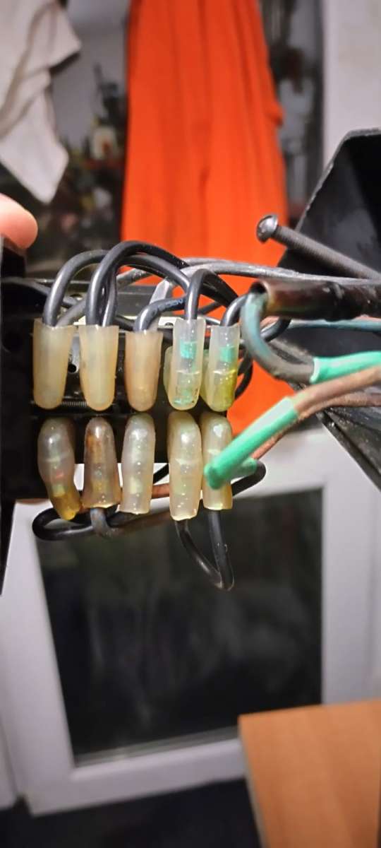

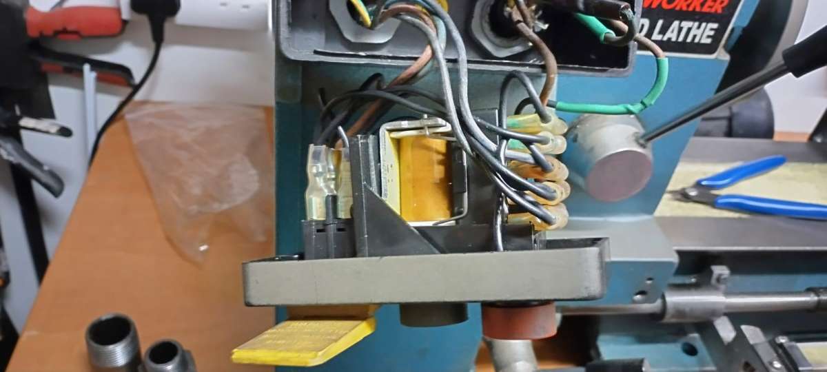

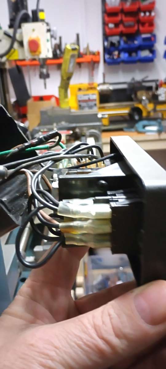

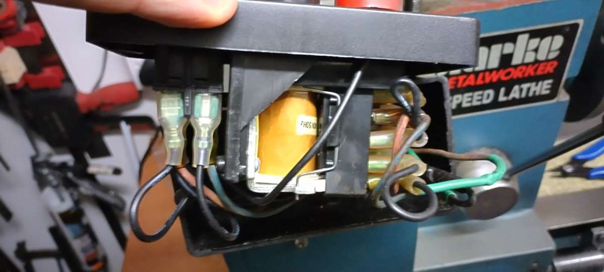

                          HI Dave
                          Apologies for the slow reply, unfortunately I had the Noro bug going around 🙁
                          I took the pictures
                          Frt Front  – Stop, Start, Direction Switch
                          top Top View
                          bottom Bottom View
                          rightside Right side view
                          Leftside Left Side
                          PS I removed the Milling Head Micro switch and checked with meter and thats all fine.
                          Thank You Dave
                          Regards Gary

                            #769353
                            Robert Atkinson 2
                              @robertatkinson2
                              Apart from anything else, the control panel wiring is showing clear signs of overheating damage. In paricular the push on crimp terminals. You can see that a number of them have turned brown due to elevated temperature.
                              I’d suggest that the lathe needs a new panel and a re-wire. The overheating oxidises the conductors making it hard to get a good contact even if cut back. The insulation is also damaged and can fail, possibly later. Anything less than replacement and re-wire will almost certaily fail in the future. The failure could be dangerous.
                              The motor need to be tested before re-wiring. As a minimum by carefully wiring it to a plug without the control panel.
                              Do it properly and you will only have to do it once.
                              EDIT:
                              Looking at the motor puzzle, it appears from photos on the web and in the Clarke manual that the motor is a capacitor run (might be start can’t be sure) with the capacitor and it’s wiring integrated into the motor. The motor assembly has 4 terminals L, N D1 and D2 or 4 wires. I think the “windings” inside the motor box on the wiring diagram are stylised and not the actual motor configuration.
                              Robert.

                                Thank you Robert
                                The reason I came here is the lathe panel is now obsolete and cant be purchased (not from my research but have messaged Clarke (and Warco as their WMT 300/1 is the same machine) which will be of no use probably)
                                I want to rewire but I have limited understanding of the switch and I can see that it needs to be redone.
                                I am testing the motor this week and if  no good will go down the VFD/3 phase route but started this thread as the beginning to hopefully find a resolution and  just seeing if this can be done first, as if the motor is fine and its just the switch panel then why not redo the wiring and switch 🙂
                                Thank you
                                Gary 🙂

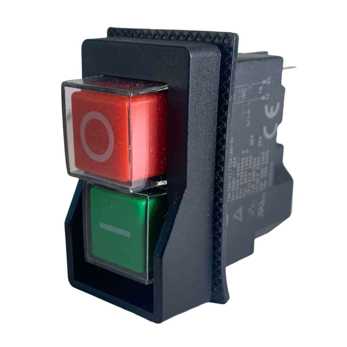

                                #769370
                                Robert Atkinson 2
                                  @robertatkinson2
                                  You can replace the existing panel buttons with an integrated NVR like the KJD17.
                                  KJD17
                                  The FWD/REV switch is just a DPCO rocker switch  This one http://www.ebay.co.uk/itm/133757432545 would do.
                                  #769396
                                  Ex contributor
                                    @mgnbuk
                                    Try Chester Machine Tools – that looks like the same reversing switch / NVR unit fitted as standard to the milling machine power feed I have that came from a Chester open day.
                                    Nigel B.
                                    #769553
                                    Howard Lewis
                                      @howardlewis46836
                                      The Chester Model B is a similar machine, so spares MIGHT be available from there
                                      Howard
                                      #770073
                                      Gary Lynch
                                        @garylynch39491
                                        Howard
                                        Thank you they had the same switch 🙂
                                        Which I have purchased.
                                        Thank you to everyone who answered 🙂
                                        I have also got cable to make a new harness and the motor is working as the run capacitor had ‘blown’ on it, now replaced 🙂
                                        Again thank you to truly a great community with experience that is sadly fading in the real world 🙁
                                        Gary
                                        Now to find a cross screw and slide nut, would make them but I’m a beginner and wouldn’t know how to make a left hand ACME thread or what the size is 🙁
